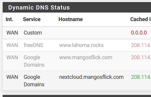

Having a weird issue, i had this container working but i pooch the nextcloud/mariadb a while ago (back in 2015), I finally got Nextcloud/mariadb back online. when i try to get my certs keep failing because its says domain unknown. I am using a google domain and pfsense to do the Dynamic dns and it works just fine, I have my 443 port forwarded.  To test this I set LS Nextcloud as the forwarded 443 and its reachable from the outside world but the container is not working for me.  Is it possibly related to the CF issue mention previously?
Domain: mangosflick.com
Type: unknownHost
Detail: No valid IP addresses found for mangosflick.com
To fix these errors, please make sure that your domain name was
entered correctly and the DNS A record(s) for that domain
contain(s) the right IP address.

/etc/my_init.d/firstrun.sh: line 138: cd: /config/keys: No such file or directory
attached is from my pfsense box, the domain not greyed out is the active DynDNS

I don't quite understand your setup, but based on the error message, it seems you have not set a proper dns record for "mangosflick.com", in other words, your top url, mangosflick.com does not forward to your home server therefore letsencrypt cannot validate ownership.
If you want to keep it that way and have a cert only for the subdomain nextcloud.mangosflick.com, then set the only_subdomains option to true so it won't try and validate the top domain

Update it was not a period that was causing the issue. I got it working, if you visit https://nextcloud.mangosflick.com it will resolved. Reading thru all of the posts i realize that the instructions on creating the container are not very clear, at least for me.
Don't forget to enter in the host ports, e-mail address, the domain url(without any subdomains like www) and the subdomains (just the subdomains, comma separated, no spaces) (under advanced view).
So what i was doing is in Key 2 i would put the TLD (mangosflick.com) and Key 3 my subs (www, nextcloud) this would fail, I did this because of the above mention. Reason for failing was that i did not have a dyndns for just the TLD but i had them for www and nextcloud
I figure this out when i tried using my duckdns for an old subdomain and when it failed it pulled the an old IP because that subdomain is currently not being updated. I bought the domain specifically for this container, I like duckdns but i like to have my domain.
SO.. when i used the full address boom it worked. I suggest maybe putting that in the info or not.
Thanks for all the help aptalca and the other members.
