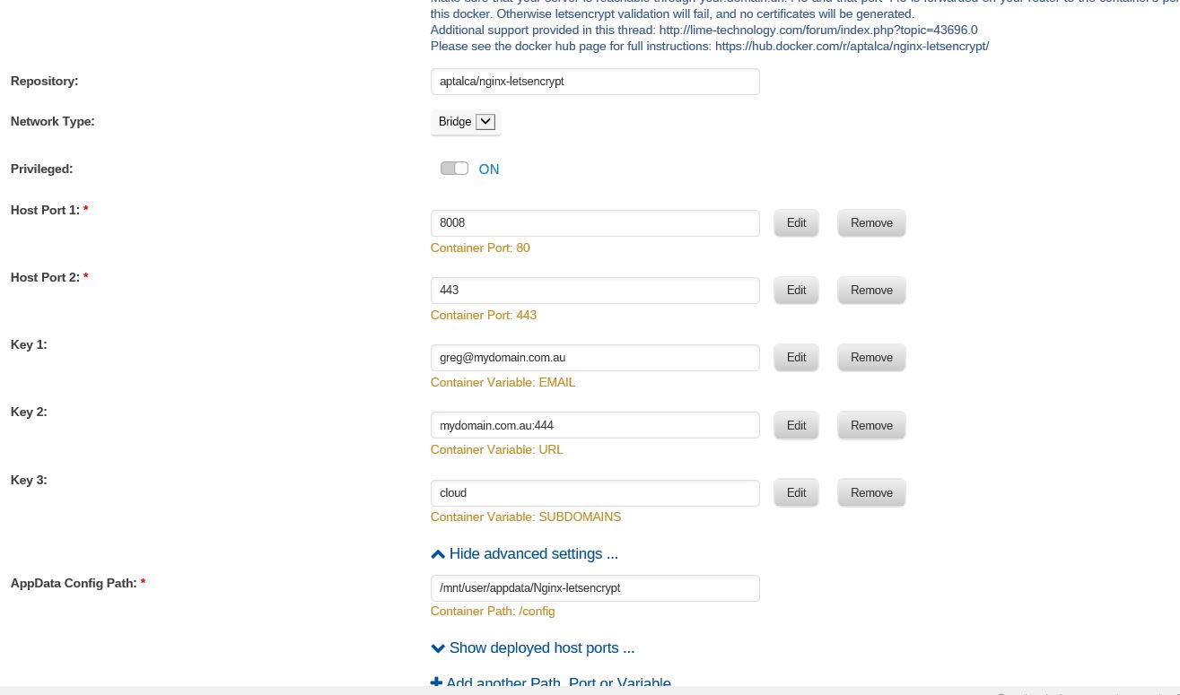

What I am trying to achieve now is to get the letsencrypt docker working with nextcloud.
If I knew what I was doing, it would help.
I am not sure what the syntax of the fields should be in the unraid docker.
Basically I want letsencrypt to create an SSL certificate and point to the nextcloud instance.
I have pasted a screen shot below showing what I think should be there, except it doesn't work.
Can anyone give me a worked example of what I should be entering into these fields?
I have cloud.mydomain.com.au pointing to the unraid server.  The nextcloud is configured to port 444.
Nextcloud works if I goto the internal ip address:444
Just have mydomain.com.au no need for 444 that is a port not part of your url...
