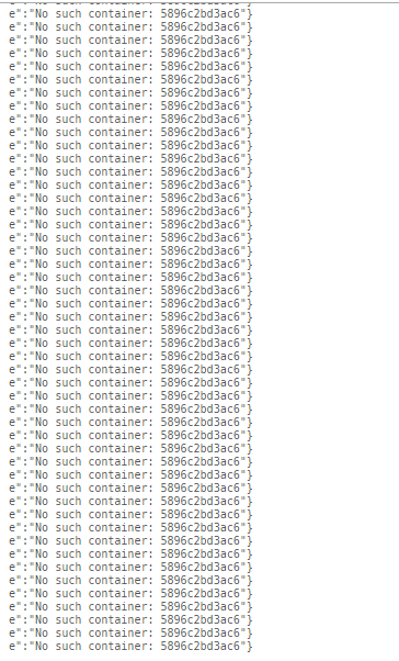

Hello! Im having some trouble getting letsencypt to work. I got so far to the Welcome page, but in the log im getting following error: e":"No such container: 5896c2bd3ac6"}
Anyone have an idea why this is?
Thanks
Thanks
Close that browser window and open a new one.  That error means there's no such container anymore, probably because of an update.
Thanks! Worked like a charm :)
