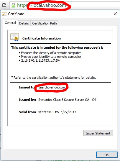

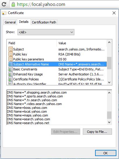

That's fine. All certs are issued to one main address, and can have many alternative addresses. Letsencrypt script must have listed your owncloud subdomain first when it requested the cert from the server, so that became the main "issued to" address.
Attached are screenshots for yahoo's cert. When browsing local.yahoo.com, the cert says it is issued to search.yahoo.com. But when you look at the alternative names, you see both listed, among dozens of others.
As long as all the subdomains are listed, your cert will work on them and you'll get the padlock

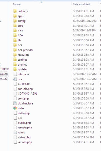

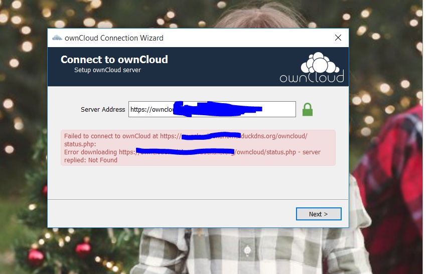

It's working but for me a really strange , i can get to the web portion but when i try to use a client to sync my devices I get an odd error.
see picture,
Status.php is not missing but its not because i can see it. See second picture
this for owncloud
see picture,
this for owncloud
second picture
Cant help you there as I'm not using the sync client, sorry!
