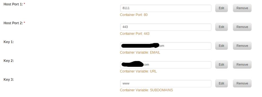

@ Aptalca,  Having and issue starting this docker.  I've read through this entire thread and haven't been able to find any similar issues.  I have TCP 443 forwarded from my WAN interface to unraid IP TCP 443.  I know that forwarding works because if I start the owncloud docker provided by linuxserver.io listening on TCP 443, I can access from an external PC.  Here's the error and screen shot.  Any help is appreciated.  Thanks
"This line is making me think, but I don't see how to register on the LE website.  "You should register before running non-interactively, or provide --agree-tos and --email <email_address> flags"
DH parameters successfully created - 2048 bits
Generating new certificate
/etc/my_init.d/firstrun.sh: line 138: cd: /config/keys: No such file or directory

Hmm. Agree-to's and email should be provided. I'll look into it
Thanks Aptalca,  let me know when I can test of how I can help

Just tested it with a brand new url, brand new e-mail address, new config folder etc. and it worked just fine.
Only thing I can think of is, does your e-mail address contain any weird characters?

I know the issue, just not sure how to correct.  my domain is registered with godaddy which does not support DDNS.  I have created CNAME records on godaddy DNS and pointed my sub domains to my duckdns.org domain. (xyz.duckdns.org).  so...  owncloud.mygodaddydomain.com is aliased to xyz.duckdns.org which resolves to my WAN IP.  This works perfectly for any sub domain of mygodaddydomain.com.  however  the root "@" record for "mygodaddydomain.com" is assigned to godaddy IP.  because of this I cannot authenticate mygodaddydomain.com but I could authenticate owncloud.mygodaddydomain.com.
any Ideas how to get around it?  does anyone know how to use ddns with godaddy?
here's one solution, I just don't want to mess with my google apps subdomain that are registered configured with my domain.

Use the option for subdomains only. It is detailed on the docker hub page
perfect. Ty  I did read it but forgot what I read  ;D
