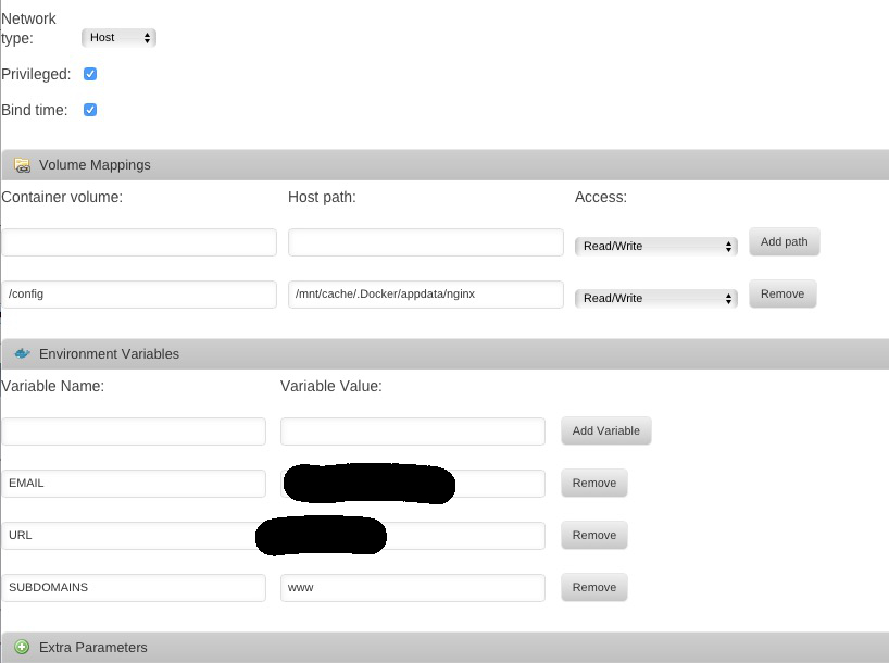

Hello aptalca
I cant get your docker to create, when I press the create button nothing happens at all.
What information can I provide to find the source of the problem?
Hello aptalca
Click on advanced view. And make sure you read the description at the top of that page [emoji6]

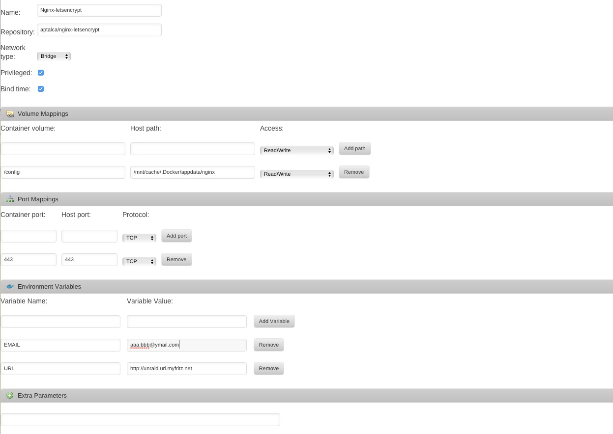

Aptalca, as Bungy's ownCloud isn't supporting HTTPS I thought that by using your docker I could fix my issue: http://lime-technology.com/forum/index.php?topic=38930.msg461212#msg461212.
Is that a correct assumption? If so are these the right steps to install it?
1.) Router: port forwarding from Port 443 to the Port of the respective ownCloud Docker (e.g. 8000)
2.) Install your docker by using Advanced View
3.) Accessing ownCloud by using:
via LAN: https://192.168.178.28:443
via WAN: www.example.url:443
Sorry for the noob questions. Below is my log:

Port 443 has to be mapped to the letsencrypt container for validation and so it can get the certificate. For owncloud, you'll have to set up a reverse proxy (tell nginx to forward all traffic between the owncloud container and the user)
I would recommend reading up on reverse proxy and url prefix.
I never tried owncloud through reverse proxy but I'm using other containers like sab, couch, sonarr, plexwatch, etc. all through the nginx port
I have mapped Port 90 (container port) to Port 90 (host port) and the router is forwarding port 443 to port 80 of my unRAID server IP. That should be correct, no? However I can't even reach the webUI of the letsencrypt container.

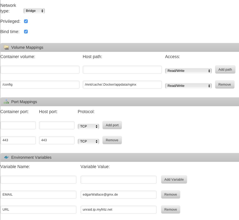

Apologies aptalca, I'm not getting it.
I can reach my server from outside my LAN via
unraid.url.myfritz.net:443
, so according to the guide on github that prerequisite is fulfilled. I have mapped port 80 of unRAID to port 443. Any other entry will not allow me to access unRAID from external.
Additionally I do not understand what to enter under Port Mappings.

Don't map port 80 to 443. you are not trying to reach the unraid gui. Plus, you should never make your unraid web gui accessible from the Internet. It is not secure enough.
You're trying to reach the webserver running inside the container.
So do this: on your router, forward outside port 443 to port 443 at your local server ip. Then in the container settings, map 443 to 443 so an outside request to port 443 gets forwarded all the way to port 443 inside the container.
And make sure not to put http in the url field in container settings [emoji6] it should be just unraid.ip.myfritz.net
Then check the logs to make sure that it was able to generate a certificate
By the way port 443 is the default port for https so when it all works out, you access the new webserver by going to https://unraid.ip.myfritz.net no need to define port number

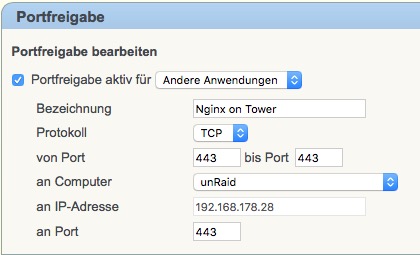

My router might be the issue....your guide is saying: "Make sure that your server is reachable through your.domain.url:443" and mine is not. I do believe that I resolved all issues (see both screen shots) but ca't access the webUI. The router webUI is also using port 443 for external access but I switched this off.
Sorry for being a pain.

@german
stell mal sicher, dass die ip deines unraid servers die 192.168.178.28 ist. Mit anderen Worten, wenn du unter https://192.168.178.28 nginx im lokalen netz erreichst liegt das problem bei der portfreigabe deiner fritzbox. erreichst du unter dieser adresse nginx nicht, dann stimm etwas in deinem unraid (docker) setup nicht
translates roughly to: ensure the ip set in port forwarding is the one your nginx docker listens to locally.
