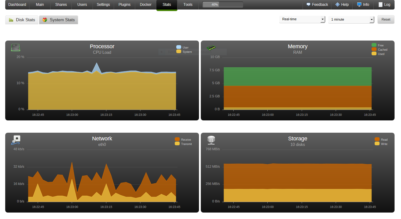

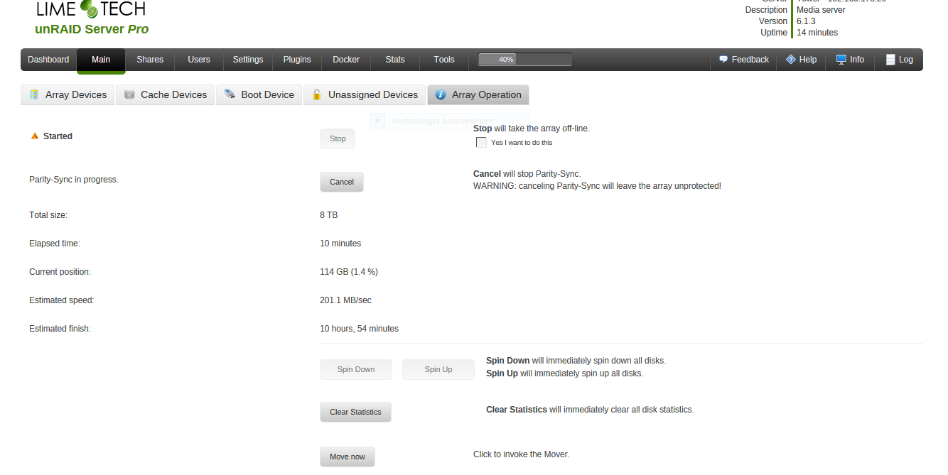

With this out of the way I ordered the thing and low and behold - unRAID  works perfectly with only one cosmetic caveat: I still have to figure out how to control the dot-matrix front panel and leds. Parity sync speed starts out at 200mb/s (3 8tb Seagate SMR drives  and 1 8tb Seagate SMR parity) and at the 50% mark is about 150mb/s. Read access over SMB is at 110mb/s (single gigabit lan - have yet to try link aggregation). I attached some pics to illustrate sync-speed. The e-sata quattro bay docking station works great (which implies that the e-sata ports of the asustor are port multiplier capable) and I love the plug-in "unassigned devices" to access some old ntfs-drives. So far everything is fine.... i will keep you posted....

It always depends what you want to run on the unraid server. For my needs (Fileserver, Sabnzbd - including par2 repairs, Sonarr and Plex) the cpu of the asustor is more than powerful enough. As you can see from the screenshots in the first post, parity sync is working at very high speeds (at low cpu utilization), also par2 repair speeds (multicore version) are very fast. I upgraded the memory of the unit to 8gb (cost me $40), which is also sufficient for my needs. Another plus is the compact dimensions of the unit and the low fan noise. Things might look different if you want to install Win10 in a VM and do high-end gaming.....
