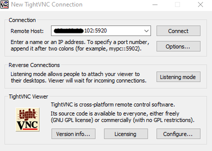

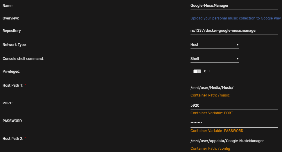

This is how I've got mine setup.  I had to change the default port from 5900 to 5920 as I've got something running on the same port and it caused a conflict.  The Host Path1 should point to the location of your music files that live on your unRaid Array.
The default password is GoogleMusic. So leave it as is or, change it to whatever you want.
The rest of the settings, leave as is.
Once it's pulled the required data and you have the docker up and running, you're going to need a VNC Viewer to connect to the docker.  I am using TightVNC Viewer because it's freeware.  I'm sure there are others out there.
For Remote host, you want the IP address that your unRaid NAS is followed by the port.  If you left the default port it's 5900, if you changed it to some other port, enter it after the IP Address.  After you hit Connect, the password dialogue box will show up.  Enter your password and, if all went well, you should be looking at a Google UI asking you for your Gmail address and password.
