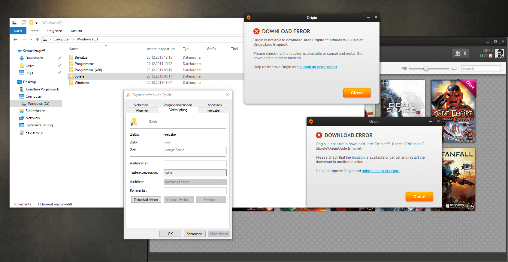

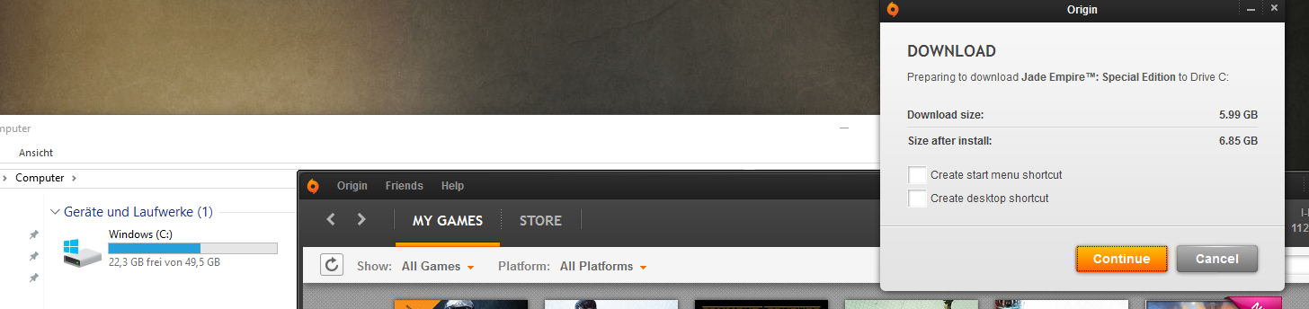

My vdisk has 20 Gb free space left. Installing Jade Empire (a 6 Gb download) fails when installing (see images).
Steam notices that its folder behind the symlink has 2tb free space left. So there seems to be something else producing this error.

There is no image of the error  ;)
Its in the first post because of the img size limitation.

On my origin symlink I have used a location that is also a part of a mapped network drive. I also used the IP and not the name of the server for the symlink.
From the screenshot origin reports the path with both / and \. That is weird.
