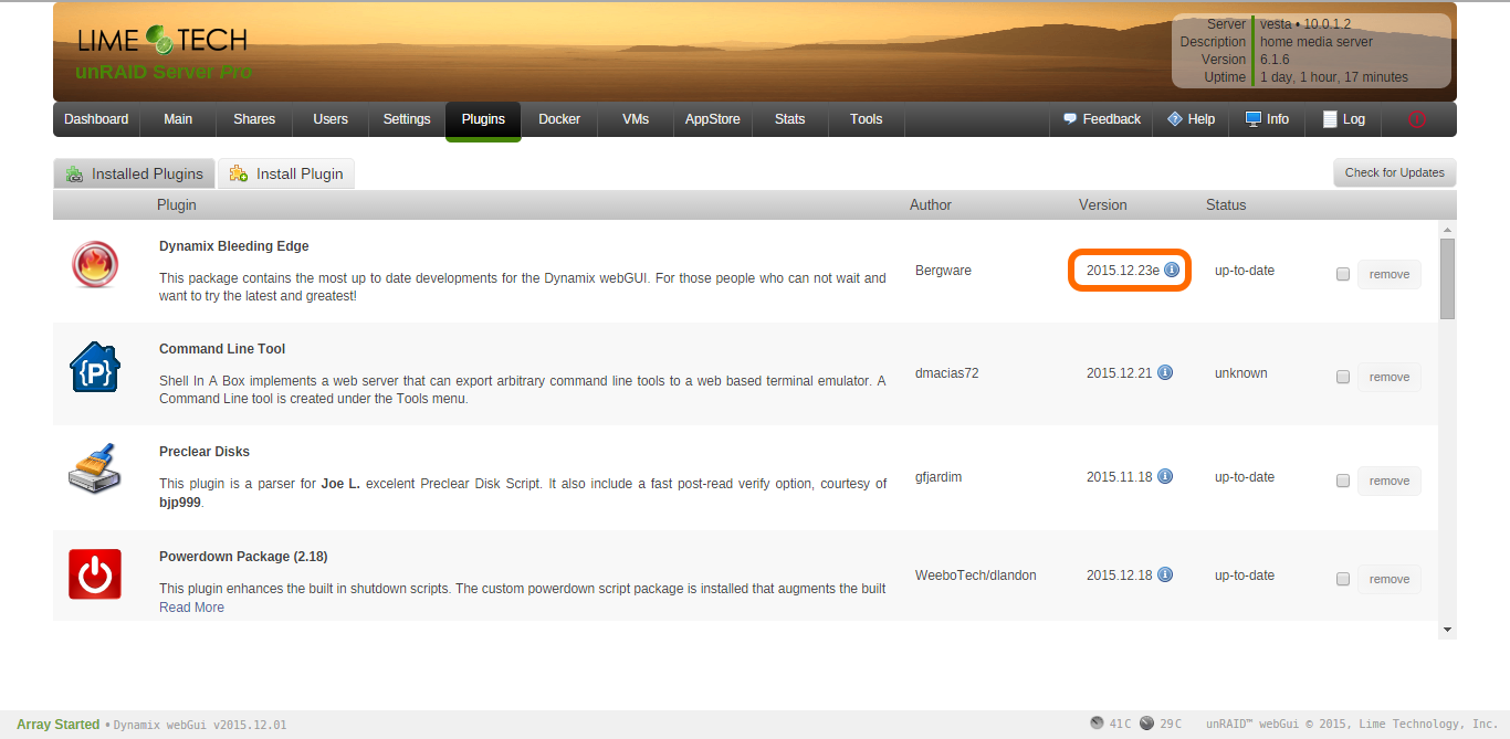

I've made several tests, though I don't have a true 1366x768 monitor, I change my resolution to simulate it. Don't know if that makes a difference.
Below a screenshot of the latest version 2015.12.23e. I use the plugin page as an example since I don't have that many Dockers installed, but they have work the same way (as does the VM page).
In my case the table is properly resized to fit in the screen. I have tested this in Chrome and Edge. Do you use a different browser?
