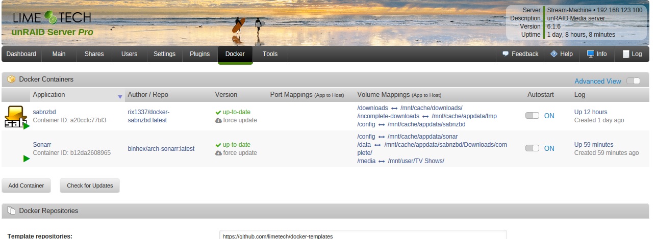

Post your docker volume mappings and a sample screen from sonarr about what your trying to accomplish

Well here's the volume mappings.  Not sure why I'd think about changing download clients though, SABNzbd is doing everything it's supposed to as far as I can tell, downloading to the folder I specify etc.  It's Sonarr that is looking in the wrong place and can't seem to be pointed in the right direction unless you manually import and tell it to look in /data

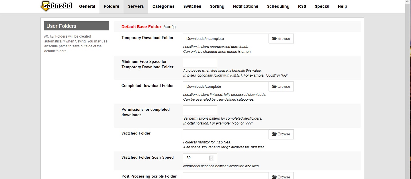

Here's the SABNzbd folder settings.
When I click on the browse tab it shows me the downloaded files
#1 - Within SAB, you are telling it to store its downloads within Downloads/complete  Note that it states that the default base folder is /config.  Downloads/complete is a relative folder which means that its going to wind up storing the downloads within /config/Downloads/complete  (which is actually /mnt/cache/appdata/sabnzbd/Downloads/complete).  You want to tell Sab to store the completed downloads to /downloads/complete
#2 - Sonarr has /data mapped to /mnt/cache/appdata/sabnzbd/Downloads/complete.  This is indeed where the downloads are stored.  BUT, when sab finishes a download, it tells Sonarr that the file is stored in /config/Downloads/complete (which maps out to /mnt/cache/appdata/sonar/Downloads/complete)  For containers to be able to talk to each other, the host and volume paths must be the exact same on each container  (except for /config paths)
Solution:
Add to sonarr another mapping of /downloads to /mnt/cache/downloads  and set sab to download to /downloads  Also note that linux is case sensitive on paths
