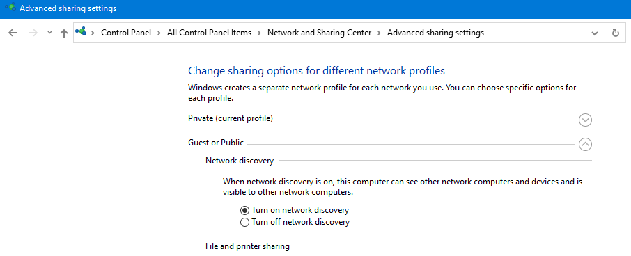

You can also try to access the server with the IP address by entering it in address bar of Windows Explorer as   \\192.168.1.252
Also make sure that these are turned on:
and this:
