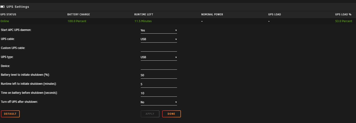

September 2, 20206 yr I have a SUA2200RM2U connected via the RJ45 > USB cable. I have the same issues reported above with all stats showing except for nominal power and UPS load. From what I've read in this topic, nominal power is a set value based on the capacity of the UPS. So for my SUA2200RM2U, this value should be 1980 Watts. Is there a way we can manually specify this value somewhere or would that require a fundamental change in how APCUPSD works since it expects this value to be reported by the UPS?
February 7, 20224 yr I would be great if the plugin allowed us to input override values for non-reported info such as nominal power. override 700 Watts and 120V.. and use that to calculate UPS load if not reported from UPS. All the values needed to make fill in the gaps are there once you give it Unit Wattage, and supply voltage. Please just let us input a value!!!! Edited February 7, 20224 yr by TRusselo
