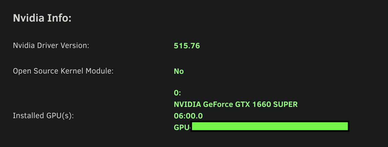

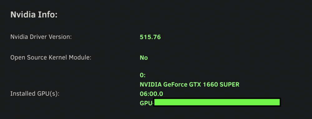

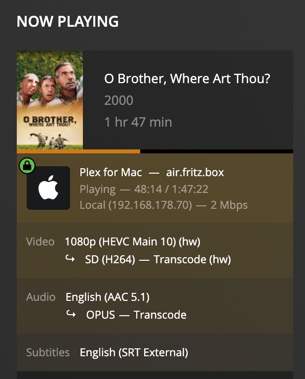

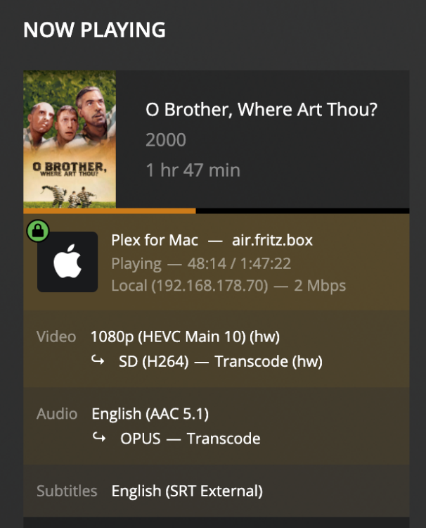

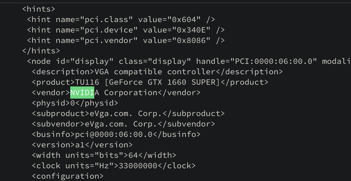

October 12, 20224 yr I got it booting with the 1660 Super Installed! It's not the most elegant solution... I will install the drivers and see if I can get Plex transcoding working. If it works out, I will post here my solution.
