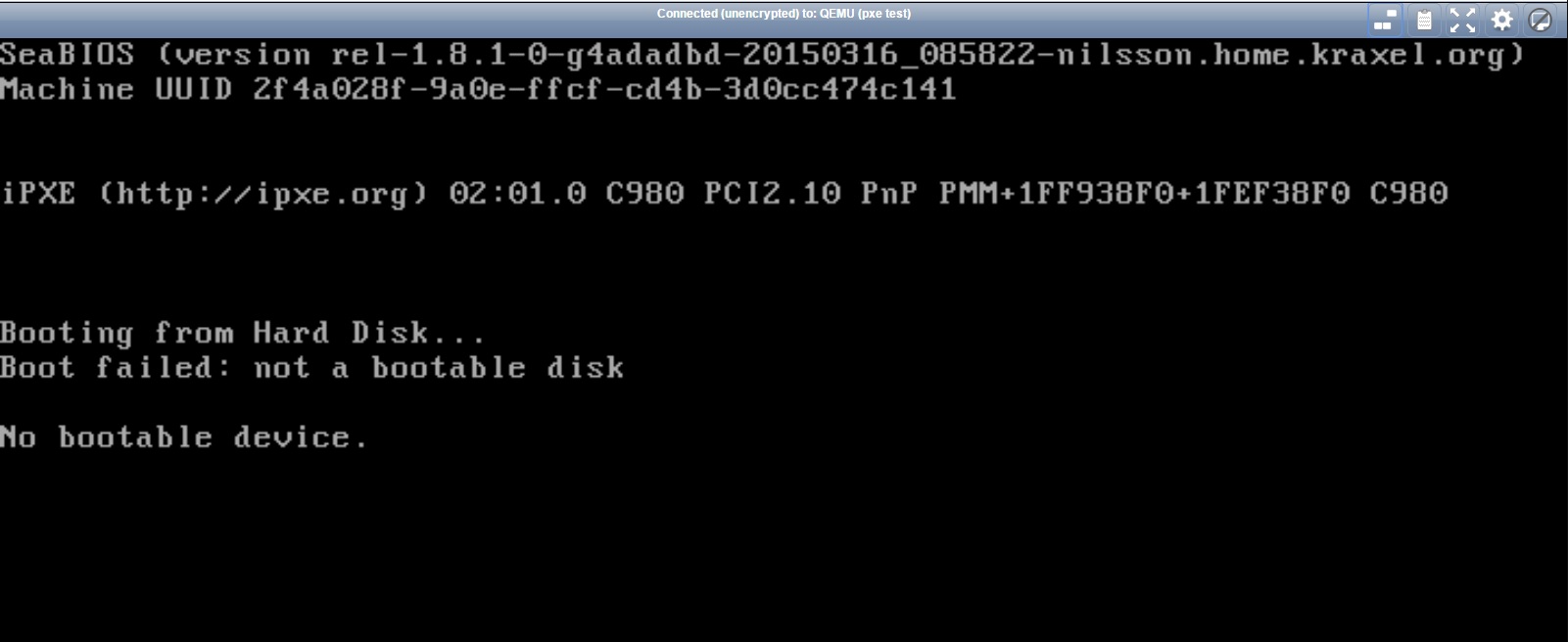

Ok i don't know if this has been answered or not but haven't had any luck searching.
I have a PXE server setup on the network. if i boot the physical machine it will pxe boot. but when i create a VM and try to get it to do the same it will not. i have the bridge reconfigured so that VM's pull an ip from the network not from unraid.
i assume this is something super simple but i can't figure it out.
below is the XML for my basic test vm.

Thanks in advance for any help and suggestions

Two things...You need to add the NIC to the boot order:
    <interface type='bridge'>
      <mac address='52:54:00:d9:d5:39'/>
      <source bridge='br0'/>
      <model type='virtio'/>
      <boot order='1'/>
    </interface>
If it still fails, you may also need to specify a different NIC driver other than virtio (i.e. e1000):
      <model type='e1000'/>
      <boot order='1'/>
    </interface>

This worked for me as well but another change I needed to make was using SeaBIOS becuase I was getting the shell terminal on Boot.
I used this with the docker network.xyz container.
You can also boot from a Network Controller being passed in just by adding <boot order='2'/>
For my use I removed the bridge interface and used a passed in LAN card.
Thanks
I have the same issue, i have to use seabios as with OVMF I get pxe-e09 could not allocate i/o buffers errors.
