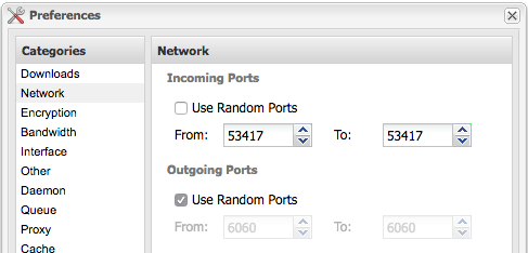

ok so as an example, ive attached my deluge preferences at this time, if you look at the picture then you will see ive unticked use random ports (incoming section) and set my port from 53417 to 53417, so its a single incoming port, THIS is the port you need to define on your router, go for both TCP and UDP. For the outgoing port just leave the "use random ports" option ticked, you do NOT need to define this on the router, unless you have locked down outgoing ports (highly unlikely).
just to be clear, this is an example, you can use any port you want, the default port is 58846, so you can use that.

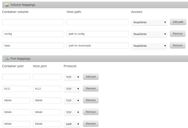

Still no luck. Here is my config:
wrong port on your router, you defined it as 58845 on the router and 58846 in deluge, change your router setting.
Its mapped from 58846 in container to 58845 in the host so I believe it is right, no? (see my UNRAID docker setup in screenshot)
ok that should work in that case, have you tried restarting deluge after setting all this up?, what are you using as an indicator that port forwarding isnt working?
