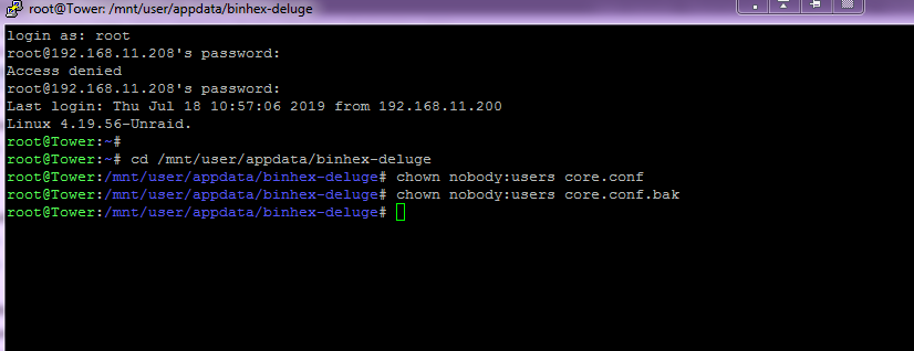

Sorry, thanks for your help with this but I'm going to need further direction. I have done that and I'm still unable to make any changes to, or delete, either the core.conf or the core.conf.bak files. I'm new to linux so this is all a bit bewildering to me. Have I got this right?
yep thats exactly right, ok lets change mode too:-
chmod +rw <path to files>
then try the delete/modify
