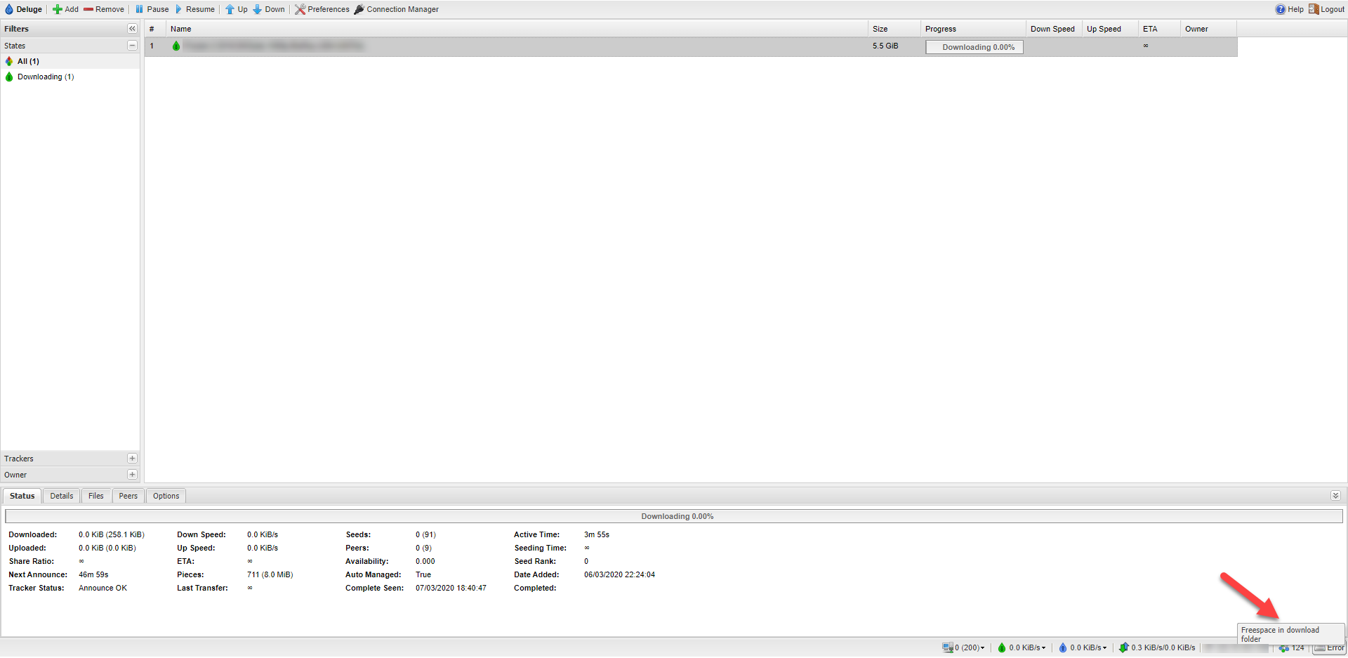

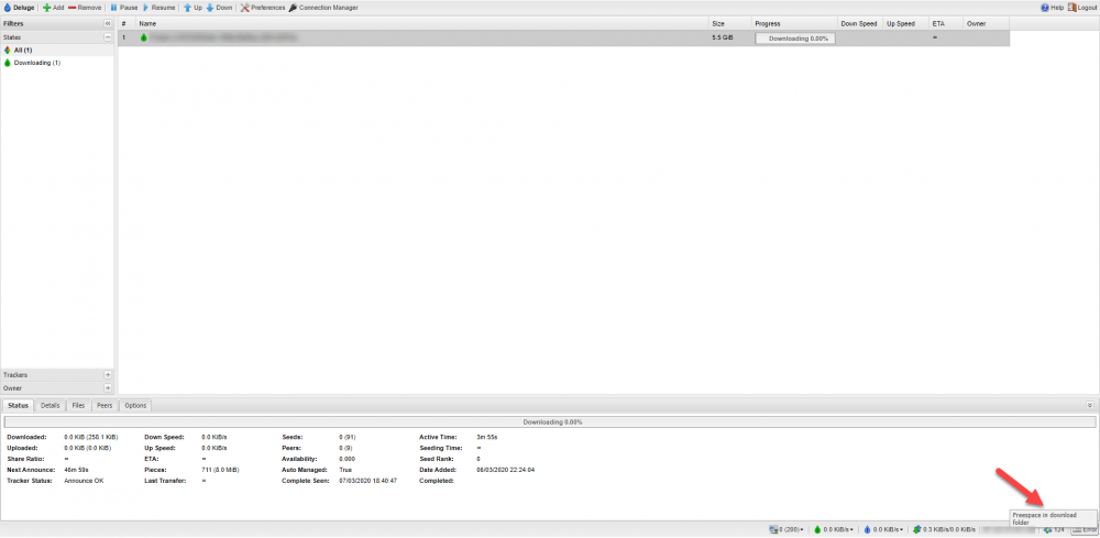

Hello unraid people.

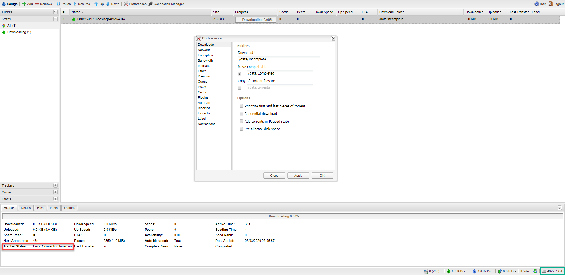

Whenever I'm starting to download through Deluge WebUI, it starts at 1 Mbit/s or something, until it turns down to nothing at all.
I've attached a screenshot of it , where it says "Freespace in download folder" (marked with a red arrow).
It's set to download in a folder called "Download/Incomplete" just like Spaceinvader One did it.
I've downloaded 0 byte of anything so far, so I don't know why it says there's no free space.
Can you help me out?
Sounds like you almost had it exact, but not quite. Folder names are case sensitive, so make sure your container path in the docker settings and the path inside the application are precisely the same.

I have typed it exactly the same way, with capital D and I.
I'm not sure about the second part.
I can show you some screenshots of the paths of both Deluge and the share?
The share is not particularly relevant, the container mapping is the critical part.

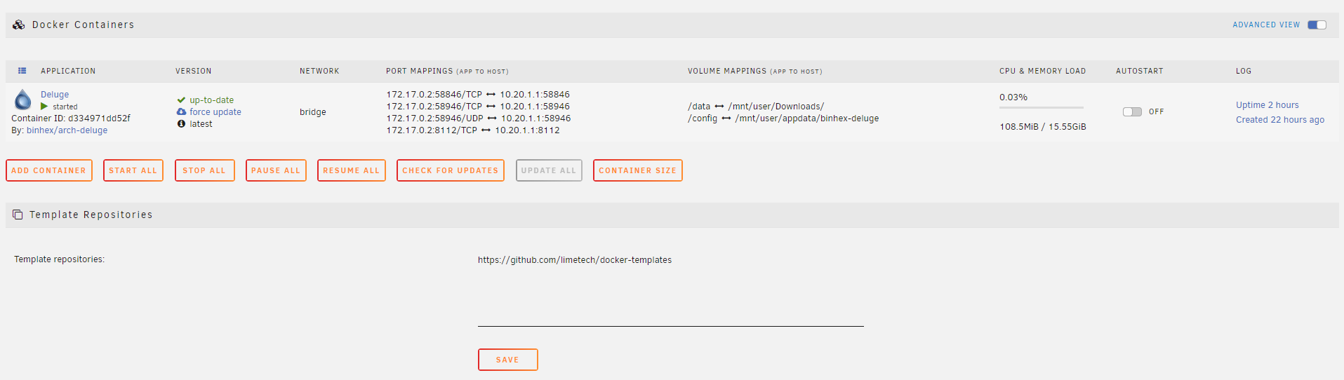

I'm really new and unexperience at unraid.
How do I check that?
Is it this?
34 minutes ago, Nanobug said:
Is it this?

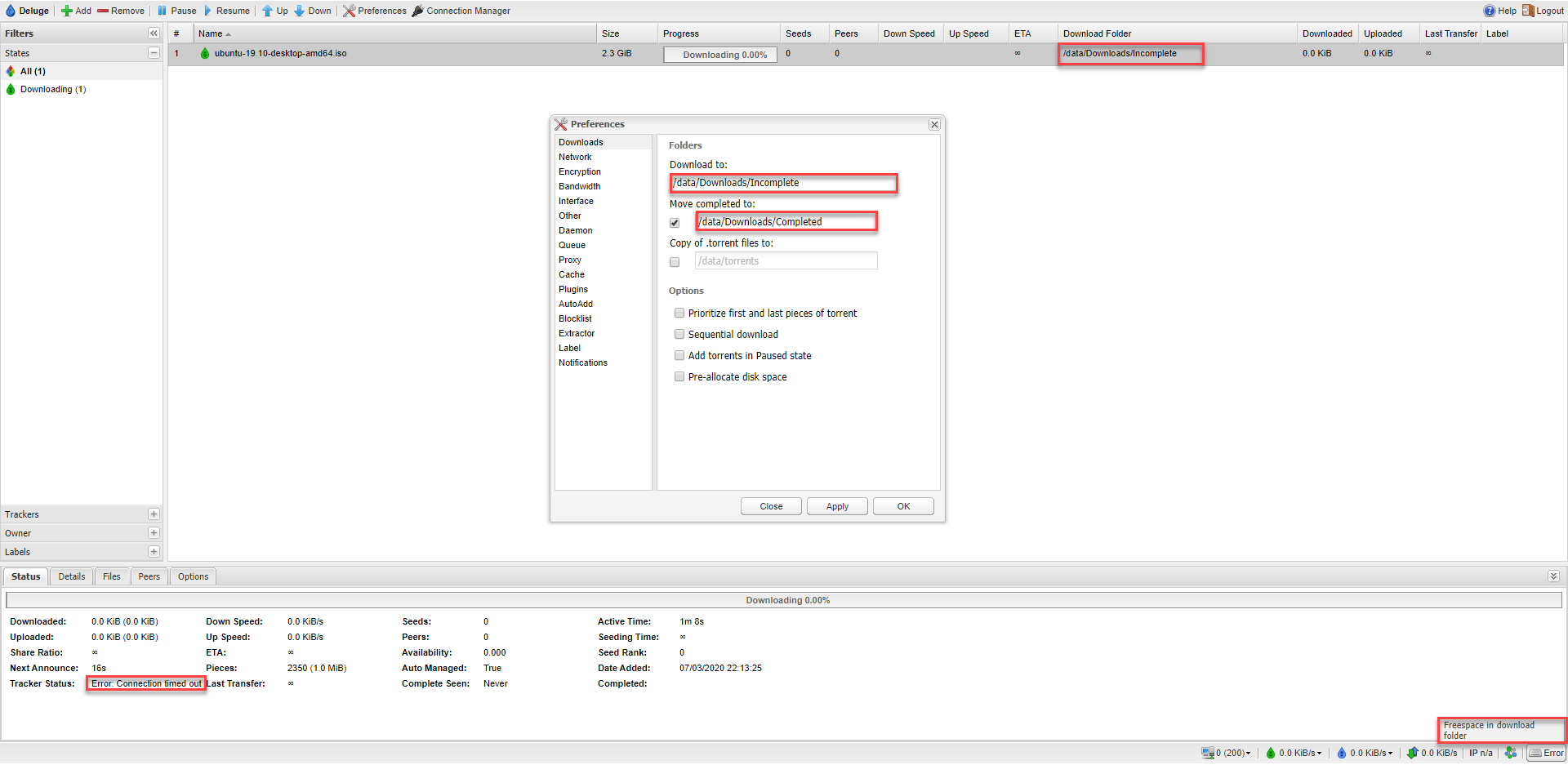

According to that screenshot, you should be telling deluge to save to /data, because that is what you have mapped to /mnt/user/Downloads
Mother of.... Was it that simple?!
I feel stupid now.
Big thanks though.
I did only download 2.39%.
Then it says "Error: Connection times out".
If I recheck and update the tracker, it goes straight into the error in tracker status.

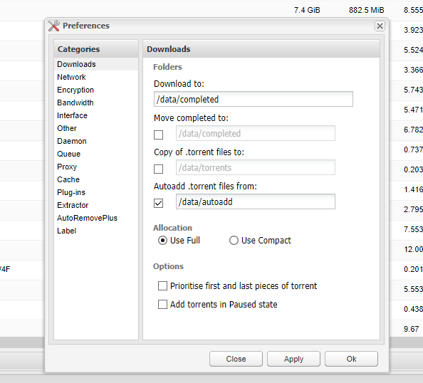

from deluge, under downloads if you put /data/downloads the that will map to /mnt/user/Downloads/  and i recommend to use same port instead of random and port-forward in your router
Edited by Danuel

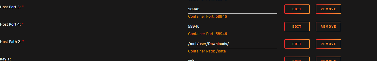

This is what I have right now:

well in my case i made a specific folder just for deluge for downloads
so when i install deluge host path is /mnt/user/Downloads/ that pot to that shared folder (i saw from you screenshot that, that i set ok)
and like i said in deluge to set to that download folder you fill /data/Downloads (of if you add another folder inside Download like completed you map /data/completed)

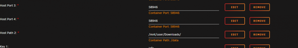

have you created a incomplete and completed folder inside Download folder  ?
that is wrong mapped, i can see from your disk in deluge that you have ERROR as a space, meaning you have no Downloads folder created
Edited by Danuel

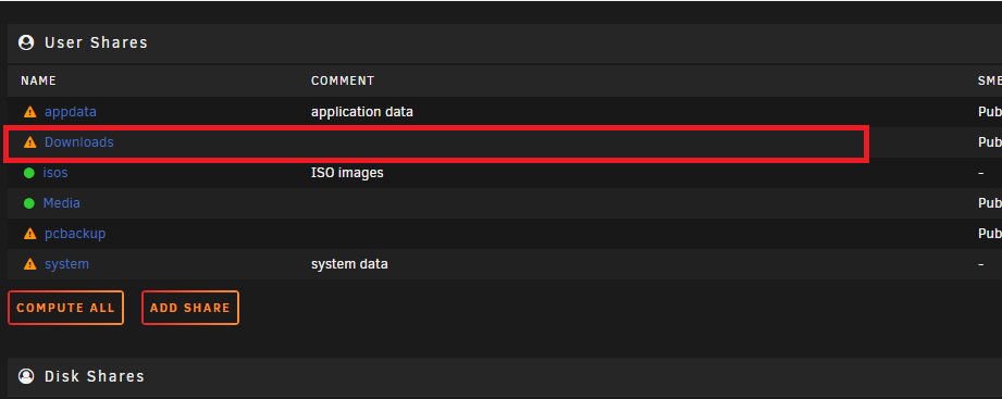

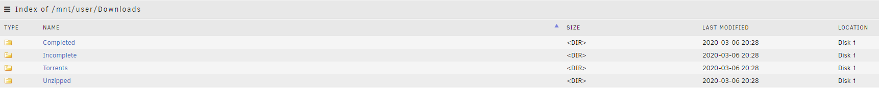

This is my "Downloads" and its 4 subfolders:
Now Deluge mentions no error in the bottom right, but still gives the error in tracker status. I've removed the torrent, rebooted the docker, and added the torrent again before it gave this error.
