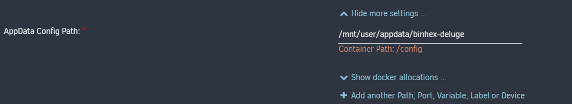

The config is pointing to the right parth - image.thumb.png.2743d3c948831cd8b1b84bafc5f652aa.png
Ok and I assume none of your missing data is found in that path is this correct? If this is the case then I can only assume file system corruption of some manner if you have a backup of your app data then I would suggest a restore.

    I must be missing something. I have the docker installed and running, the config looks to be fine, but the port for the webgui does not seem to be open. Not port forwarding, just to access it locally.

All data is in that path. I downloaded your delugeVPN version, and everything is working. Something is up with the none VPN Binhex Deluge version that was recently updated. Like i mentioned even trying to add paths in preferences and clicking apply and ok nothing happens. Happy to take a video for you if you like.

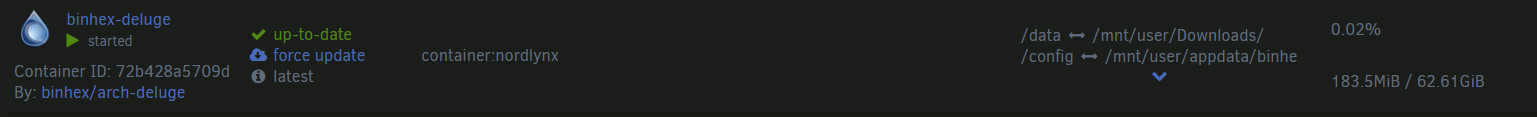

I've actually had the same issue, recently got everything working with the nordlynx docker, added deluge port to nordlynx and was able to connect to deluge just fine. Now when I try, the page just doesn't load. I also get the same output in my deluge log.
I also notice in deluge row in docker, there are no ports, where there were before. Switching the docker back to the normal network fixes it and I'm able to connecto the UI just fine. I've been using deluge for a while now without the VPN and only very recently decided to buy a subscription to one, I've got in progress torrents that I don't want to lose by making the switch to DelugeVPN.
Any help/suggestions is appreciated!
Thanks, - Myles

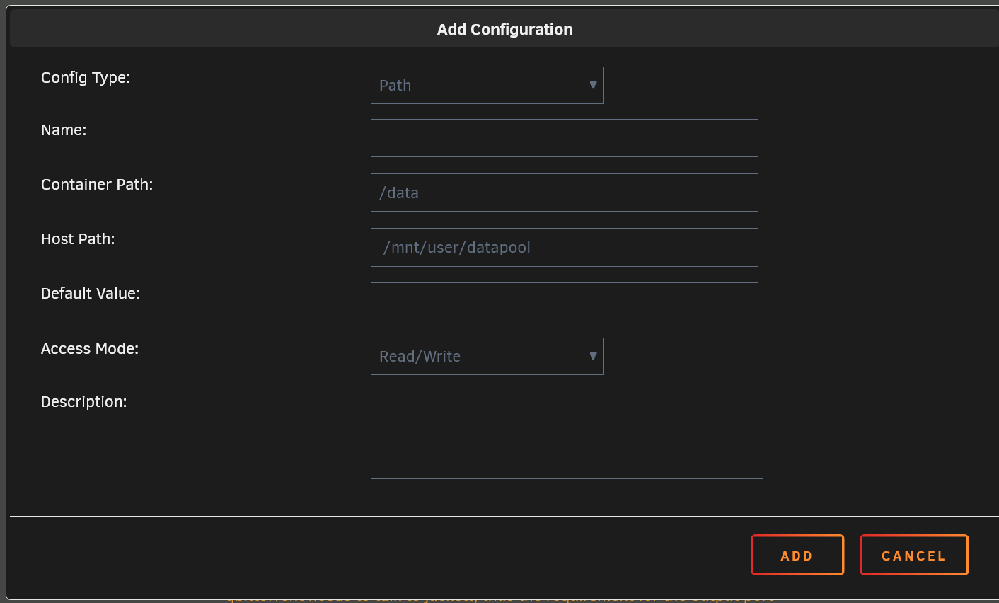

I have what I hope is a simple issue. I want to set the complete/incomplete and watch folder to something other than the default path /mnt/user/appdata/data.
I have different share to use like /mnt/user/datapool/watch etc
but deluge keeps telling the path doesn't exist (or any variation). Not sure what I'm missing or need to tweak for deluge to see the other share Outsite appdata?
Otherwise working great!
Thanks
You will need to add a mapping with host side having the Unraid path, and the container side set to whatever folder you want to point deluge to. Docker containers can only access mapped paths, they have no way to get out of their own sandbox otherwise.

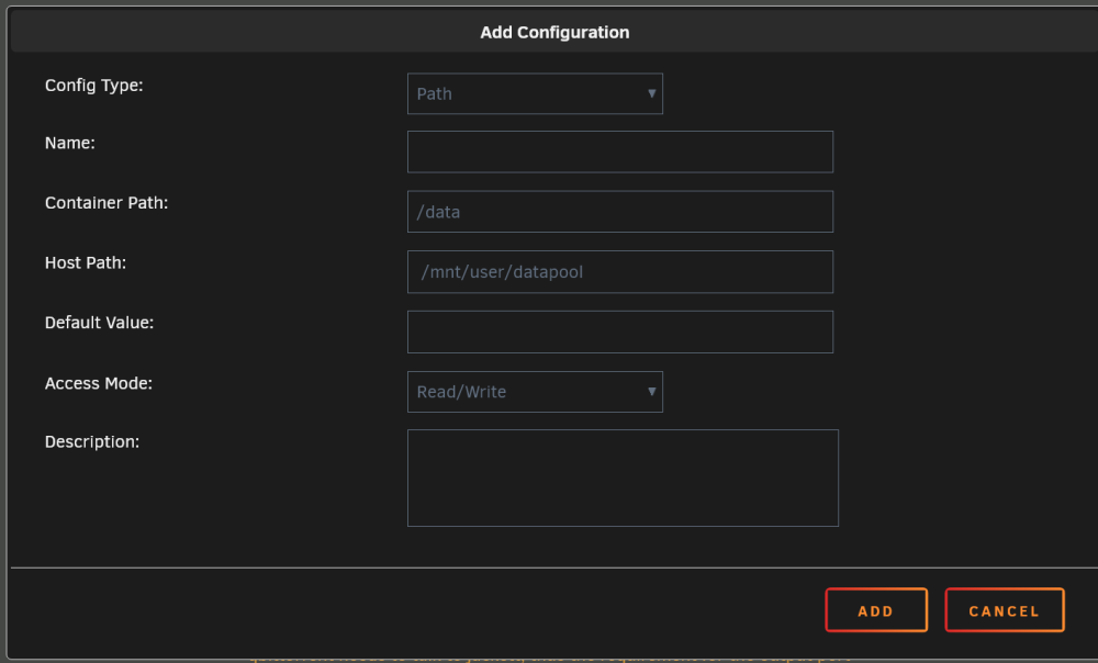

Thanks
I reset and tried again with a new share 'download'. I set the deluge Container Path: /data/mnt/users/downlaod but I get the same no such path complaint from autoadd module for setting a watch folder, not such path... and torrents do not seem to be creating data in download complete/incomplete folders as set in deluge config. Mmm test torrent is not writing data to the directories.
Edited by Bushibot
24 minutes ago, Bushibot said:
I reset and tired again with a new share 'download'. I set the deluge Container Path: /data/mnt/users/downlaod but I get the same no such path complaint from autoadd module for setting a watch folder, not such path... and torrents do not seem to be creating data in download complete/incomplete folders as set in deluge config.
https://forums.unraid.net/topic/57181-docker-faq/#comment-564306

5 hours ago, Bushibot said:
Wow that is kind of confusing but a little more digging on my end suggests this is actually PIA vpn issue. Maybe port forward?
downloading to specific paths on your host has nothing whatsoever to do with the vpn provider or port forwarding, you simply do not yet grasp how docker bind mounts work.
firstly you need to create a new 'path' for the container or edit the existing path, e.g.:-
once this is done then wait for deluge web ui to be accessible and then configure deluge, for example assuming a host path of ' /mnt/user/datapool/watch' you would configure deluge watch to be '/data/watch' that is because ' /mnt/user/datapool' = '/data' thus the subfolder watch = '/data' + '/watch' you get it?.
