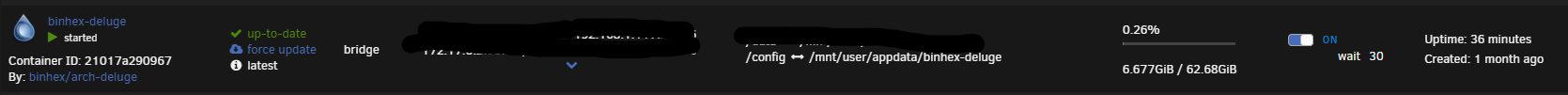

    I must be missing something. I have the docker installed and running, the config looks to be fine, but the port for the webgui does not seem to be open. Not port forwarding, just to access it locally.

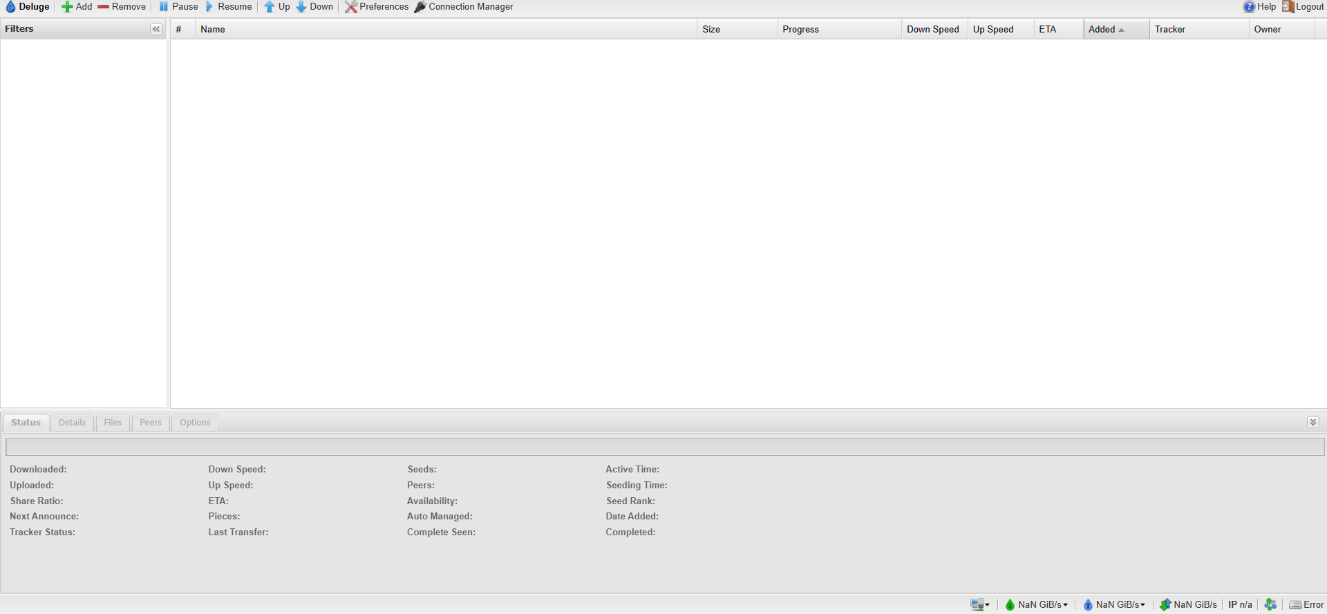

I could not log into the webui after the latest update to 2.1.1-1-02 of Deluge.  I had to roll back to 2.1.1-1.01 to get the docker to work again.
I have installed it, the file is in the plugins directory. When I click the checkbox it check it but nothing appears in the left window with all the other plug ins.... any suggestions?
Yep, I can confirm this too, webUI borked. I went back to 2.0.5-1-03 and it's ok.  @binhex
no bork for me, just pulled down latest and web ui is accessible, this is with a blank config, are you using deluge or delugevpn - this support thread is for the non vpn version btw.
I am using the non-VPN variant.
I shifted back from binhex/arch-deluge:2.0.5-1-03 to binhex/arch-deluge and the problem persists (web-ui won't load). Log for interest

My binhex-deluge just updated now all of my seeding torrents are missing? My paths set also completely disappeared from within deluge and when I enter them they do not save?
I noticed the plugins i had earlier are gone too? what the hell happen? What is the solution to fix this and get everything back?
Edited by z0ki
Anyone? Its been working fine for years, nothing was changed at all. Why is this happening?

Not sure why updating to the latest update broke this in deluge? Paths are the same as it was before the latest update on the 4th (if memory serves me correct?)
In preferences even adding the directory clicking apply does nothing. As in once I input a path clicking apply than ok. Then opening preferences again the paths I put are empty. Deluge VPN with the same shares works fine after testing it. I think there is an issue with this specific version?
I'm happy to give you any information needed to try and get this sorted mate :)

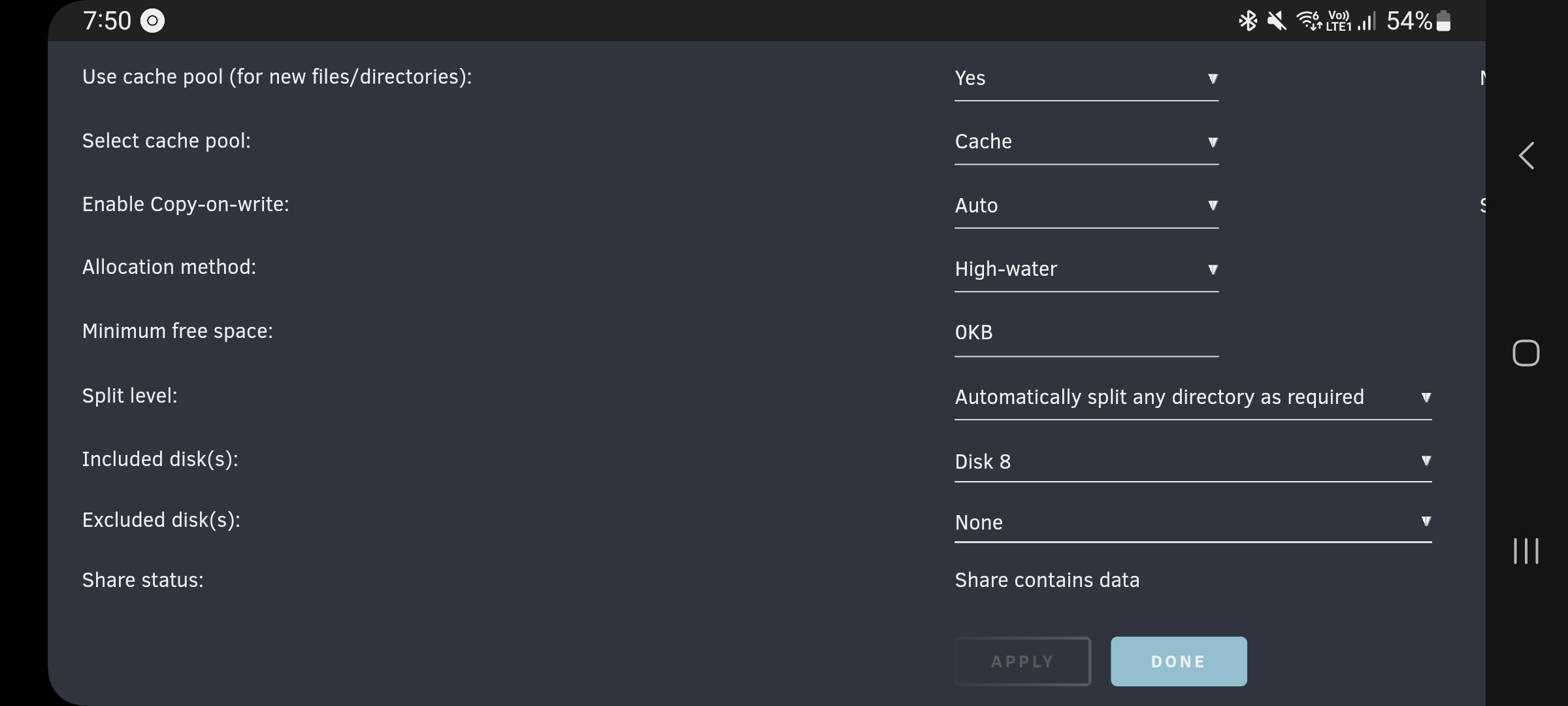

Only my downloads share is Yes:Cache then when downloads are done it gets moved to DISK 8.
Appdata and system are set to Cache Only
this is what i was referring to, ok that sounds fine, next thing to check is that the path set for /config is set to the location of your  config files on the host, perhaps for some reason this got reset, data corruption or pebkac perhaps:-
left click icon and select edit, scroll down to show more settings and confirm the host path for /config is set to the location you store your config files in e.g. /mnt/cache/appdata/delugevpn/ if its set wrong then correct and apply.
