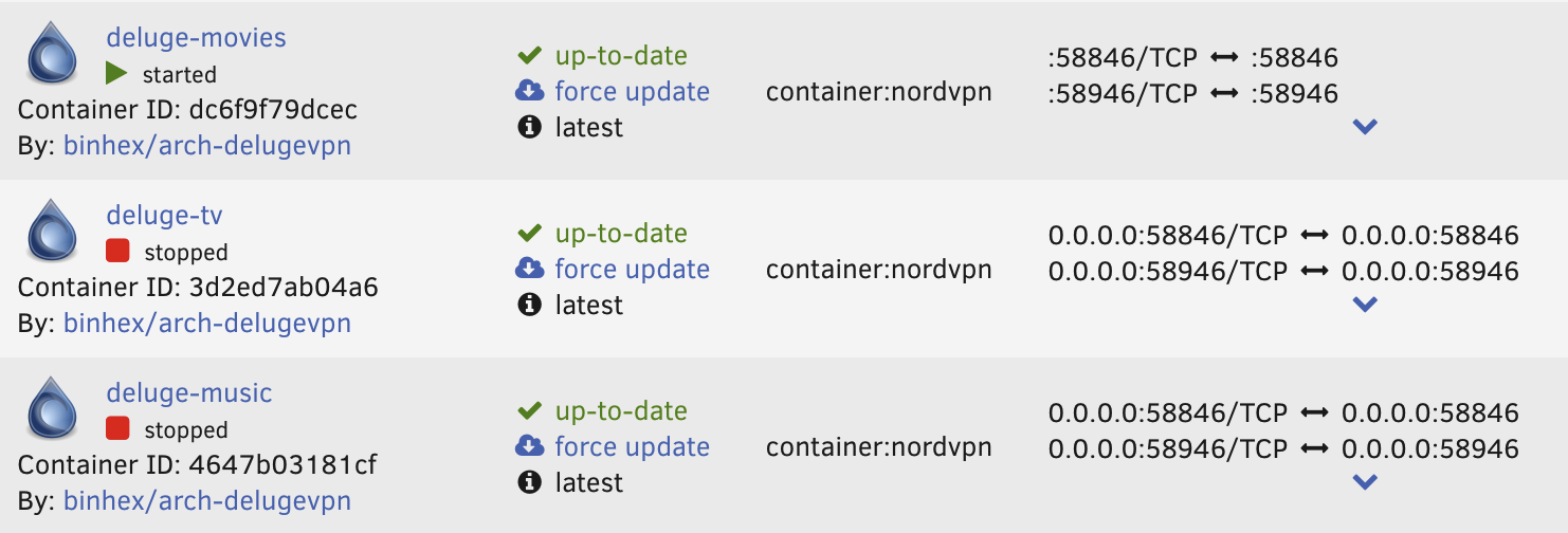

@binhex I've got a question I can't seem to find an answer for.
Long story short, I have to use a dedicated IP VPN.
I'm moving from your delugeVPN to just deluge containers and routing those deluge containers through a single VPN container.
Example:
https://unraid-guides.com/2021/05/19/how-to-route-any-docker-container-on-unraid-through-a-vpn/
This works fine, the problem is that I currently run 3x separate instances of deluge ( Movies / Music / TV)
381160448_CleanShot2022-03-23at16_51.53@2x.thumb.png.a06547e4e269f25f4f52ac1f82d0e22c.png
I can get the Deluge containers to work one at a time, but not all 3x at once because they're all trying to use the same ports.
In the docker templates, I have them all as different ports 58846, 58847, 58849
But docker templates are ignored when the connection is through another container
And no matter how I try to define custom ports, these default ports are always defined.... somewhere.
I've tried:
  • Changing the ports in the deluge config template, they are ignored and set to the defaults
  • Changing the ports in the deluge client settings, they are ignored, the defaults are still set in the container and it doesn't work
  • Changing the ports in the deluge client config files, the defaults are still set in the container and it doesn't work
No matter what, these defaults are the only thing that works no matter how I try to configure it.
Where / How can I change these? Any ideas?
