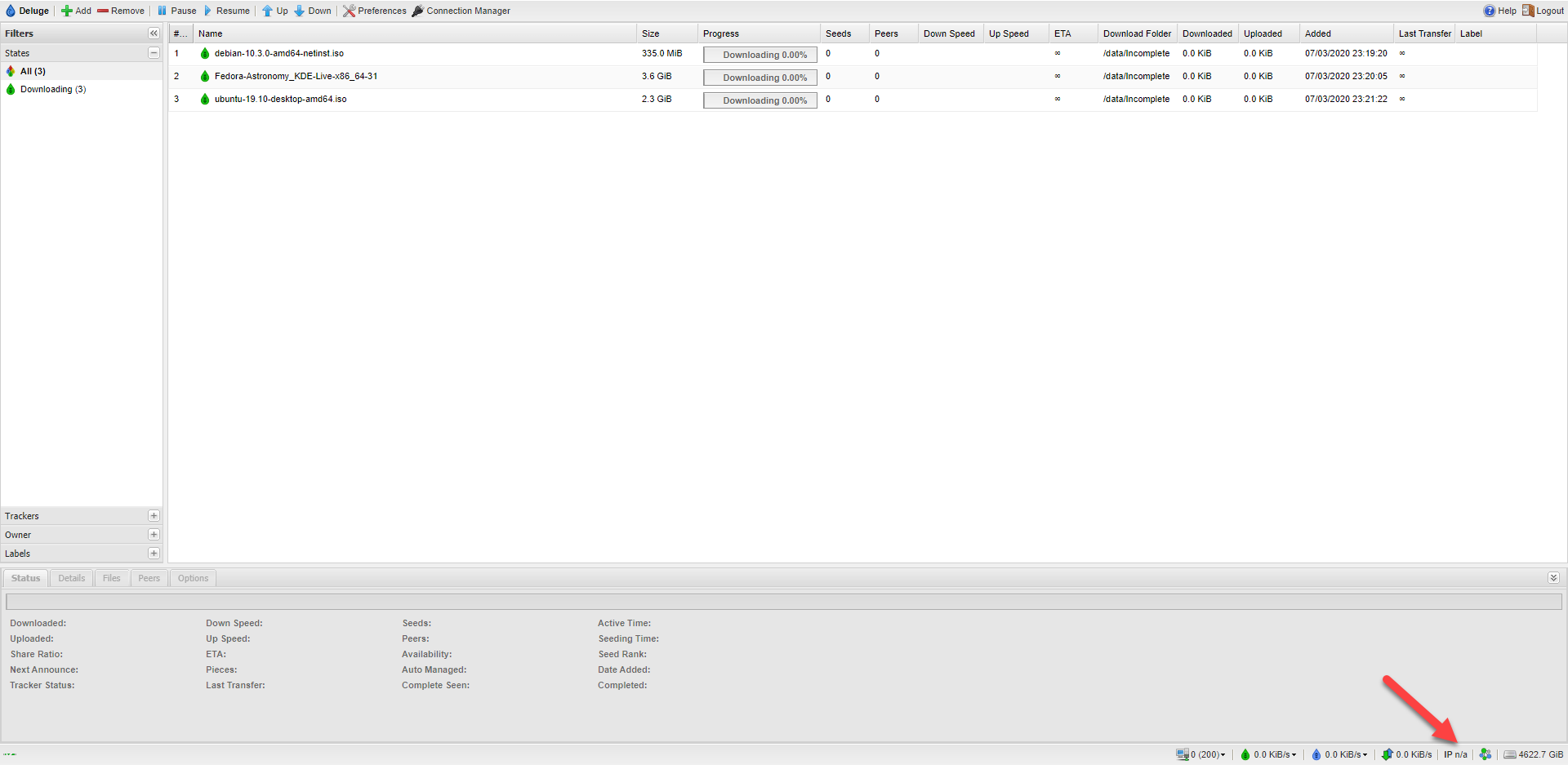

4 minutes ago, Danuel said:
Maybe the source is broken
Tried 2 other Linux distros, and downloading the ubuntu torrent and adding it again.
It doesn't show my IP in the bottom now, it did that before. Is that normal?

1 minute ago, Danuel said:
Sorry, i can’t confirm if that is normal or not, i still use a older version of deluge
Sent from my phone using Tapatalk
Alright.
Let me know if you can think of something :)
Thanks for trying to help anyway.
When I booted up unraid today, it did start downloading ubuntu, so I tried adding the fedora and debian torrent to Deluge again, and it's being a jerk to me now.
It does get the IP now, where it said n/a before.
It adds the torrent in paused now, and I can't resume them.
Any ideas?
Any ideas?
maybe when you manually added you check added in pause state, if you press resume is not working ?
try to refresh the page after you press resume
Edited by Danuel
My DNS is for some reason messed up again. I think that might be the case right now.
I don't know why it happens "Fix Common Problems" detected it.
I guess I'll have to fix that first.
The DNS problem disappears when I restart the server, but the torrent issue persists.
Just to try it out, I installed Deluge on my Windows 10 Pro, and it works right away.
The use the same network configuration, except the unraid server has a static IP, and my Windows PC has a DHCP IP.
My router was messed up, so I had a friend drop off a router, and everything works now.
Thank you for trying to help, it's really appreciated.
