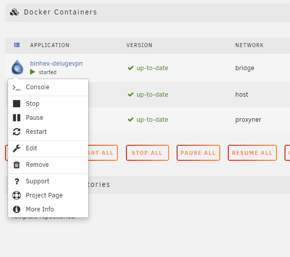

Make sure your network for the deluge container is set to bridge. If it is set to none then you won't see a webUI
Sorry, just saw that is was set to bridge from the image
