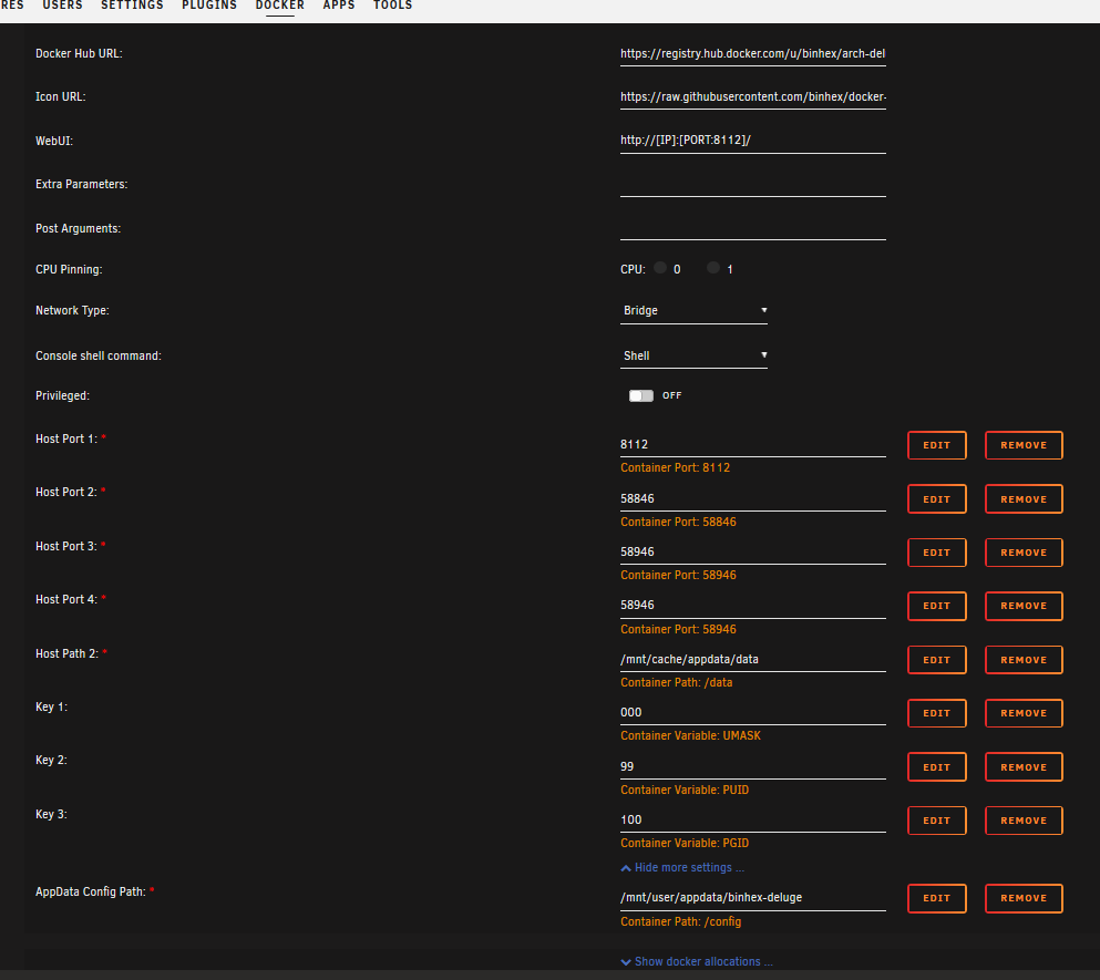

left click icon for this app in unraid web ui, select edit, scroll down and change the value for DEBUG to true
Yes, that's where I looked but I don't have that value - there is no DEBUG field. Sorry for being a pain on this...

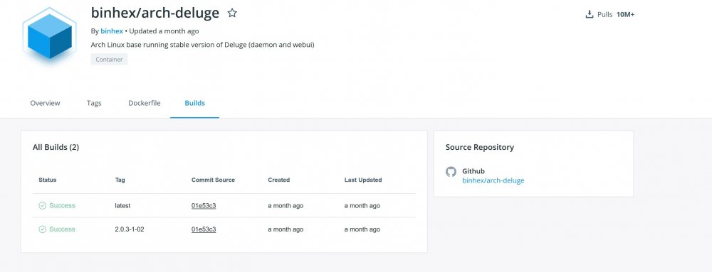

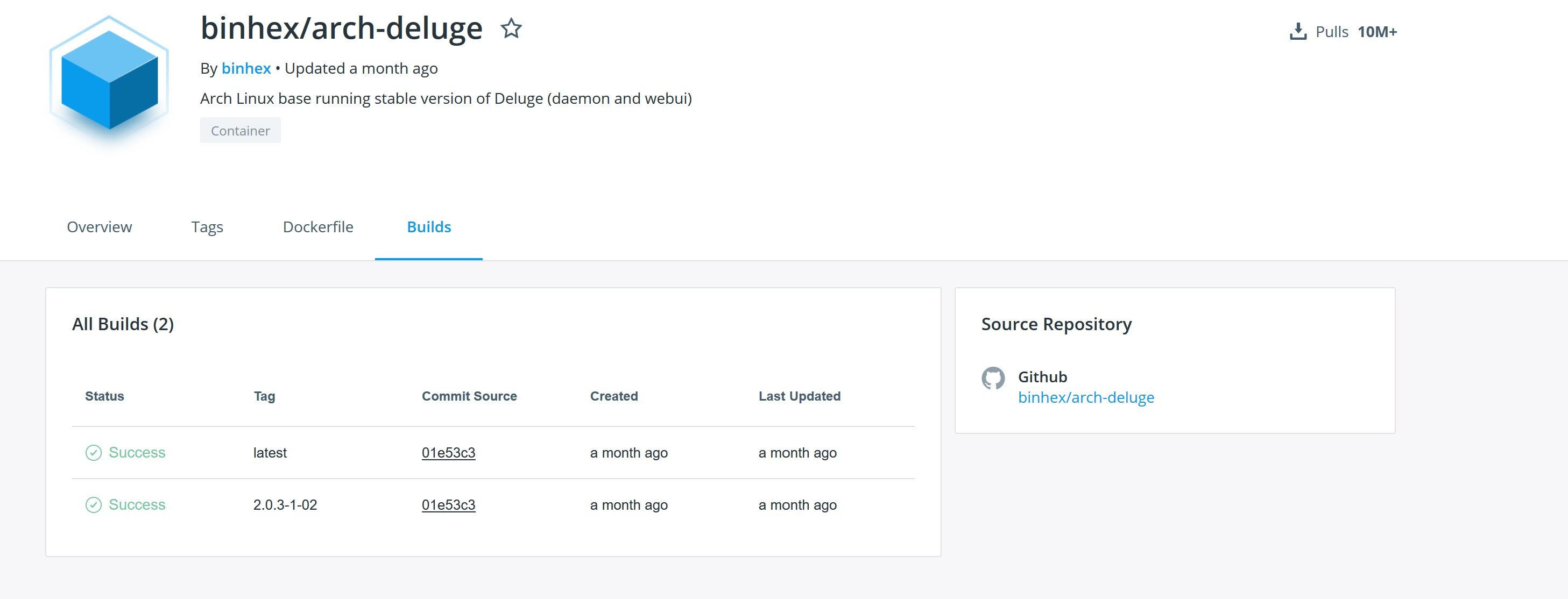

14 minutes ago, Timbiotic said:
Right and when i go to builds as it says in the instructions there isnt anything below 2.0 so how do i tag 1.3.15_18 if there are no builds for it?
ahh sorry looks like the views have changed, try the 'Tags' tab instead to view all available tagged images, then follow the rest of the instructions in the linked faq.
After a fresh unraid install, and adding the Deluge app, setting it up with shared folder "downloads" on install, it says "/home/nobody/downloads" in the Deluge settings, and I can't figure out why.
*edit: I know I can change the address, but I was sure the file path came up correctly before. Therefore, I feel that there may be something wrong with my setup that I cannot see myself
