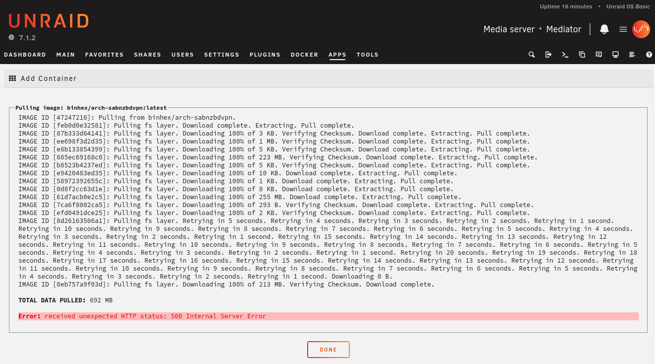

We had a power outage today. The Sabnzbd docker is the only one that wouldn't start, showing error 403. I removed the docker and image, and am trying to reinstall from the Community App Store. But it shows this error:
Can anyone help with this?
that is a connectivity related issue and/or issues with the registry (probably github), try it again in 1 hour, if still no joy then take a look at your router.

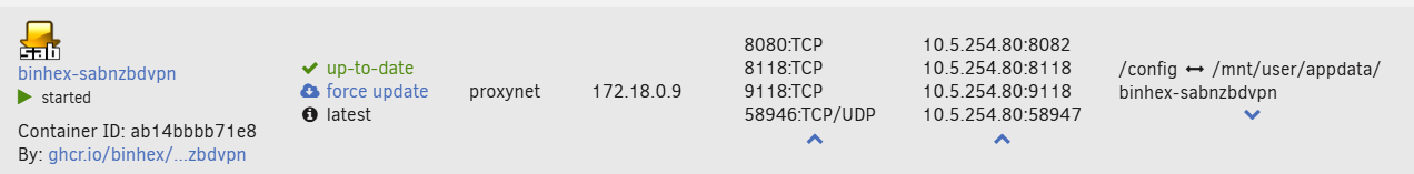

I am unable to get to the GUI via LAN when I enable the VPN feature. Using PIA as my provider.
this is the log for the container within Unraid after it starts:

Any idea why I can only get to the GUI when VPN is turned off?
what is LAN_NETWORK defined as? and what is the ip of the machine running the web browser that you are attempting connection from?.
LAN is 10.5.24.0/24 Local PC (same subnet) running windows 11 with Chrome as browser. Running on a custom network (named proxynet)
Edited by mgadbois
added images
