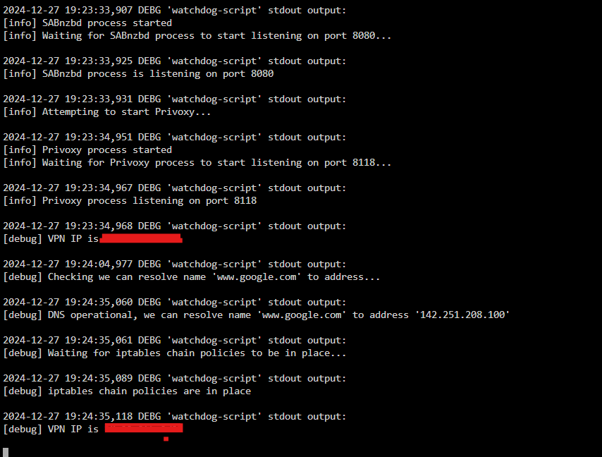

I have cannot to connect to my binhex – SABnzbdVPN.
Unfortunately I am one of the guys who just follow youtube tutorials.
In the supervisor log I find after restarting the container:
2024-12-24 14:08:23,900 DEBG 'watchdog-script' stdout output:
[debug] DNS operational, we can resolve name 'www.google.com' to address '142.251.39.100'
[debug] Waiting for iptables chain policies to be in place...
2024-12-24 14:08:23,905 DEBG 'watchdog-script' stdout output:
[debug] iptables chain policies are in place
2024-12-24 14:08:23,912 DEBG 'watchdog-script' stdout output:
[debug] VPN IP is 100.64.40.242
That looks to me that a connection of the vpn is given.
In the  sabnzbd.log I get:
2024-12-24 13:57:06,896::INFO::[_cplogging:213] [24/Dec/2024:13:57:06] ENGINE Bus STARTING
2024-12-24 13:57:06,998::INFO::[_cplogging:213] [24/Dec/2024:13:57:06] ENGINE Serving on http://0.0.0.0:8080
2024-12-24 13:57:07,116::INFO::[_cplogging:213] [24/Dec/2024:13:57:07] ENGINE Serving on https://0.0.0.0:8090
2024-12-24 13:57:07,116::INFO::[_cplogging:213] [24/Dec/2024:13:57:07] ENGINE Bus STARTED
2024-12-24 13:57:07,117::INFO::[_cplogging:213] [24/Dec/2024:13:57:07] ENGINE Client ('127.0.0.1', 36986) lost — peer dropped the TLS connection suddenly, during handshake: (8, '[SSL: UNEXPECTED_EOF_WHILE_READING] EOF occurred in violation of protocol (_ssl.c:1000)')
I tried it with and without tailscale running on local IP and tailscale url. Binhex-sonarr and binhex-radarr can also not connect.
Can anybody help. My kids want their christmas movies 😊

Same issue here. The docker container "sabnzbd" (without vpn) runs perfectly. I am in the same loop like Dr. Tom.
looks like a vpn provider issue to me, try a different endpoint, if that still fails then contact your vpn provider.
I tried 5 different locations. Provider is PIA, if it helps anyone. :)
Edited by sne

I tried differnt locations and providers -- did not help
then I downgraded from 4.4.1-1-01 from 20.12.2024  to 4.4.0-1-01 from 22.07.2024 but this did not help
I ran out of Ideas
Thomas
