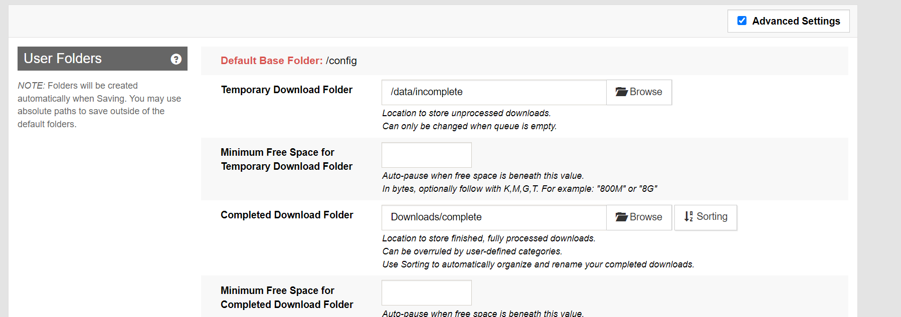

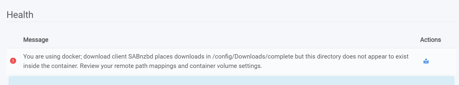

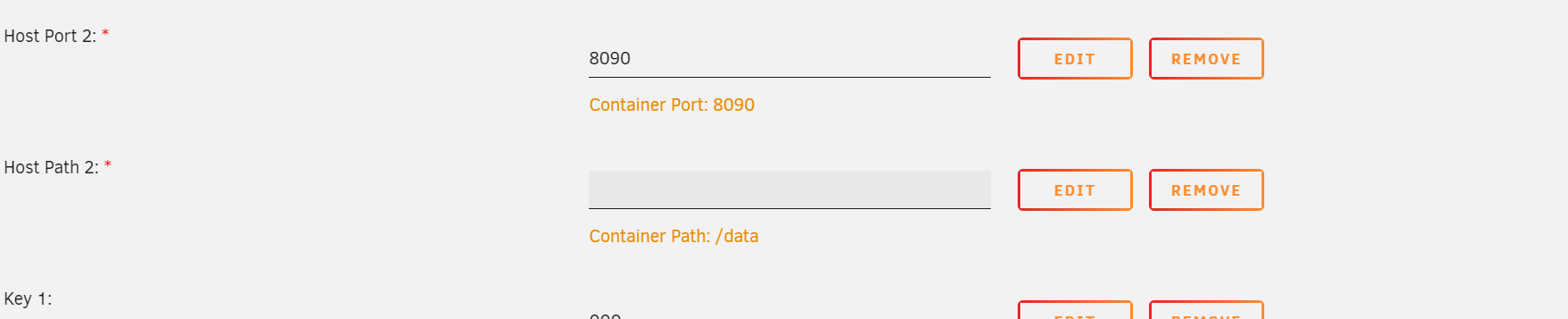

Sin SabNZB I have these settings....
Radarr says this......
That’s why I told you that you need a remote path setting in the download clients settings page.

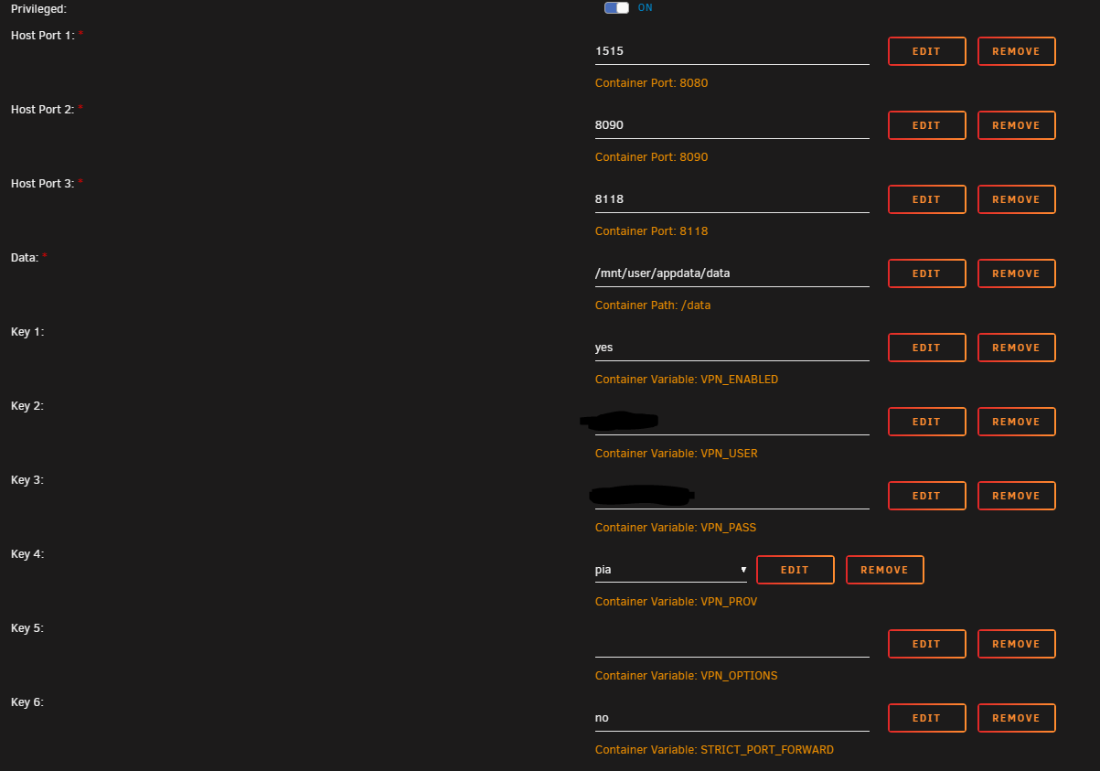

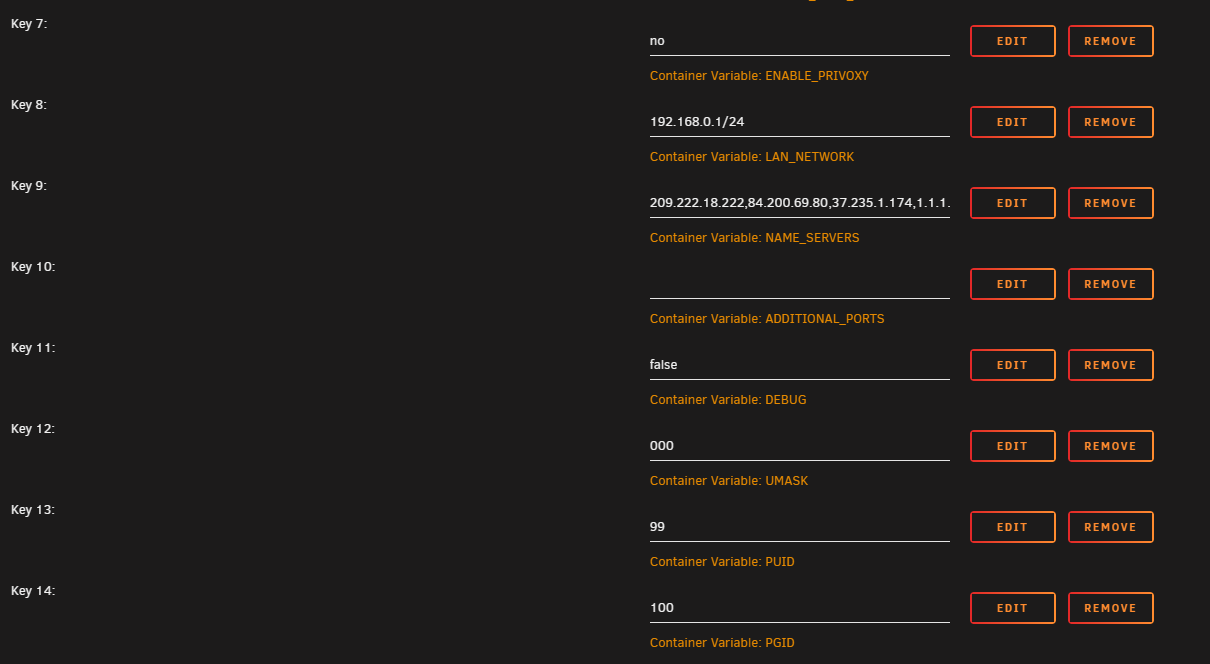

Why cant I connect sab to my LAN?
It seems there is a network problem. All was fine before
1 error showing:
Edited by K1LLA_KING_KING

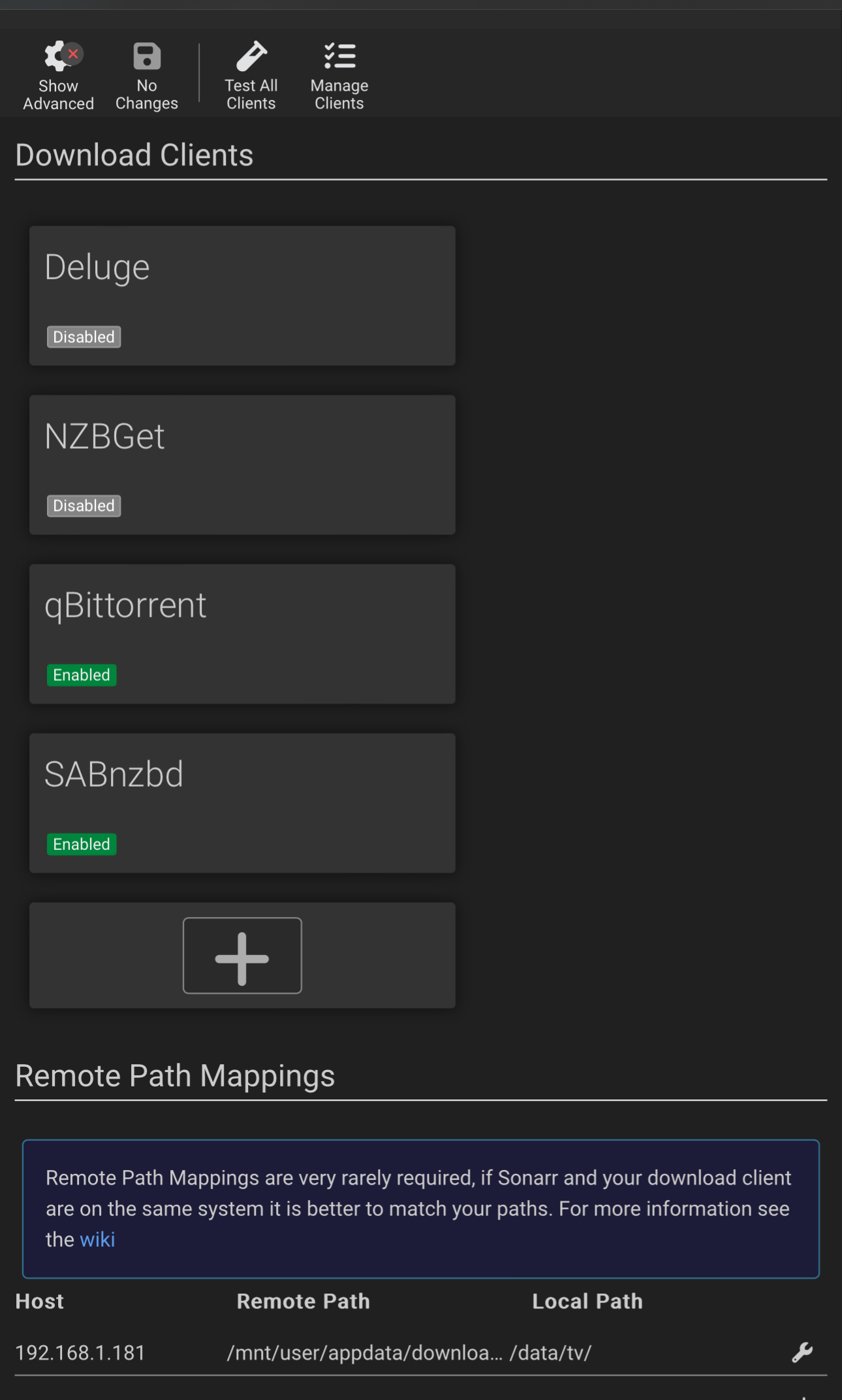

Thanks, so based on the share media and the two folders, tv and film in it what do the paths and remote paths need to be, I can't work it out.
Something like this In Sonarr (/data/movies in Radar):
17 hours ago, binhex said:
firstly you cannot ping an ip address specifying the port.
And as you highlighted, the LAN_NETWORK is incorrectly configured, see Q4:- https://github.com/binhex/documentation/blob/master/docker/faq/vpn.md
Thank you very much thats worked for me. But also very strange. As I had not changed this setting, and was working fine for months prior.

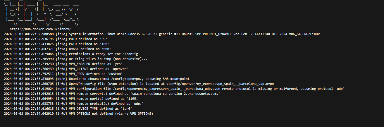

Hi all. My Sabnzbd container has been working great up until recently. I updated it and it gets stuck at the image attached and goes no further. Any help would be greatly appreciatedimage.thumb.png.56ac7d18d060b076421a46ba096f1836.png
Try recreating the .ovpn file from your expressvpn account.

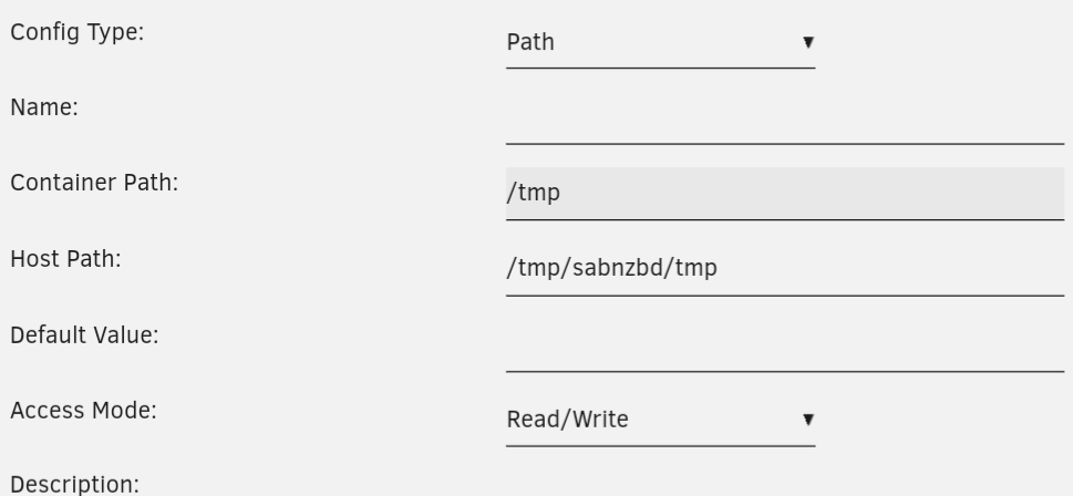

Could you please add this path to the default config to reduce wear on the SSD:
Sab is permanently writing to these files:
root@thoth:~# find /tmp/sabnzbd/
/tmp/sabnzbd/
/tmp/sabnzbd/tmp
/tmp/sabnzbd/tmp/vpngatewayip
/tmp/sabnzbd/tmp/vpnip
/tmp/sabnzbd/tmp/getiptables
/tmp/sabnzbd/tmp/watchdog-script-stderr---supervisor-jgbmg455.log
/tmp/sabnzbd/tmp/watchdog-script-stdout---supervisor-dva2j1vt.log
/tmp/sabnzbd/tmp/start-script-stderr---supervisor-5i8155s4.log
/tmp/sabnzbd/tmp/start-script-stdout---supervisor-whva770j.log
/tmp/sabnzbd/tmp/endpoints
And by using /tmp this are written to unRAID's RAM disk.
