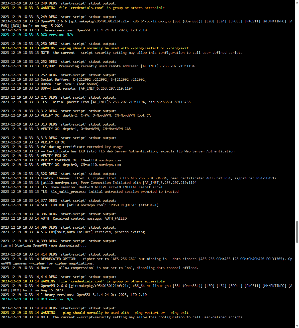

Thanks i have found it the problem was i would log in with mail and not with manual login
Thanks

It seems the last update of the docker container has just killed it. I can't connect to the WebUI anymore. How can I troubleshoot that? 🙂 Or: What kind of Logs or configurations are needed to find out, what has killed it?
if its happened all of a sudden its nearly always vpn provider related, do this:- https://github.com/binhex/documentation/blob/master/docker/faq/help.md

Uhm... I don't understand, the connection between the fail to connect to the local docker-container and the vpn-provider.
But, here is the log:

2024-01-11 19:45:51,154 DEBG 'start-script' stdout output:
[debug] Environment variables defined as follows
ADDITIONAL_PORTS=
APPLICATION=sabnzbd
BASH=/bin/bash
BASHOPTS=checkwinsize:cmdhist:complete_fullquote:extquote:force_fignore:globasciiranges:globskipdots:hostcomplete:interactive_comments:patsub_replacement:progcomp:promptvars:sourcepath
BASH_ALIASES=()
BASH_ARGC=()
BASH_ARGV=()
BASH_CMDS=()
BASH_LINENO=([0]="0")
BASH_LOADABLES_PATH=/usr/local/lib/bash:/usr/lib/bash:/opt/local/lib/bash:/usr/pkg/lib/bash:/opt/pkg/lib/bash:.
2024-01-11 19:45:51,155 DEBG 'start-script' stdout output:
BASH_SOURCE=([0]="/root/start.sh")
BASH_VERSINFO=([0]="5" [1]="2" [2]="21" [3]="1" [4]="release" [5]="x86_64-pc-linux-gnu")
BASH_VERSION='5.2.21(1)-release'
DEBUG=true
DIRSTACK=()
ENABLE_PRIVOXY=no
EUID=0
GROUPS=()
HOME=/home/nobody
HOSTNAME=0c564fac1cfd
HOSTTYPE=x86_64
HOST_CONTAINERNAME=binhex-sabnzbdvpn
HOST_HOSTNAME=AngryNerds
HOST_OS=Unraid
IFS=$' \t\n'
LANG=en_GB.UTF-8
LAN_NETWORK=192.168.1.0/24
MACHTYPE=x86_64-pc-linux-gnu
NAME_SERVERS=84.200.69.80,37.235.1.174,1.1.1.1,37.235.1.177,84.200.70.40,1.0.0.1
OPTERR=1
OPTIND=1
OSTYPE=linux-gnu
PATH=/usr/local/sbin:/usr/local/bin:/usr/sbin:/usr/bin:/sbin:/bin
PGID=100
PIPESTATUS=([0]="0")
PPID=7
PS4='+ '
PUID=99
PWD=/
SHELL=/bin/bash
SHELLOPTS=braceexpand:hashall:interactive-comments
SHLVL=1
STRICT_PORT_FORWARD=no
SUPERVISOR_ENABLED=1
SUPERVISOR_GROUP_NAME=start-script
SUPERVISOR_PROCESS_NAME=start-script
TCP_PORT_8080=8080
TCP_PORT_8090=8090
TCP_PORT_8118=8118
TERM=xterm
TZ=Europe/Berlin
UID=0
UMASK=000
VPN_CLIENT=openvpn
VPN_CONFIG=/config/openvpn/jfk-006.default.ovpn
VPN_DEVICE_TYPE=tun0
VPN_ENABLED=yes
VPN_INPUT_PORTS=
VPN_OPTIONS=
VPN_OUTPUT_PORTS=
VPN_PASS=''
VPN_PROV=custom
VPN_REMOTE_IP_LIST=146.70.115.81
VPN_REMOTE_PORT=1194,
VPN_REMOTE_PROTOCOL=udp,
VPN_REMOTE_SERVER=jfk-006.vpn.privado.io,
VPN_USER=
_='[debug] Environment variables defined as follows'
password_char_check=$'#\n&'
username_char_check=
vpn_ping=
[debug] Directory listing of files in /config/openvpn/ as follows
2024-01-11 19:45:51,165 DEBG 'start-script' stdout output:
total 8
drwxrwxr-x 1 nobody users   72 Jan 11 19:45 .
drwxrwxr-x 1 nobody users  164 Jan 11 19:45 ..
-rwxrwxr-x 1 nobody users   24 Jan 11 19:45 credentials.conf
-rwxrwxr-x 1 nobody users 2463 Jan 11 19:45 jfk-006.default.ovpn
2024-01-11 19:45:51,167 DEBG 'start-script' stdout output:
[debug] Contents of OpenVPN config file '/config/openvpn/jfk-006.default.ovpn' as follows...
2024-01-11 19:45:51,170 DEBG 'start-script' stdout output:
client
dev tun
proto udp
remote jfk-006.vpn.privado.io 1194
resolv-retry infinite
nobind
persist-key
persist-remote-ip
tls-client
#block-outside-dns
route 0.0.0.0 0.0.0.0 vpn_gateway
route-delay 3
# if you're using openvpn versions later than 2.5 uncomment the following:
# data-ciphers AES-256-CBC
# data-ciphers-fallback AES-256-CBC
# openvpn versions <= 2.5 use the following default settings:
auth SHA256
cipher AES-256-CBC
tls-cipher TLS-DHE-RSA-WITH-AES-256-CBC-SHA:TLS-DHE-DSS-WITH-AES-256-CBC-SHA:TLS-RSA-WITH-AES-256-CBC-SHA
remote-cert-tls server
auth-user-pass credentials.conf
verb 3
<ca>
Because if the vpn fails to come up the application is not started and thus you cannot access the web ui, its a safety feature to prevent ip leakage.
This is your issue, from your log:- [UNDEF] Inactivity timeout (--ping-restart), restarting
see Q17:- https://github.com/binhex/documentation/blob/master/docker/faq/vpn.md
Ha! Great! I exchanged the configuration file to another server and tadaaa - works again.
And again I learned somethin new today (and got a lot of documentation to read). Thanks! :)
