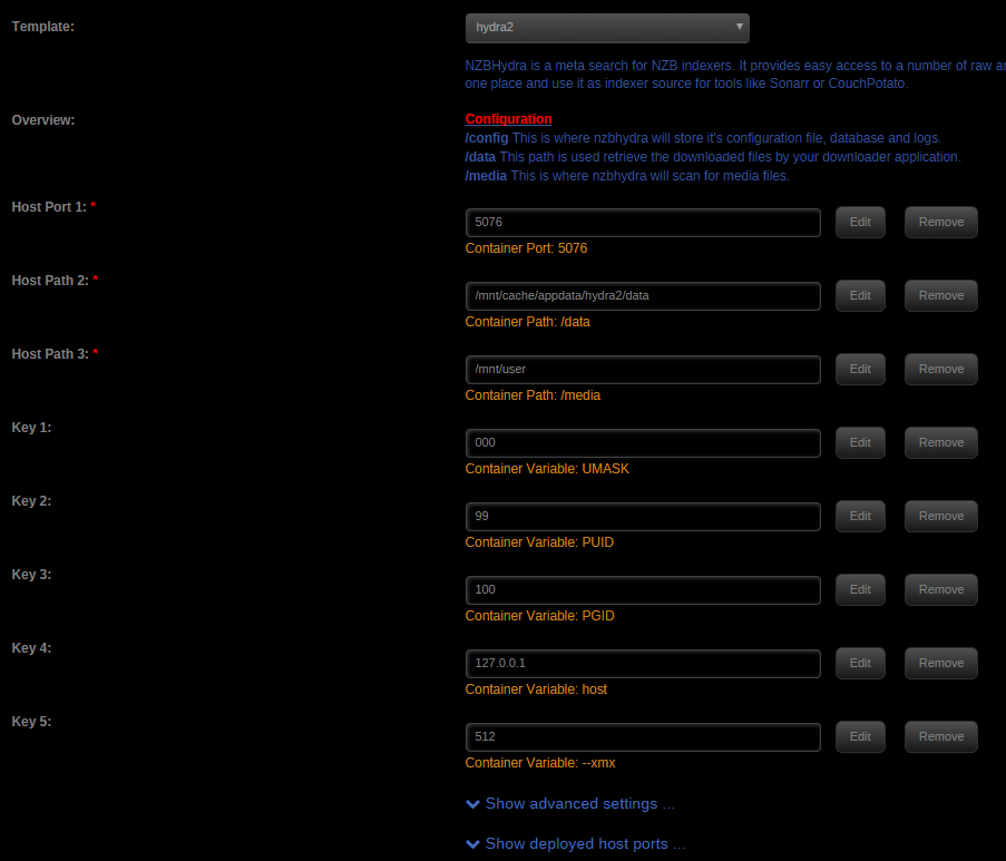

    For the guys that want to test this and don't want to mess around with the command line,  I made a template off of binxex's old hyra1 which can help you.   Go to the Docker tab and add this
So... NZBHydra2 (git) was announced today.  :D The author could definitely use some help on the docker front as the one he released overwrites the config whenever a change is made to the template.
Go to the Docker tab and add this : https://github.com/tuxcomputing/unraid-templates in "template repositories" and then Save.
Then Add Container and select the template "hydra2".
You will see the normal hydra1/unraid settings plus a few new ones (see picture).
IMPORTANT: Make sure you set the IP to the internal network IP where your unraid server is located, ie 192.168.11.22 ete in the HOST field.
Everything should be easy from there on.
Annoyances:
- it might not start the first time, you might need to stop-start/restart the container once until it starts off (check the logs!)
-I did not manage to get the hydra icon to show up (i'm a noob)
Security:
I did not add any code except from what binhex already had on hydra1.
All code can be tested on the github link
Bugs:
There are a few, please check the official github here: https://github.com/theotherp/nzbhydra2/issues
Remember that this is still a work in process for the developer and it will take some time before a decent container comes out. (ie. not my fault if your stuff breaks)
Edited by omfgunraid

My v1 database is quite large. How do I increase the memory settings? Keep getting java heap error messages when migrating.
I'm not sure you can,  have you tried v2?
Sorry, I was not to clear. I am trying to migrate my v1 database into v2
So you're getting java heap error messages in V2 when trying to import your existing database?
That is correct. It is recommended to temporarily increase memory when importing a big database by using parameter xmx 512. But how does one do this in a docker environment?
Via the webui
Via the webui
Screen_Shot_2018-02-10_at_08.57.36.png&key=54c884c9f330182610208ee00de349318be00b72818bacad5e335648b143345c
That did the trick. Thanks! The migration did not go 100% for the settings, but hey, .... it’s still in beta.
