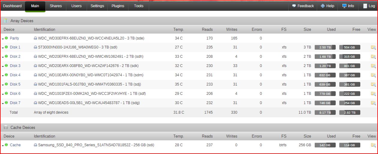

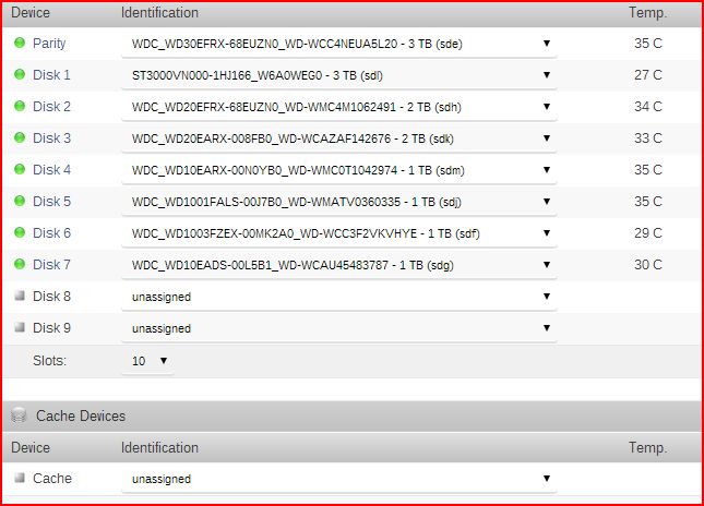

Attached are screenshots with all drives assigned and array running then second is after a reboot.
