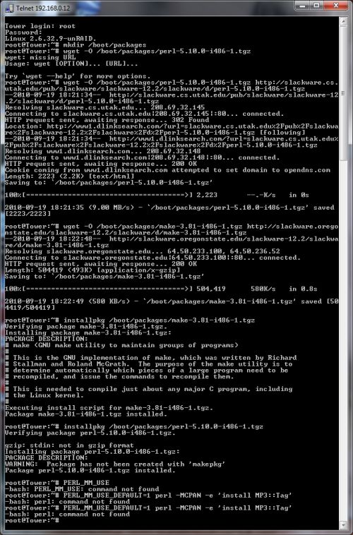

Right, ok, that's clearer now, thanks.
I've telnetted in, run all the commands.
At #5 it was "installed", but there is a warning:
Package has not been created with 'makepkg'
At #6, I typed in
PERL_MM_USE_DEFAULT=1 perl -MCPAN -e 'install MP3::Tag'
Result:
-bash: perl: command not found.
If I could paste the output I would, but don't know how to log the telnet session.
Sorry for all the trouble.
Oh - I should note that I would presume the most obvious reason for getting this is a command mistype, but I can assure you that it was accurate and precisely the same. I've made a number of attempts in case there were any hidden characters as well.
I just tried those same six commands on my second server.  ( I already had a /boot/packages directory, so I did not need to create it with
mkdir /boot/packages
root@Tower2:~# wget -O /boot/packages/perl-5.10.0-i486-1.tgz http://slackware.cs.utah.edu/pub/slackware/slackware-12.2/slackware/d/perl-5.10.0-i486-1.tgz

Your download of the perl package was not successful.
It should have said something like this when it was completed:
16,333,254  63.6K/s  in 4m 14s
2010-09-19 21:27:29 (62.8 KB/s) - `/boot/packages/perl-5.10.0-i486-1.tgz' saved [16333254/16333254]
That is why it did not install, and was subsequently not found when you tried to invoke it.
Joe L.
It appears as if you tried to download perl from utak.edu instead of utah.edu.   Your ISP gave you an alternate page instead.
You downloaded a few thousand characters instead of 16Meg, and it was probably a page-not-found message.
