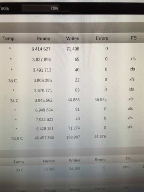

No it's not dead, just has some 45000 errors [emoji3]
Where are you seeing these errors? Most likely a connection problem. Post Diagnostics.
In the main screen
you should check the S.M.A.R.T report to see what's up.
Based on the fact that of your 450000 errors it appears there were only 13 good writes... I want to believe that there is some sort of issue with the cable.
Interesting theory. These are very old HDDs though so it is not impossible they are a bit tired.  What should I check in the SMART report?
Post Diagnostics and we can check them for you.

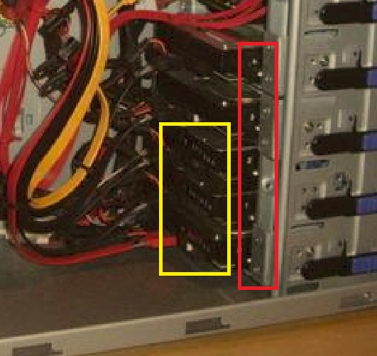

Sorry for the Garbage pick. Its from a zoomed in and then cropped photo. I put disk number on the outside in Red and my serial number of each in yellow near the Sata connection. I bought one of those 5 Dollar Label makers.
As for errors it helps none, but just an idea for future problems.
SMART does not look good, I would replace it, if you want to be sure run an extended SMART test, I expect it will fail.
