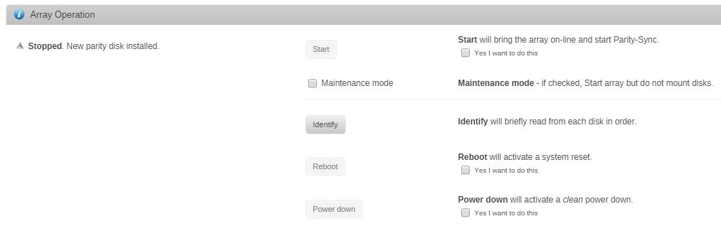

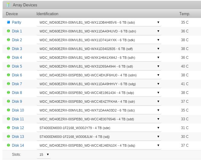

Assign all your disks as before but don't start. Then post a screenshot that shows your disk assignments, and a screenshot that shows Array Operations.

Below the two screenshots you had requested.
Did you New Config and reassign all drives including parity, or did you just add parity to the existing config instead?
The goal is to get it to let you trust parity instead of forcing you to sync it.
