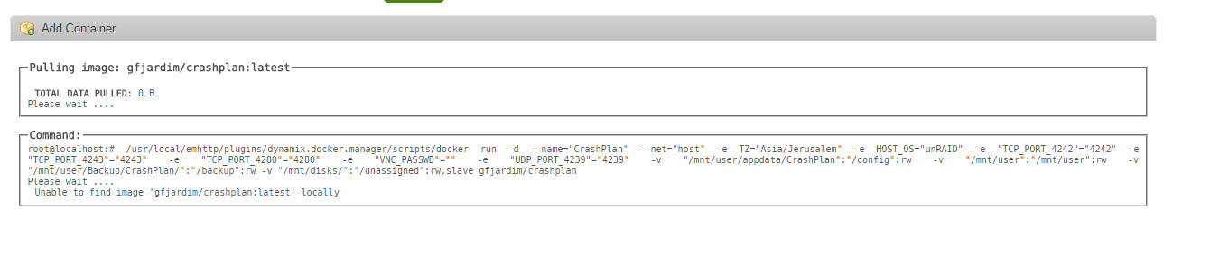

Total Data Pulled: 0 Bytes from Docker Hub

Gico, can you delete your docker.img and your appdata folder and try installing a container again please?
Done. No change: gfjardim/crashplan 0 bytes pulled.
Sorry..didn't delete the appdata. Will try again.
Deleted Docker image and appdata, and reinstalled. linuxserver/mariadb 0 bytes pulled.

There are a couple issues here and the next release of unRAID should fix at least one of them and warn about the other.
Problem) "0 bytes pulled" when updating a Docker container but Check For Updates always shows 'update ready'.
Solution) Wait for next release (coming soontm) -- In the new release, the Check For Updates will show up to date for those containers correctly.
Problem) Adding or Updating a Docker container but after completion shows update 'not available' until you Check For Updates then always shows 'update ready'  OR  Doing a 'docker pull <author/app>' from CLI reveals the error message 'layers from manifest don't match image configuration'.
Solution) Delete docker.img (Disabling Docker then deleting the Docker image from Settings -> Docker Settings page), Start Docker back up and reinstall all of your Docker containers.  No need to delete any of your appdata folders.  The next release will at least show you this error message when adding/updating a Docker container and will prevent removing your existing (and working) older version of the Docker container.
Problem) HTTP 400 errors in docker.log during a docker pull...
Solution) Haven't found one yet and unable to reproduce here
Out of curiosity, what is the cause of ^^^

Oct 24th 2016 Update: This problem has nothing to do with unRaid version.
Found this thread at docker hub and as suggested, lowering the MTU to 900 solved this issue.
This has been a most frustrating issue that had a major affect on my server functionality (couldn't install/update containers!).
