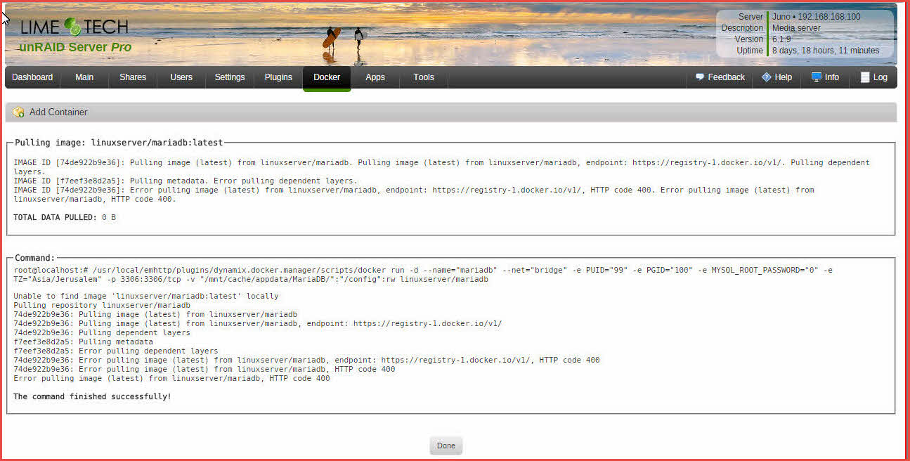

I am unable to create the container, seems my unRaid (v6.1.9) server is unable to pull the image.
This is my first container, however I have managed to install/update apps/plugins, so the server has internet access.
Pulling image: linuxserver/mariadb:latest
IMAGE ID [74de922b9e36]: Pulling image (latest) from linuxserver/mariadb. Pulling image (latest) from linuxserver/mariadb, endpoint: https://registry-1.docker.io/v1/. Pulling dependent layers.
IMAGE ID [f7eef3e8d2a5]: Pulling metadata. Error pulling dependent layers.
IMAGE ID [74de922b9e36]: Error pulling image (latest) from linuxserver/mariadb, endpoint: https://registry-1.docker.io/v1/, HTTP code 400. Error pulling image (latest) from linuxserver/mariadb, HTTP code 400.
TOTAL DATA PULLED: 0 B
Any ideas?

I have a problem pulling any of LinuxServer docker images.

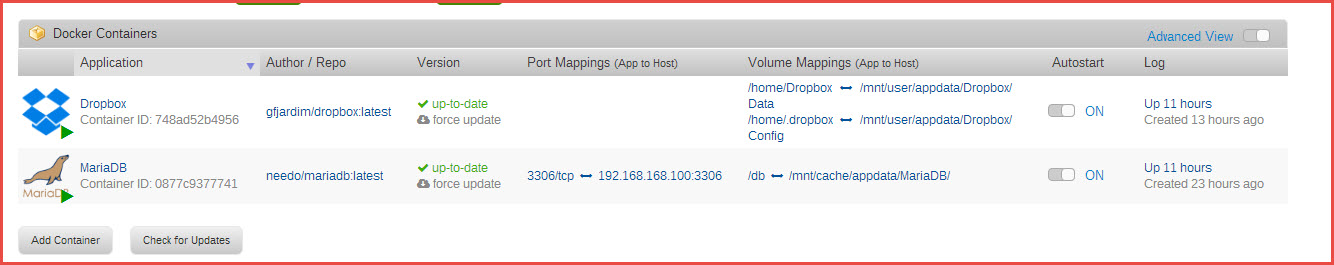

Some docker images yes (see enclosed image), but none of about 3-4 linuxserver's that I tried. Can't pull mace's Qbittorrent image too.
