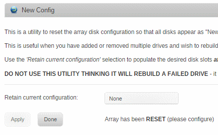

I tried a couple more times, and lost the assignments each time.  It starts with picture 1 below, then I click on All, then click on the box for All, then click on either the <close...> or the first All again to close the drop down, then click the Yes, I want to do this box, and get picture 2.  The super.dat is still fine.  As soon as I click the Apply button, it goes back to picture 1, exactly, and super.dat is now empty!  This was on Firefox, and I repeated it several times, with slight variations in clicking, but no change in behavior.  I restore by copying back super.dat from a saved copy, then Shift-reloading the Main screen (it works!).
Finally, I tried the same thing in Chrome, and got the same results, same pictures and empty super.dat, except this time I did not click the Done button, I clicked the Main tab instead, and it showed my assignments.  I unassigned one of them and started the array, and super.dat was repopulated, correctly!

After you have clicked on the Apply button you should then click on the Done button to close that dialog.  Switching to the Main tab should show the drives still assigned as they would be when setting up an array from scratch and the array not started.    It is when you try and start the array from the Main tab that the super.dat gets written.

After pressing Apply the array will be reset (super.dat = empty) and the slots will be prepopulated with the existing assignments (depending on your choice).
The screens on NewConfig should look like the attached pictures.
However... (bug spoiler) the second picture doesn't occur because the array status $var['mdState'] isn't updated when the page view returns after the submit, and hence you still see the previous message. Need to work with LT to see how to address this. To be clear, it is just a display thing in the GUI. The execution is done alright.

There is a possible 'race condition' which may prevent the population of the slots. For this I've made a correction.
