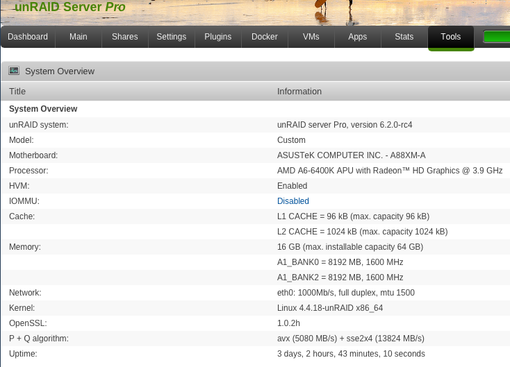

As a path of least resistance perhaps system info would be a sane place to present the figures in a human readable way.
You mean something like this ?
Meh - I don't see the value in presenting this info because there's nothing you can do with it.  The rate "is what it is".
Sure, for the system you have. But it is very helpful for what-if situations.
The community wants to have a database of various setups and their performance so users on lower end systems know what to expect IF they go Dual-Parity. It also helps them if they're having lower performance than they'd like in knowing what a possible upgrade would give them.
Not disputing that, in fact we have something in the works.  My objection is there's no point putting it in the Info box.
Not sure I follow. You add a new feature that is CPU intensive. There is a value buried in the logs that lets users know if their systems is capable of supporting the additional CPU workload vs their disk count.
I see no reason why we would ask users to use SSH and grep to find this figure.
However it sounds like you have decided this is the way so at the very least the procedure to check or dimension the CPU for the feature should be documented. This forum post is not documentation.
If you are looking for the testing that the OS does to determine which algorithms it is going to use to generate/test parity, you can find it with the GUI.
Go to >>  'Tools'  >>  'System Log'.  Now use the browser text search tool that is built into your browser (Contl-F for firefox).  You want to search for    raid6:  and about 22 lines above the first occurrence of  raid6:  you will find the value for single parity called xor: measuring software checksum speed  .

These were my results, if nothing else it allows some users with older hardware to estimate parity check performance with dual parity, provided they have no other bottlenecks.
<<< snip >>
All speeds are both the average and max speeds as I used SSDs, AMD and Intel platforms hardware used was the same between all tests, only the CPU changed.
IMO a dual core AMD or Intel CPU has enough performance for a mid sized array, considering these CPUs cost 20$ on ebay, even if you have to buy one to enjoy dual parity it's a pretty good deal. Single core CPUs should be avoided, especially the AMD Sempron, so slow I didn't bother to complete all the tests, even the webGUI response is bad with the one I used, I would recommend V6 users with a Sempron to upgrade to dual core even if they're not considering dual parity.

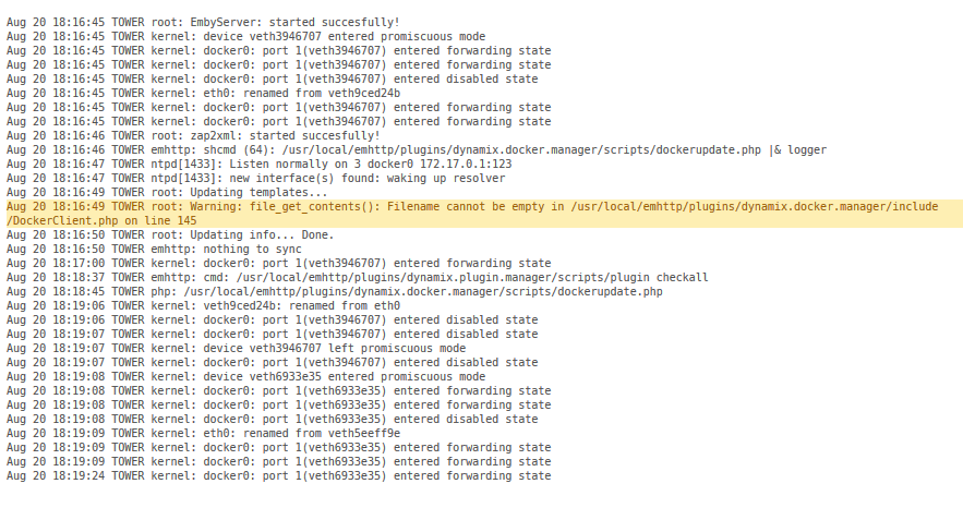

Thanks guys. It's working now, my array is started but now all my dockers are missing and my win10 vm isn't working either.  hmmm.
Edit...scratch that.  The vm is working just the dockers are all missing.
I deleted the docker image and i'm rebuilding all my dockers via docker templates.
Another thing I noticed with rc4 is that it changed my ip to dhcp and enabled bonding automatically.  I never had any of that set. I had a static ip address entered....
