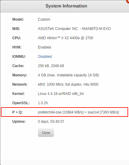

If you look near the top of your system log, there are a set of messages that output the rate at which various gen/xor algorithms run using different instruction sets.  It then picks the best performing function to be used.  Here 'gen' means "generate Q" and 'xor' means "generate P", ie, simple XOR.
The first ones that measure xor speed (P calculation) begin with "kernel: xor:", then there are a set that begin with "kernel: raid6:" which measure algorithm used to calculate Q.
Here is what I see for a lowly Atom D510 @ 1.66GHz:
Aug 18 10:13:21 Test1 kernel: xor: measuring software checksum speed
Aug 18 10:13:21 Test1 kernel:   prefetch64-sse:  5424.000 MB/sec
Aug 18 10:13:21 Test1 kernel:   generic_sse:  4912.000 MB/sec
Aug 18 10:13:21 Test1 kernel: xor: using function: prefetch64-sse (5424.000 MB/sec)
Aug 18 10:13:21 Test1 kernel: raid6: sse2x1   gen()   113 MB/s
Aug 18 10:13:21 Test1 kernel: raid6: sse2x1   xor()   714 MB/s
Aug 18 10:13:21 Test1 kernel: raid6: sse2x2   gen()   371 MB/s
Aug 18 10:13:21 Test1 kernel: raid6: sse2x2   xor()  1193 MB/s
Aug 18 10:13:21 Test1 kernel: raid6: sse2x4   gen()   632 MB/s
Aug 18 10:13:21 Test1 kernel: raid6: sse2x4   xor()  1316 MB/s
Aug 18 10:13:21 Test1 kernel: raid6: using algorithm sse2x4 gen() 632 MB/s
Aug 18 10:13:21 Test1 kernel: raid6: .... xor() 1316 MB/s, rmw enabled
Aug 18 10:13:21 Test1 kernel: raid6: using ssse3x2 recovery algorithm
The best it can do is 632 MB/s for gen and 5424 MB/s for xor.  If we assume average throughput for attached HDD's is 100 MB/s, then barring other bottlenecks, this says that with 6 or fewer array devices, dual-parity sync/check will be disk bandwidth limited; but, if you go wider than that, CPU will start limiting performance.  In single-parity setup, no CPU bottleneck until you go to 54 drives or higher (ie, never a bottleneck).
Here is what I see for a Core i5-4430 @ 3.00 GHz (a modest CPU by today's standards):
Aug 18 09:59:07 test2 kernel: xor: automatically using best checksumming function:
Aug 18 09:59:07 test2 kernel:   avx       : 41780.000 MB/sec
Aug 18 09:59:07 test2 kernel: raid6: sse2x1   gen()  9300 MB/s
Aug 18 09:59:07 test2 kernel: raid6: sse2x1   xor()  7027 MB/s
Aug 18 09:59:07 test2 kernel: raid6: sse2x2   gen() 11988 MB/s
Aug 18 09:59:07 test2 kernel: raid6: sse2x2   xor()  8070 MB/s
Aug 18 09:59:07 test2 kernel: raid6: sse2x4   gen() 14296 MB/s
Aug 18 09:59:07 test2 kernel: raid6: sse2x4   xor()  9363 MB/s
Aug 18 09:59:07 test2 kernel: raid6: avx2x1   gen() 18269 MB/s
Aug 18 09:59:07 test2 kernel: raid6: avx2x2   gen() 21593 MB/s
Aug 18 09:59:07 test2 kernel: raid6: avx2x4   gen() 25238 MB/s
Aug 18 09:59:07 test2 kernel: raid6: using algorithm avx2x4 gen() 25238 MB/s
Aug 18 09:59:07 test2 kernel: raid6: sse2x1   xor()  7031 MB/s
Aug 18 09:59:07 test2 kernel: raid6: sse2x2   xor()  8330 MB/s
Aug 18 09:59:07 test2 kernel: raid6: .... xor() 9363 MB/s, rmw enabled
Aug 18 09:59:07 test2 kernel: raid6: using avx2x2 recovery algorithm
This should support a 25-drive array before CPU becomes bottleneck in dual-parity sync/check. Notice that for the xor calculation, if AVX instruction set is present, kernel uses it and doesn't bother measuring others.

First thing I question is your math  (i.e.;  25238/100  is not ~ 25...).  But that aside here are the section of the syslog for my Testbed server (Rose):
Aug 18 14:59:24 Rose kernel: xor: measuring software checksum speed
Aug 18 14:59:24 Rose kernel:   prefetch64-sse: 10844.000 MB/sec
Aug 18 14:59:24 Rose kernel:   generic_sse: 10264.000 MB/sec
Aug 18 14:59:24 Rose kernel: xor: using function: prefetch64-sse (10844.000 MB/sec)
Aug 18 14:59:24 Rose kernel: PCI: MMCONFIG for domain 0000 [bus 00-ff] at [mem 0xe0000000-0xefffffff] (base 0xe0000000)
Aug 18 14:59:24 Rose kernel: PCI: not using MMCONFIG
Aug 18 14:59:24 Rose kernel: PCI: Using configuration type 1 for base access
Aug 18 14:59:24 Rose kernel: PCI: Using configuration type 1 for extended access
Aug 18 14:59:24 Rose kernel: raid6: sse2x1   gen()  3574 MB/s
Aug 18 14:59:24 Rose kernel: raid6: sse2x1   xor()  3529 MB/s
Aug 18 14:59:24 Rose kernel: raid6: sse2x2   gen()  5753 MB/s
Aug 18 14:59:24 Rose kernel: raid6: sse2x2   xor()  5962 MB/s
Aug 18 14:59:24 Rose kernel: raid6: sse2x4   gen()  7386 MB/s
Aug 18 14:59:24 Rose kernel: raid6: sse2x4   xor()  3783 MB/s
Aug 18 14:59:24 Rose kernel: raid6: using algorithm sse2x4 gen() 7386 MB/s
Aug 18 14:59:24 Rose kernel: raid6: .... xor() 3783 MB/s, rmw enabled
Using your method, I get a figure of 108 disks for single parity and 73 disks for dual parity.  Yet, the dual parity speeds for recent releases appear to be CPU limited for this server and they were not for beta 19.  Any insight you can provide would be appreciated.
Doh!
At the moment, can't explain it.
To add to earlier post, I said, "barring other bottlenecks"... as the array width increases overall "strain" on the system increases.  Usually first to top out is a PCI bus, where, for example, you might have a single disk controller with more disk-side bandwidth than PCI bus bandwidth.  Next would be the memory controller where there is more overall I/O bandwidth than the memory controller can support.

Very interesting and useful information. Given that the forum, wiki and google have a decade of CPU recommendations that do not take this into account we should promote these figures out of the logs and into the GUI.
As a path of least resistance perhaps system info would be a sane place to present the figures in a human readable way.
You mean something like this ?
That is nice place to display the information.  Now all that remains is to figure out what the numbers are telling us in the real world of things like writing speed, and parity check speeds and times.

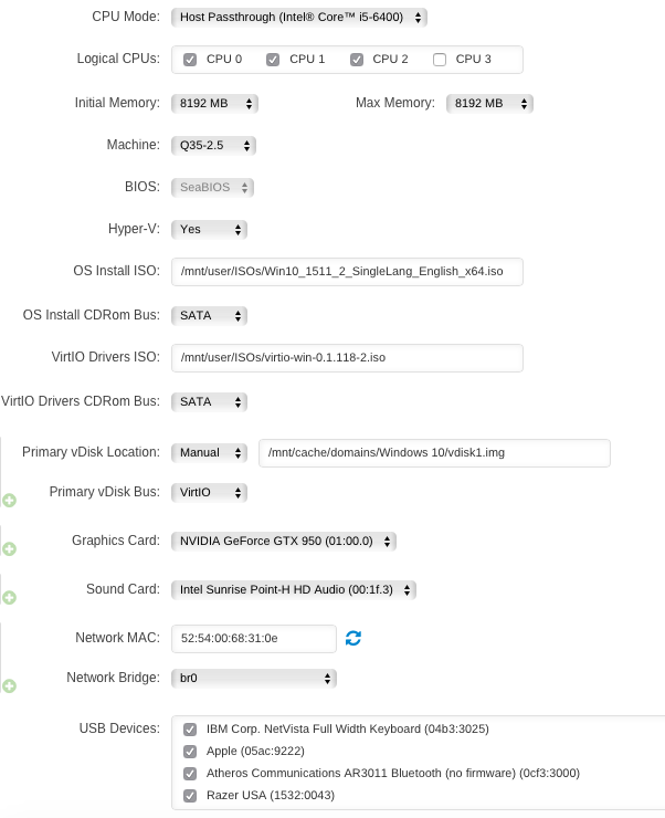

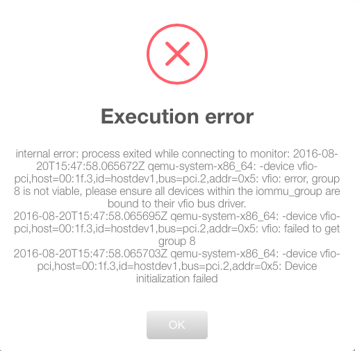

Hi there,
I just upgraded from RC3 to RC4 and although everything upgraded without issue, I am now unable to launch my Windows 10 VM with VGA passthrough which worked fine before the upgrade. I did a plugin upgrade.
Attached are my diagnostic file, error message, and VM config.
Please let me know what I can do to get this working again.
Thanks
fosterserver-diagnostics-20160820-1147.zip
Meh - I don't see the value in presenting this info because there's nothing you can do with it.  The rate "is what it is".
Sure, for the system you have. But it is very helpful for what-if situations.
The community wants to have a database of various setups and their performance so users on lower end systems know what to expect IF they go Dual-Parity. It also helps them if they're having lower performance than they'd like in knowing what a possible upgrade would give them.
I like the idea of having a number that would indicate expected dual parity performance, but from what I've been reading don't know this is it:
