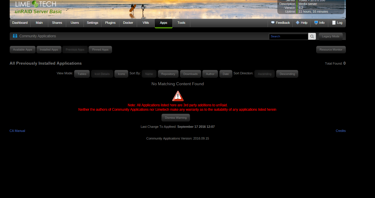

September 17, 201610 yr Author Nope, not there. I have nothing showing up under user defined templates, or on the previous apps section of CA.
September 17, 201610 yr Nope, not there. I have nothing showing up under user defined templates, or on the previous apps section of CA. Because those files were stored on the flashdrive (config/plugins/dockerMan/templates-user) and you've now started the flash over again from complete scratch.
