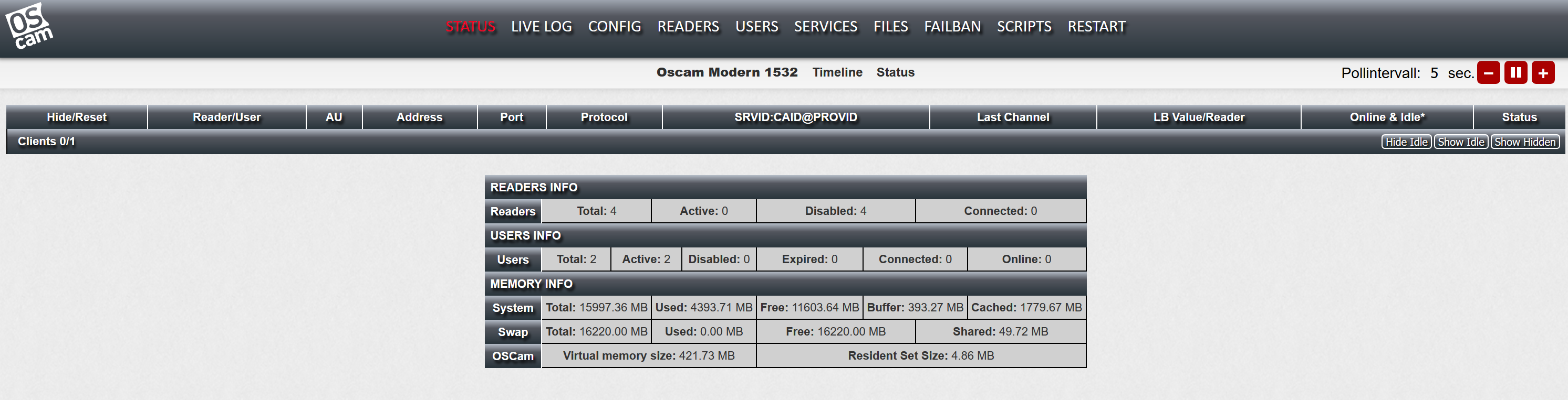

Hey guys,
just set up Oscam which is running fine at the moment. No technical problems.
But I dont like the fact, that i shows build r0 instead of the real version number.
I checked what s.Oliver did and used for tests the etiket :66 and it shows Build: r11391 as supposed.
But the latest or any other shows r0.
Is there a way to solf it. Because if I run into problems I should know what version im running?!
One other question. Is there a way to get the modern webif?
Thanks so far.

Not sure if it's possible to fix the version not showing. Will have to look at it in the weekend.
I don' know what the modern webif is. If it's not a part of Oscam, I'm not so keen to add it.

Would be nice if you could have a look into it. But does it mean, that Oscam is on latest build even if it shows r0?
The modern interface was kind of from Oscam but it seems like it is discontinued. So nevermind. It looks like that.
I just compiled that on my other machine with IPC installed.
Edited by Funky-Fab-4Strings
I just compiled that on my other machine with IPC installed. imageproxy.php?img=&key=00b562fcac28e727imageproxy.php?img=&key=00b562fcac28e727
I found oscam modern, but that looked like a fork of oscam.
It is the latest version even if it says r0. It just that we changed how we build it and that made it display r0.

hi guys,
i've just noticed that i cannot access the webui, but oscam is working fine.
I tried to remove and reinstall the docker and change the webui port, no luck :(
any thoughts?
