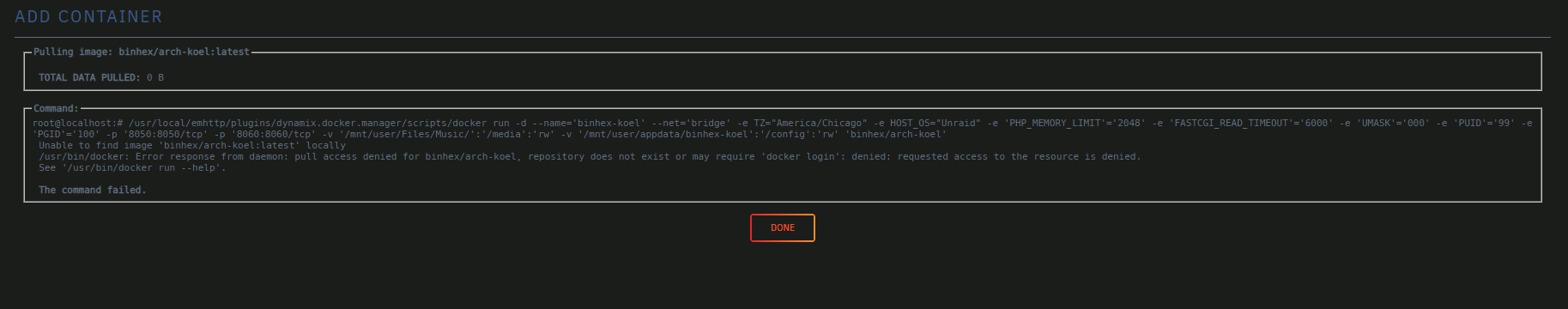

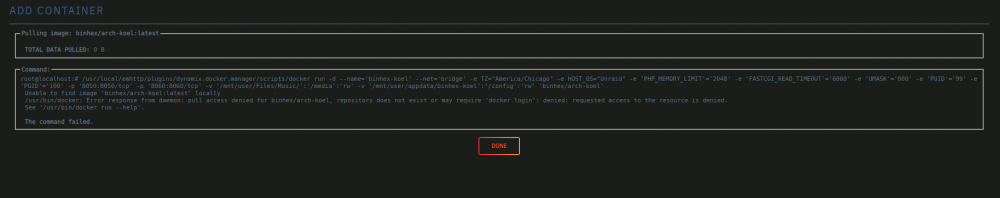

So, is this project dead?
Edited by Keek Uras
forgot to put a question with screencap
sorry guys, i forgot to shut this thread down, sadly i dont have the time to fix the install of this every time there is an update (and yes it breaks every time!), so im bowing out of this app, i shall get the moderators to lock this thread.
