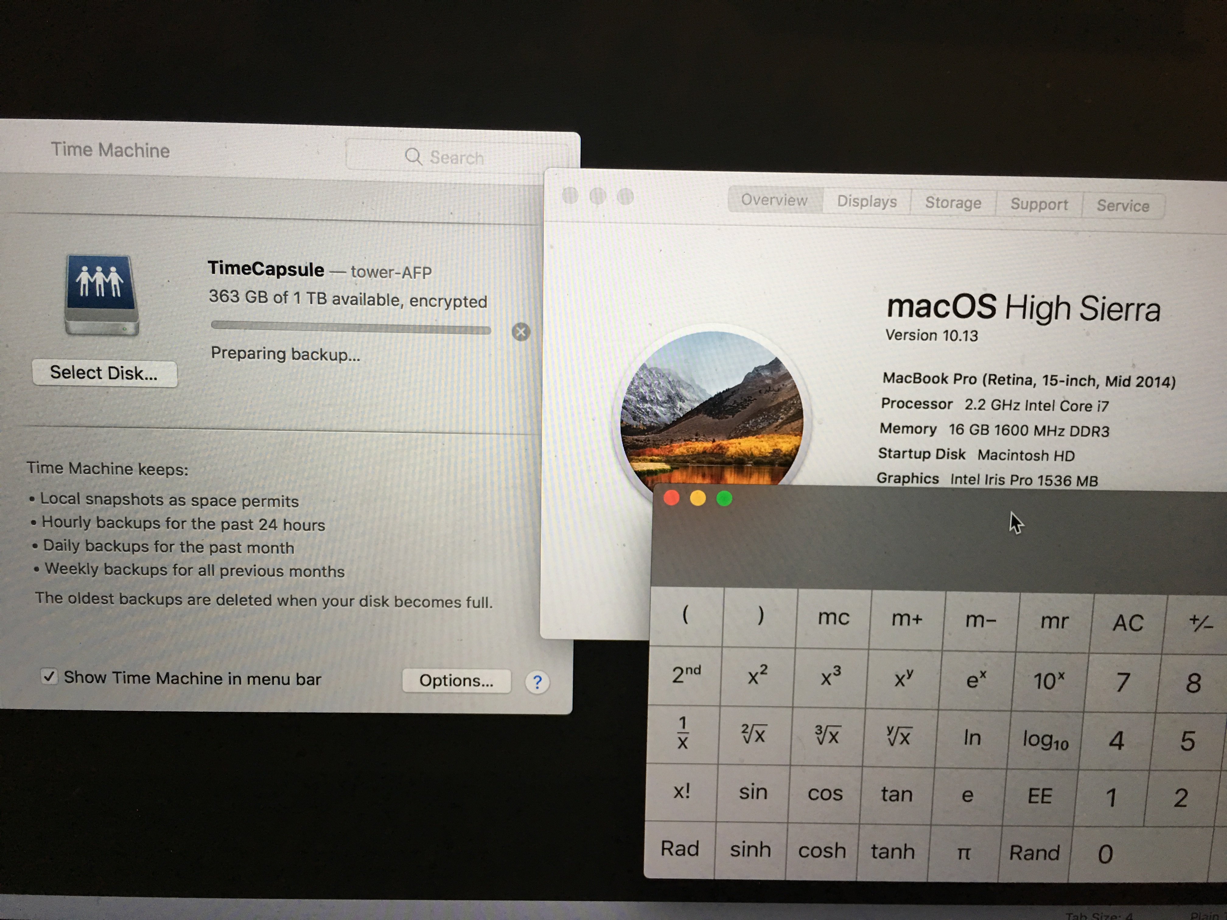

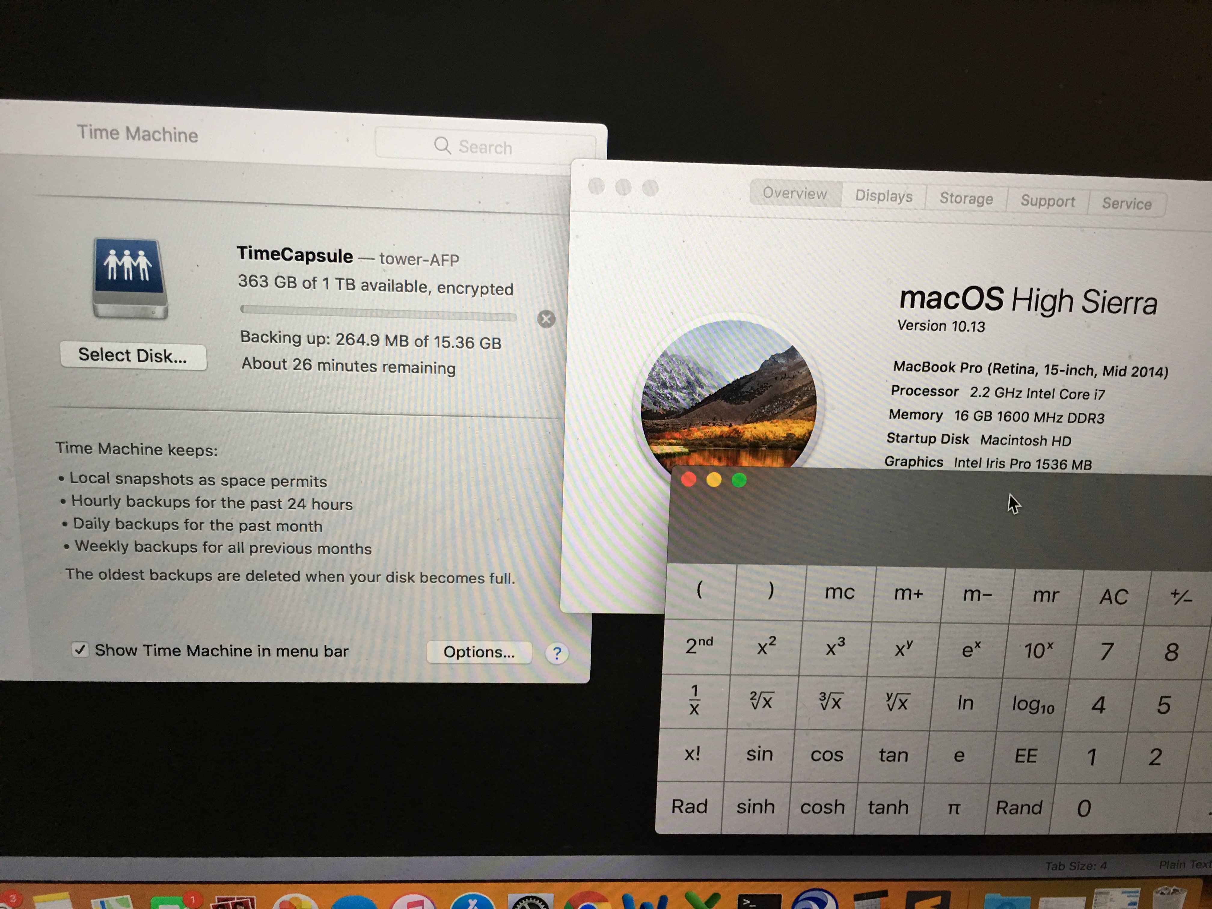

From what I see after upgrading to High Sierra, time machine backups *to* an APFS disk are not possible over AFP.
However, I don't believe this affects backing up an APFS disk to Unraid (or other non-APFS disk).
See here:
https://support.apple.com/en-gb/HT208018
"Volumes formatted as APFS can't offer share points over the network using AFP. "
"Any Time Machine share points must be shared over SMB instead of AFP."
So the limitation isn't the source disk you are backing up, but rather the target disk you are backing up to.
As far as I can tell, there's no issue continuing to use my existing Unraid backup target.
Edited by SnickySnacks
So your saying that this statement from Apple only applies if the source is AFPS and the target is also AFPS?
I'm not sure. People online say that APFS target time machine disks will be converted to HFS because APFS can't be a Time Machine target.
I did a quick test this morning and it seemed to work APFS -> Unraid but I didn't let it actually do the backup.
The more I read today, the more worried I became that I was wrong so I took my work laptop back home and tried again.
I can confirm that this *does* work.
I suspect the restriction is backing up TO something running High Sierra requires SMB, but honestly I'm losing interest in verifying this. :P
