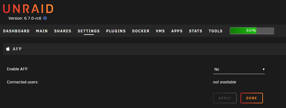

even a freshly installed Mojave macOS on another macbook gets the same error. so I assume I have to search here at unraid for the solution. did exactly what everyone else did. hidden time machine, normal, secured, public, empty directory, deleted share, created a new one

I've had no issues at all but I've used a new share on my unraid server for Time-Machine and completely disabled AFP in unraid beforehand.

- afp is disabled

finally did it. sreknobs tips couldn't help…
so I took all the crap out of my smb extra configurations:
[global]
security = USER
guest account = nobody
public = yes
guest ok = yes
map to guest = bad user
kernel oplocks = no
oplocks  = no
level2 oplocks = no
#unassigned_devices_start
#Unassigned devices share includes
   include = /tmp/unassigned.devices/smb-settings.conf
#unassigned_devices_end
and emptied it. voila! it's working. can anyone tell me what was important in that config?
i reinserted it and commented everything out besides the low include command for unassigned shares. so its still working. something in the global part f'ckd something up

Thanks for pointing me to the SMB Extras section. While that wasn't the issue (I don't use any SMB Extras parameters) it did alert me to the separate SMB settings page, where I saw the "Enhanced macOS interoperability" setting. I had this set to No because I've primarily used this unRAID server for Windows clients, but I stopped the server and enabled it and then started the server back up (no reboot needed).
Immediately after enabling Enhanced macOS interoperability, I saw two new SMB Export dropdown options, Yes/TimeMachine and Yes/TimeMachine (hidden). I enabled that, set the 2.5TB volume size limit I had on my old AFP share, and then mounted the share on my Mac. Upon opening the TimeMachine Select Disk settings, I now see it listed.
Great! So if anyone else is struggling, make sure the SMB global setting on the Settings page for "Enhanced macOS interoperability" is set to "YES" and that the SMB "Export" option for the share you want to use is set to "Yes/TimeMachine." I personally set the security to Private just so I have a clear user/password to log in. The option won't show up (I didn't even know it existed) until the global SMB setting is turned on. The only requirement here is to have the array in a stopped state while you change the global setting.
