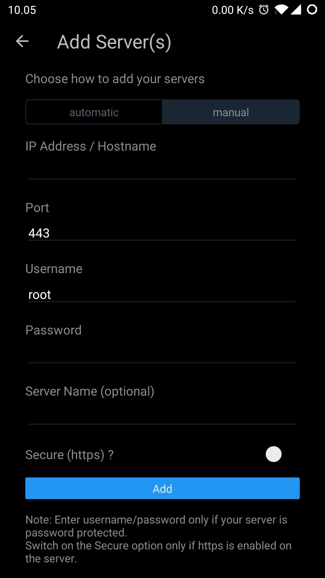

I am not guessing or making assumptions, I am looking at what the app is offering, and it got a field for username and password. But no matter what you put into the username field, it still use root. All I need, is to use the field, with the username I put into it. This would give the app permission to access unraid, just as if it was on my local network.
Just as a check - does that actually work on the local network?   If to then there is some sort of networking issue that needs to be resolved.
If not then it could be a bug in the ContoilR app that ignores the user name you supply.   If the latter then I would not see it as I have only ever used 'root' with ControlR.  Since the author of ControlR actually stated
I thought you were referring to the web interface of the plugin, but you're actually referring to the app itself.
It shows root just as a placeholder (currently people logs in with root, in the more general case).
You can change the username, but you still need to use root's password, due to how Unraid is currently set up.

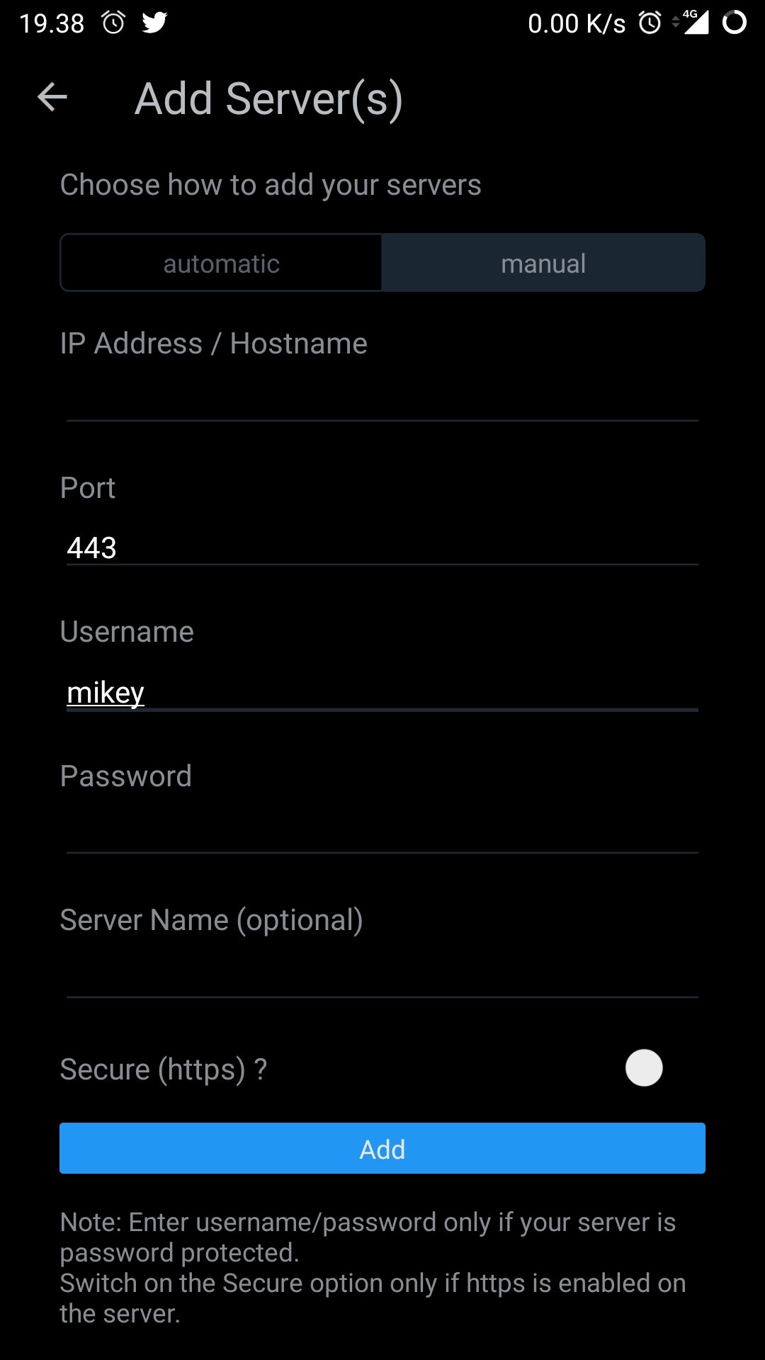

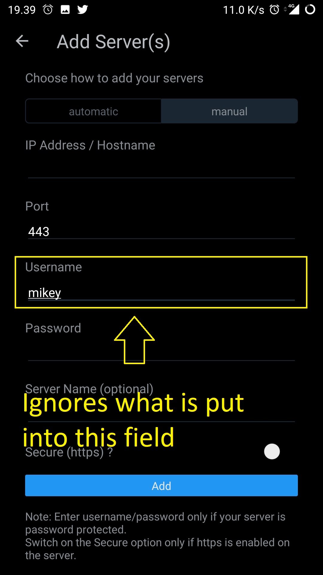

I can edit the field, but no matter what I put into the username field, it will still continue to use root as username.
Here I have put "mikey" in as username, which is then the username I expect it to try. But when I look in the log on the server, I see it trying to log in as "root", while the field is saying "mikey".

I am not talking about unraid at all. The problem is the android app, where it does not use the username put into the username field. I don't need the app to log into unraid directly, nginx is taking care of that. I do not need the app to log in as root, nginx is taking care of that. I need the android app to use the username that is put into the username field. The problem is not connecting directly to unraid, the problem is the username field not having any effect on what username the app is trying to l og in with.

Then why does it have a username field, when it isn't using it? All it need to support what I am doing, is to actually use what is put into the username field.
Also PLEASE read it all. As I wrote "I don't need the app to log into unraid directly, nginx is taking care of that.". As I have tried to explain a few times now. nginx is logging into unraid with the root user, but I am not logging in with root to nginx. No matter what username I decide to create for nginx, unraid will still see root as the user logged in.
I dont know how to explain this more clear.
All I need, is the username field in the app to actually be used.
I have tested it by creating a root user that could log into nginx, and the app worked perfectly. So what I am doing will work, if the app is using the username entered into the username field in the app.
When I change the username in the username field, I can see in the log it is still using "root" as username, instead of what is in the field. I just need the field to actually be used as the username to log in with.
