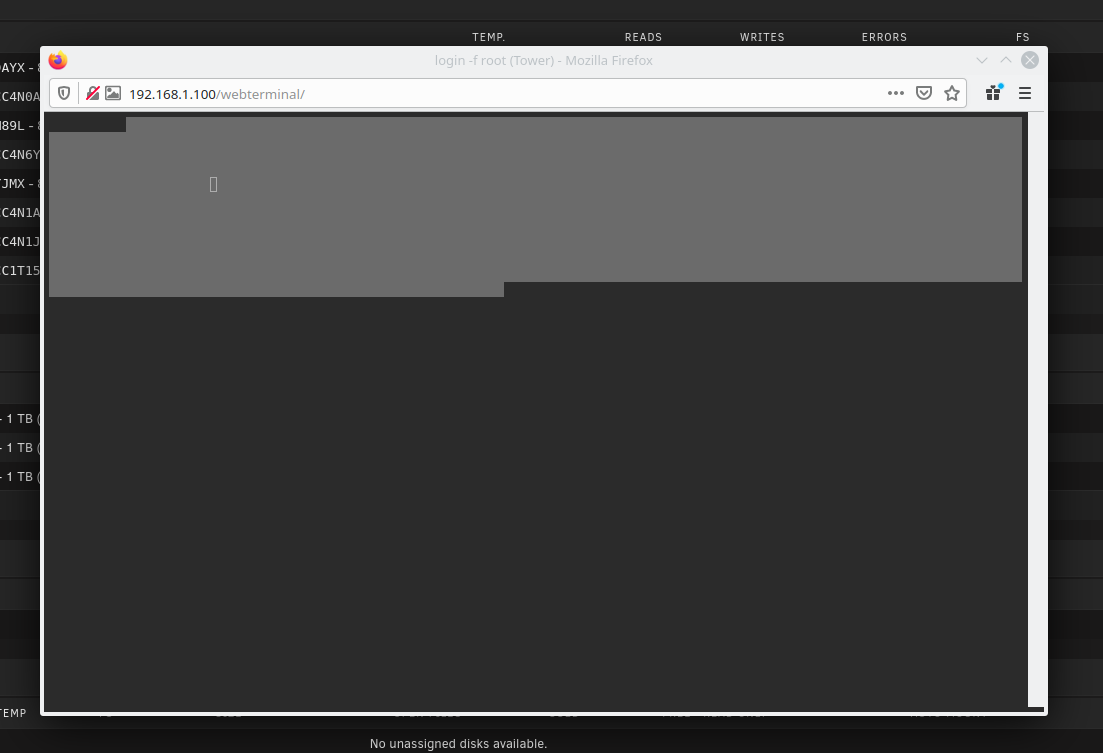

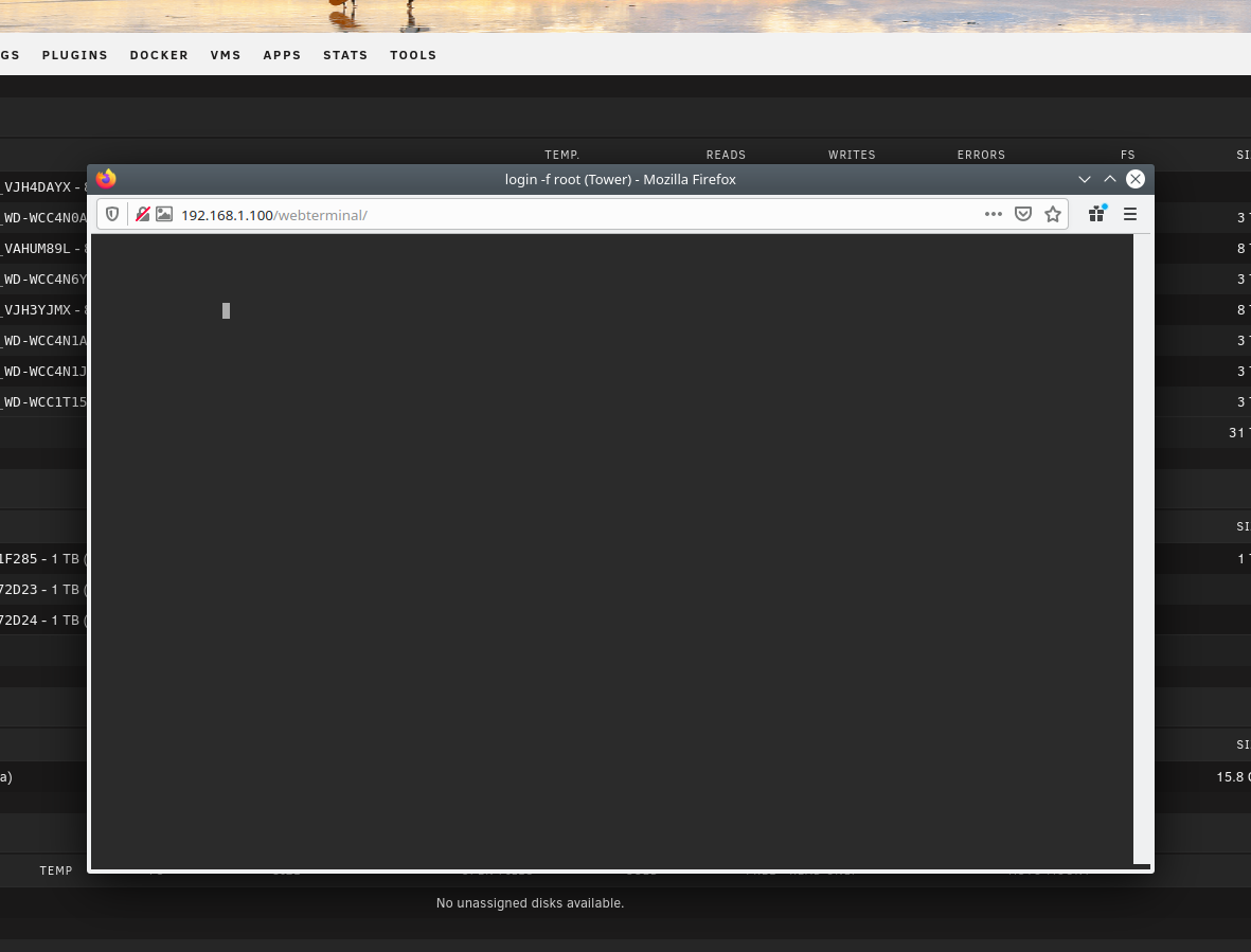

Thanks for your reply. mmm..something wrong there. when i open a terminal from the menu bar i cant see anything typed.. i have attached a screen capture of the terminal window. i thought it was a theme issue but i have tried various themes and the text is still not visible. the cursor moves as i type but there is no text visible. if i highlight the text its still not visible.
Edited by darrenyorston
added new image
