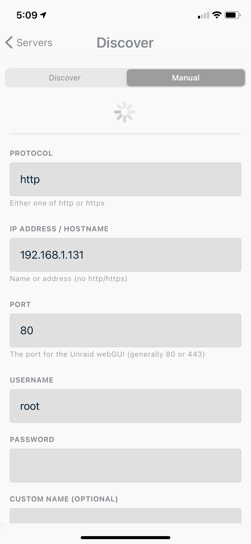

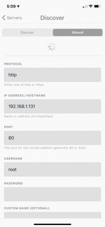

Am having an issue on 6.10.0 rc1
Wouldn't connect on login, so I deleted. Now I’m setting up again and it just sits there with wheels spinning
Edited by MCT
Have exact the same problem... any ideas?

So Discover doesn't bring up any server ?
I don't support RCs because they may have changes before hitting stable.
I haven't installed the 6.10.x RC myself. I'll try that if time permits.
Discover does find the server, it just doesn’t login. Doesn’t come up with an error like it does if ports or passwords are incorrect, just the circle spinning forever.
Rolling back and all is ok
