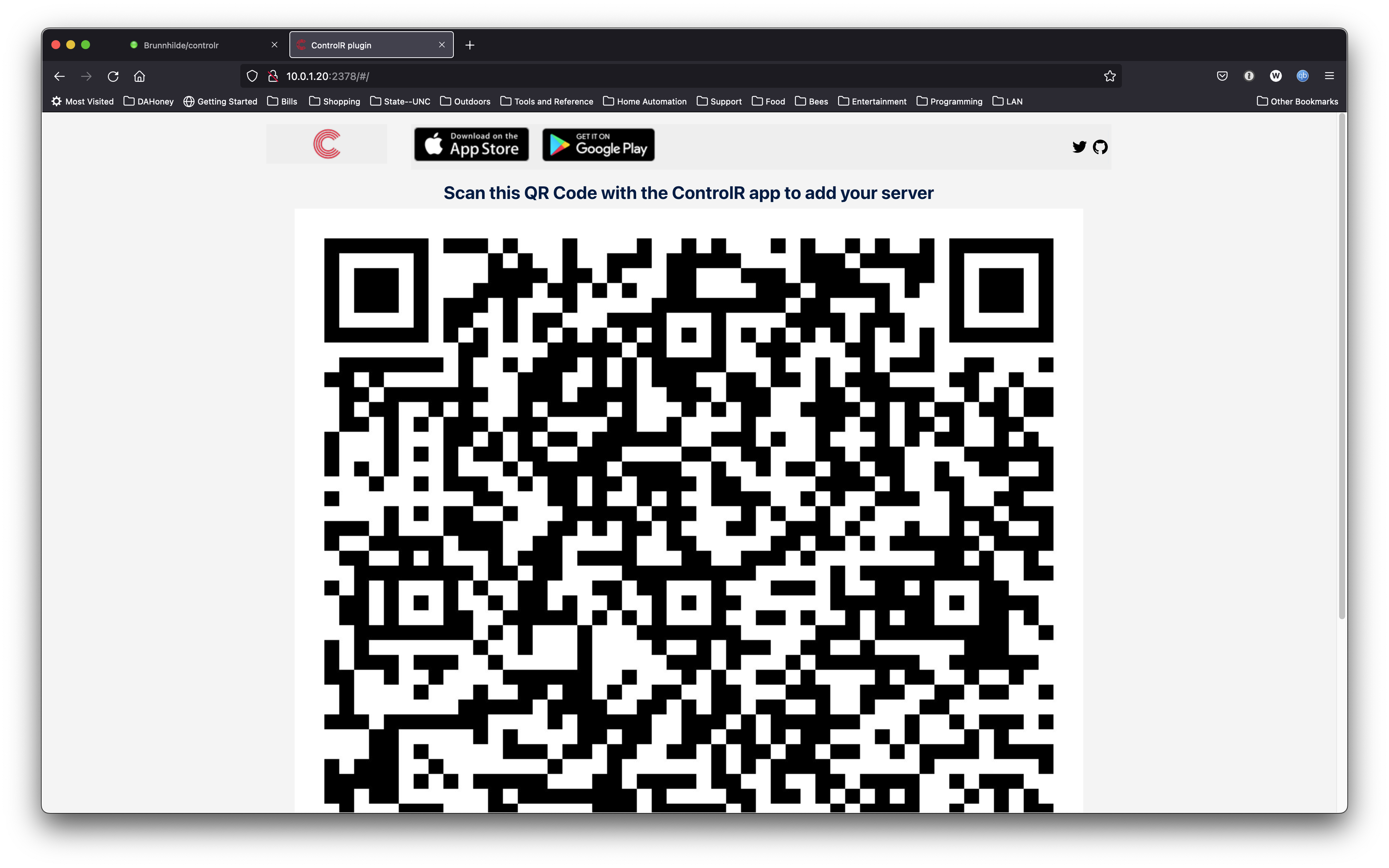

Where do I go to get a QR code to attempt to connect via QR code in the app? I seem to recall having seen a QR code somewhere in the WebGUI, but can't find it now, is that the one I need?
go to plugins, then click on the ControlR plugin, should open the plugin page with the qrcode
No QR code:

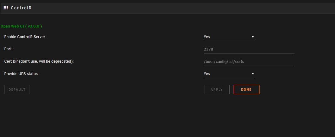

you need to click on the `Open Web UI (v3.0.0) green link to get to the plugin page, since it's not a php plugin, the ui presentation is different

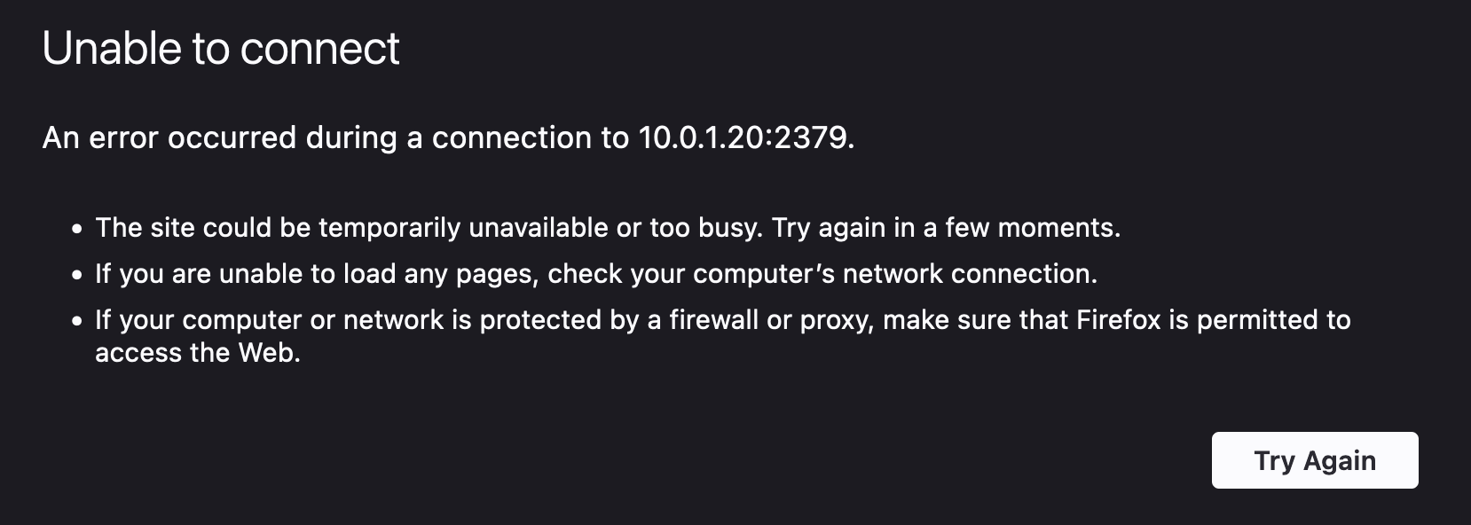

The settings defined port is 2378, but the green link takes me to 2379. Don't know if that's the issue...
8 minutes ago, FreeMan said:
Same here.
After a quick test, yes, this is the issue.

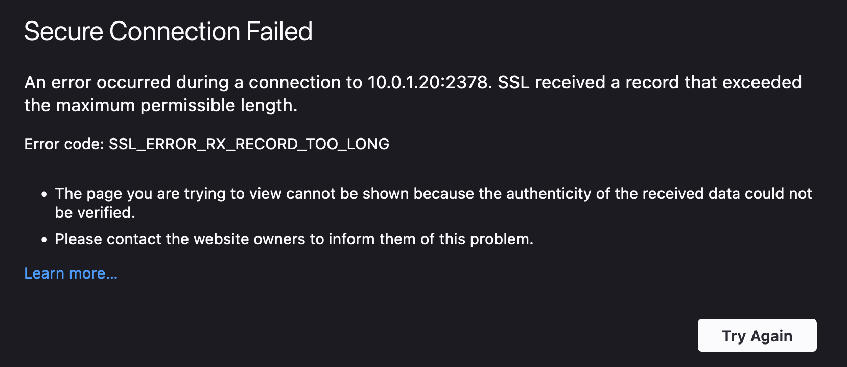

By default, the link takes me to https://nas.local:2379
I edited that to https://nas.local:2378 and got:
Secure Connection Failed
An error occurred during a connection to nas.local:2378. SSL received a record that exceeded the maximum permissible length.
Error code: SSL_ERROR_RX_RECORD_TOO_LONG
I changed that to http://nas.local:2378 and got a Firefox warning about there not being an HTTPS site available. After telling it to continue to the "unsafe" HTTP site, I got a QR code that is so large, it barely fits on my 24" 1920x1080 monitor. Might be helpful to scale the QR code down a bit. ;)

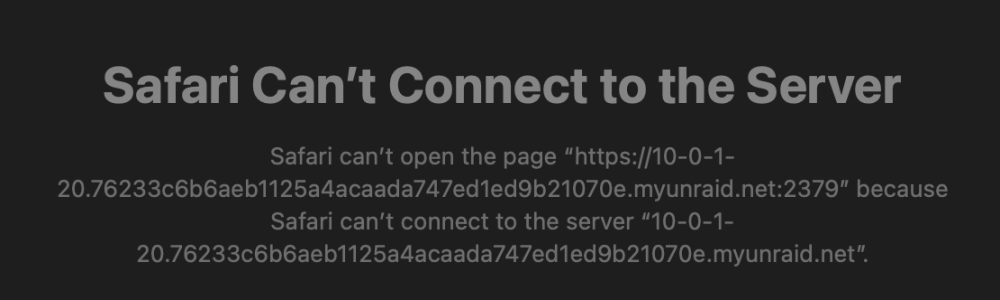

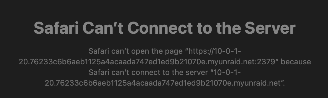

That link doesn’t work for me. I get “could not connect to server” error when trying to open the link from my local network.
Here is the full error that I get in Safari regardless wether I use port 2378 or 2379-
552800709_Screenshot2022-12-29at9_09_10AM.thumb.png.04eb97cf9f7cd4f962aaa7b0d12e9556.png
If I repeat the test that @FreeMan used I get the same results he did.
Using port 2379 in Firefox-

Using port 2378 in Firefox-

ControlR Plugin v2022.12.30 (v4.0.0) is out !
- Show qrcode on plugin page
- Remove ui so we don't need to bundle it anymore
i decided to just show the qrcode on the plugin unraid page (refresh the page if the qrcode is cut off)
@FreeMan @wgstarks this should fix the issues you were having, thanks for reporting them !

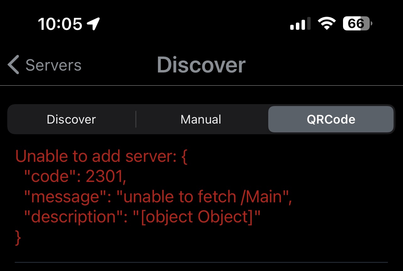

For me just bought the app and I'm not able to connect to my servers.. having the same error.
App Version : 5.2.1
ControlR v4.0.0
IOS 16.3.1
App Version : 5.2.1
ControlR v4.0.0
IOS 16.3.1
hi, can you try to add it manually ? please make sure to validate whether you have ssl setting on or off

mmm that's odd, i can connect to my main server (Unraid 6.11.5) and a test server (Unraid 6.12.x)
what Unraid version are you running ?
is the error the same as above "Unable to fetch /Main" ?
