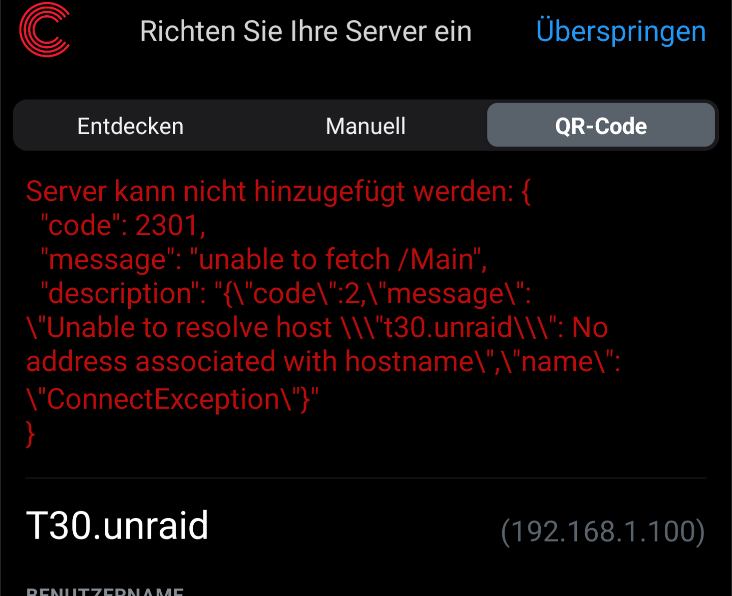

Hey, just updated the plugin, as I saw I was still on the 2022 version :)
So uninstalled the old one, took the new one and ended up with this error: (see image attached)
Is there anything i oversaw?
Regards

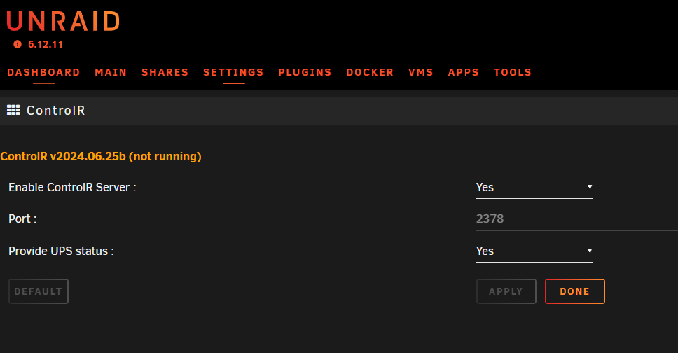

The Plugin does not run when enabled. Any help would be appreciated. Purchased the app on Google Play Store and was wondering if I am missing something if this plugin does not run?
Edit: I also don't see any logs in the app on phone. version 6.5.0 on android 14
TIA
Edited by Unraid-arr
inline
from your screenshot, can you change Enable ControlR Server to No -> apply > Enable ControlR Server to Yes -> apply ?
does that make a difference ?
