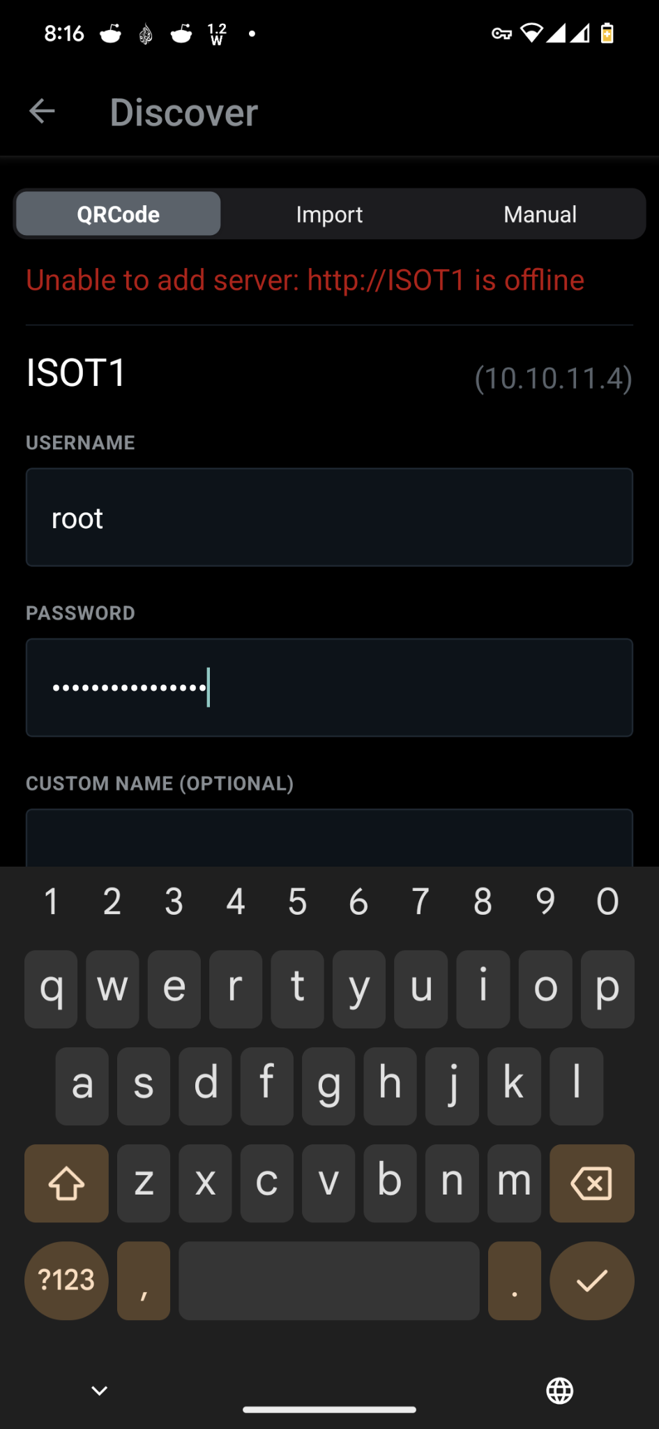

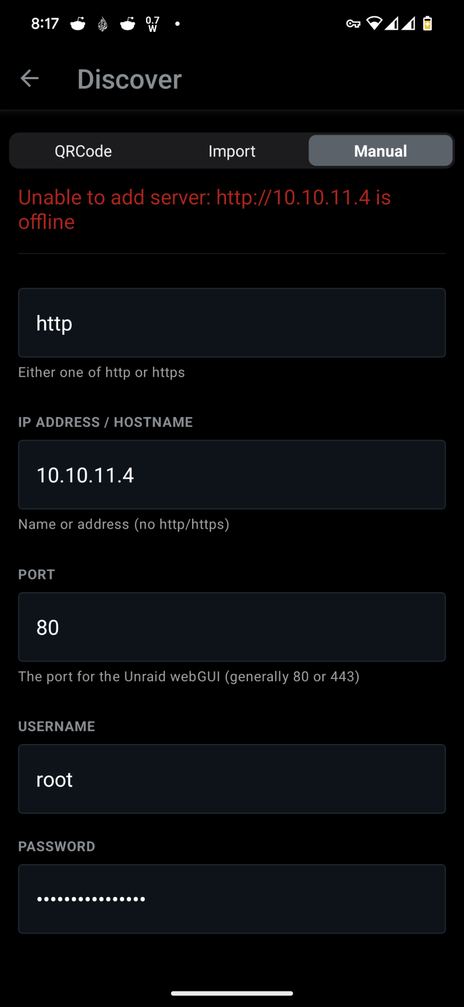

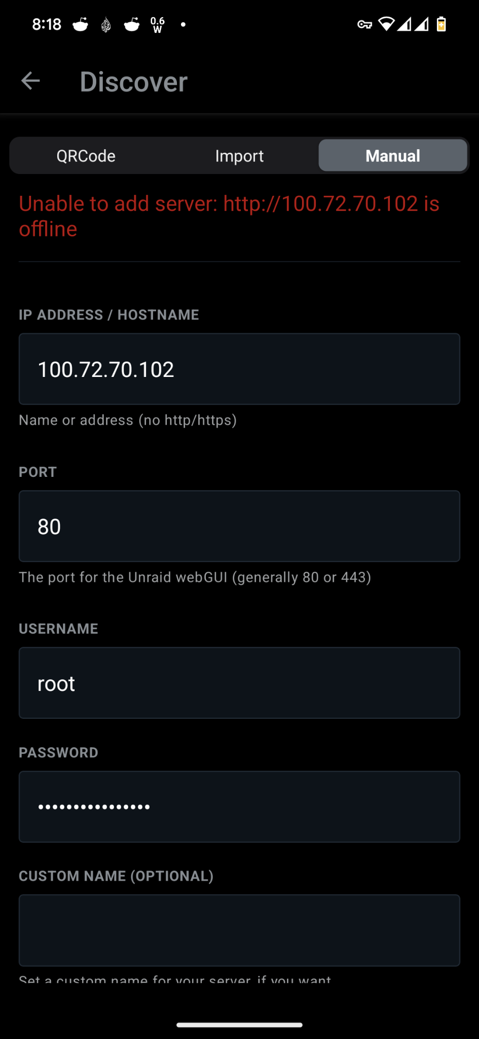

When i use http connection, the app will not connect to gui's using Tailscale IPs or LAN IPs using tailscale subnet route.  Only local LAN IPs work.  It used to work so what changed and how do I fix it?

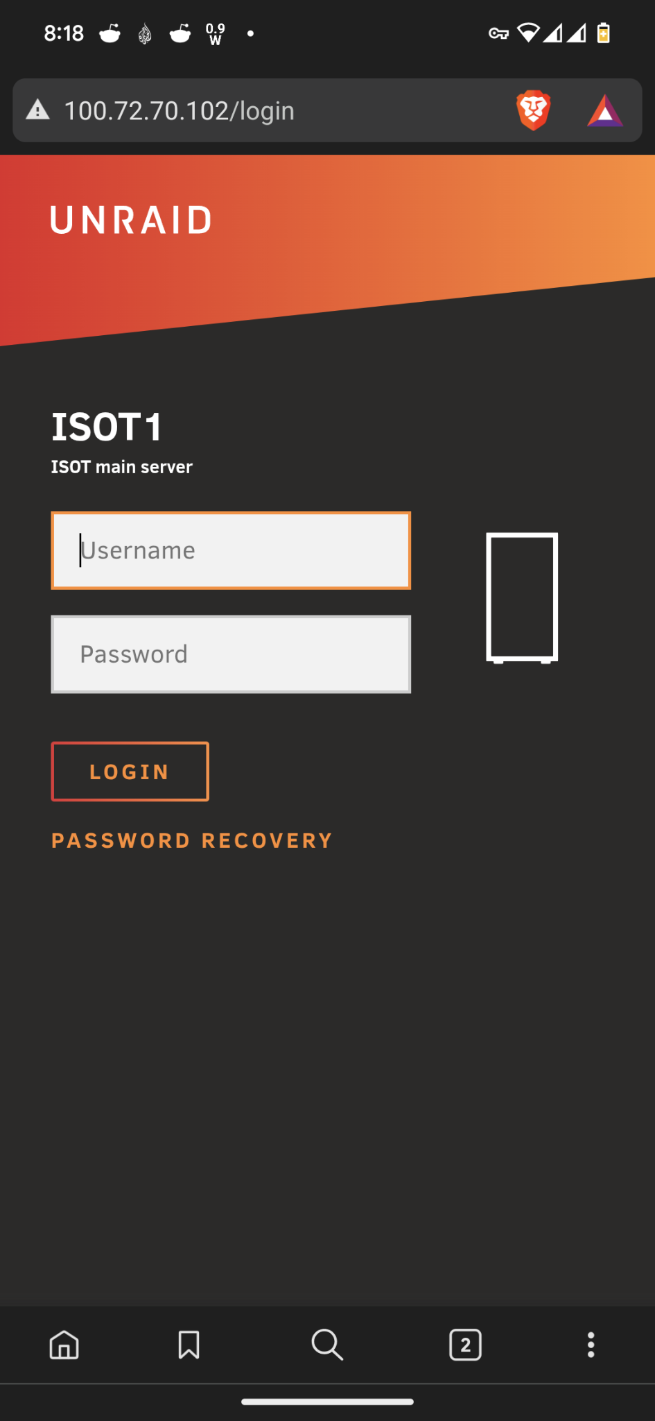

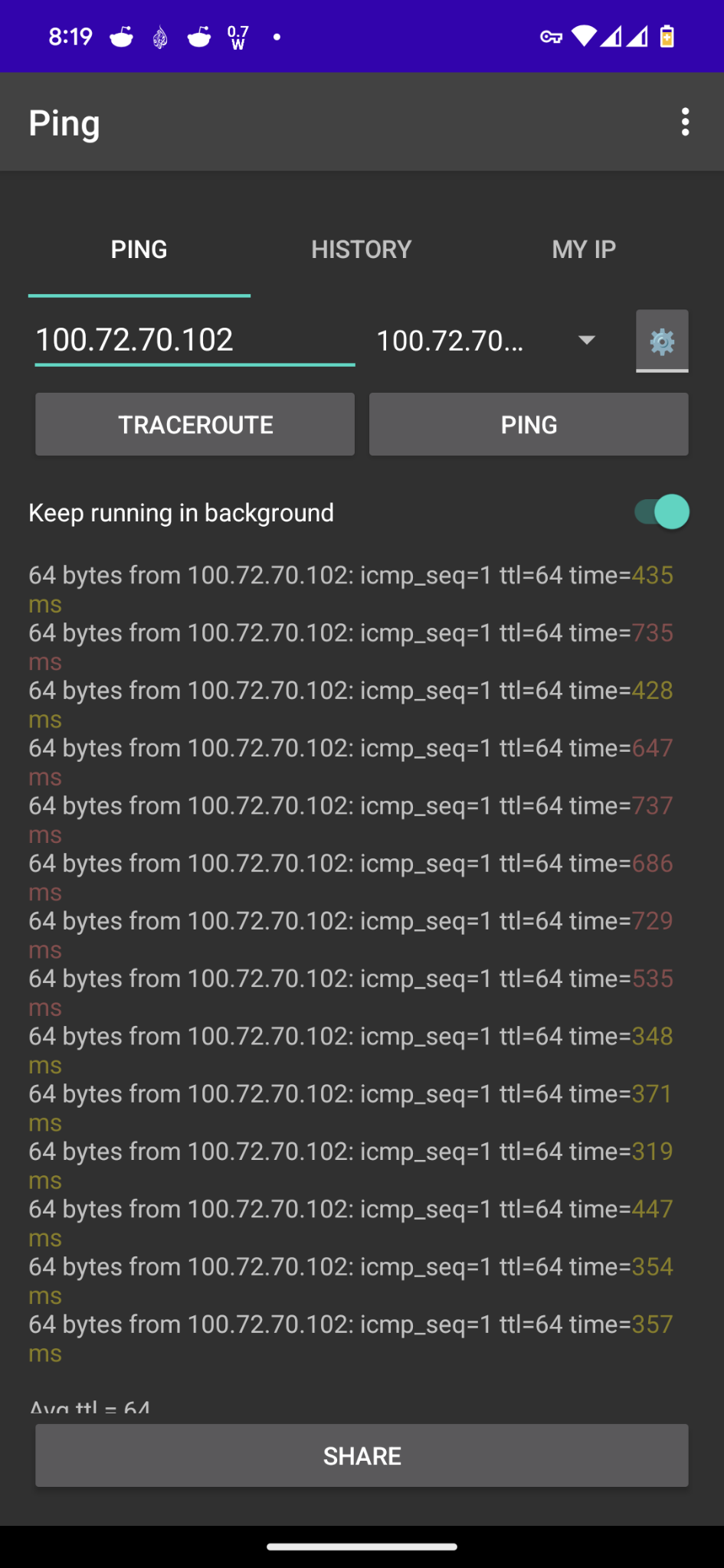

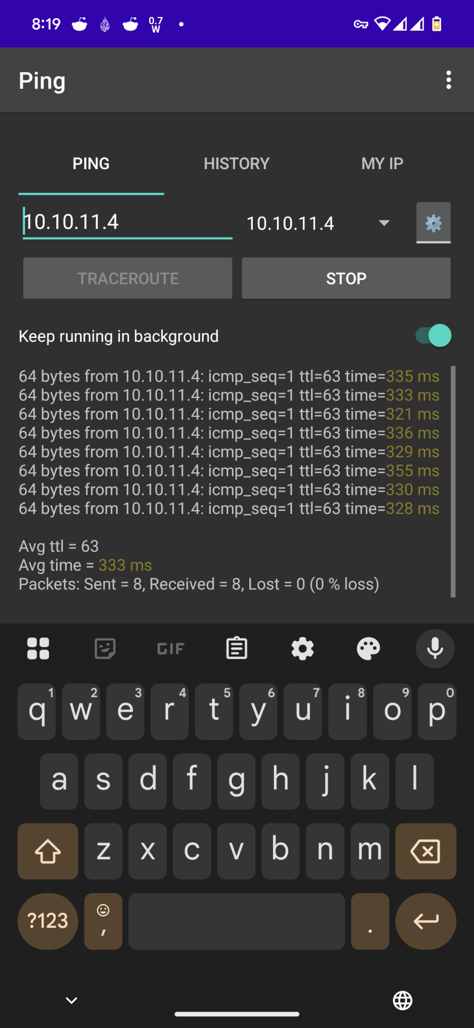

I'm not sure when exactly.  I installed the app about 6 months ago if I can remember correctly, and it did work with remote LAN IPs at that time.  Then I kinda forgot about it until a few weeks ago and it doesn't work now.  Do you think its due to the ping time of 300+ ms?  I tried both QR code and manual, and manual both LAN IP and tailscale IP.

As previously stated, http does work for LAN IPs, so it has to be a latency thing.

Ok, but the problem is that I can use the app via a LAN IP with latency of 1ms, but I cannot use the app via a LAN IP with latency of average 333ms.  So there is some issue with how quickly the app decides that a host is offline when using http
