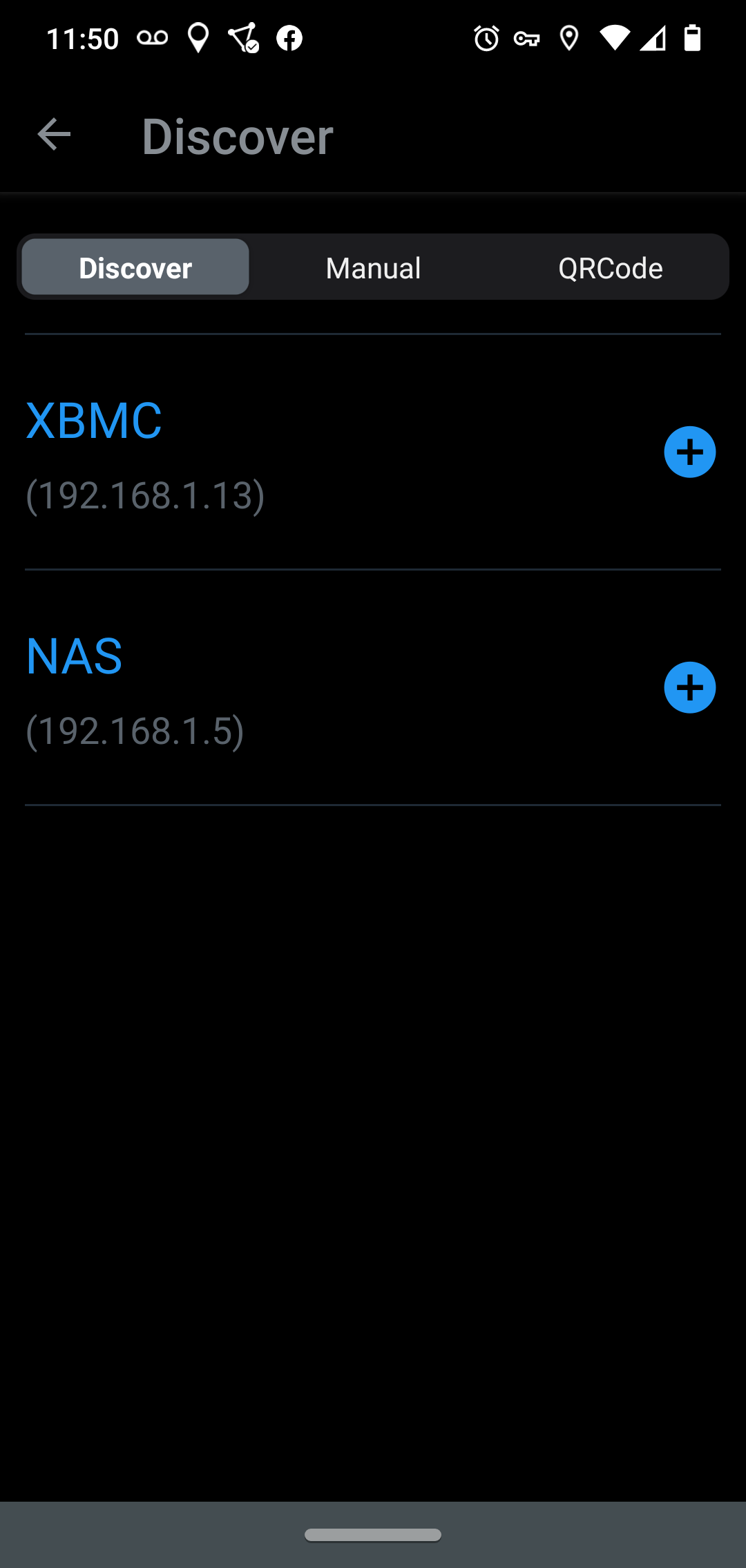

20 minutes ago, FreeMan said:
I presume deleting the server is by pressing the circled red x in the corner of the server list. There is no response to that.
The circled red x means the server if offline (at least the app sees it that way).
To delete the server, swipe it left, it will display a red delete button to the right

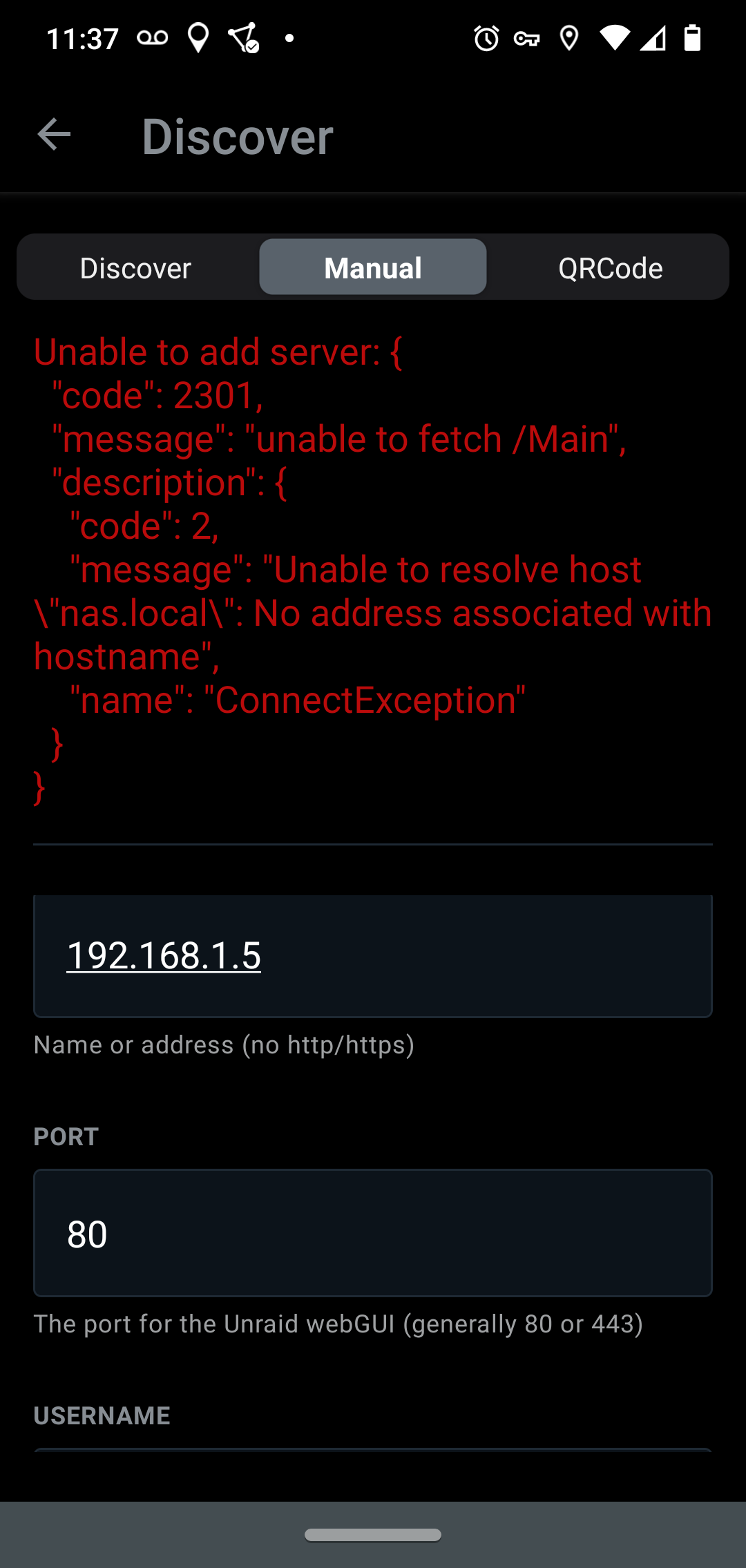

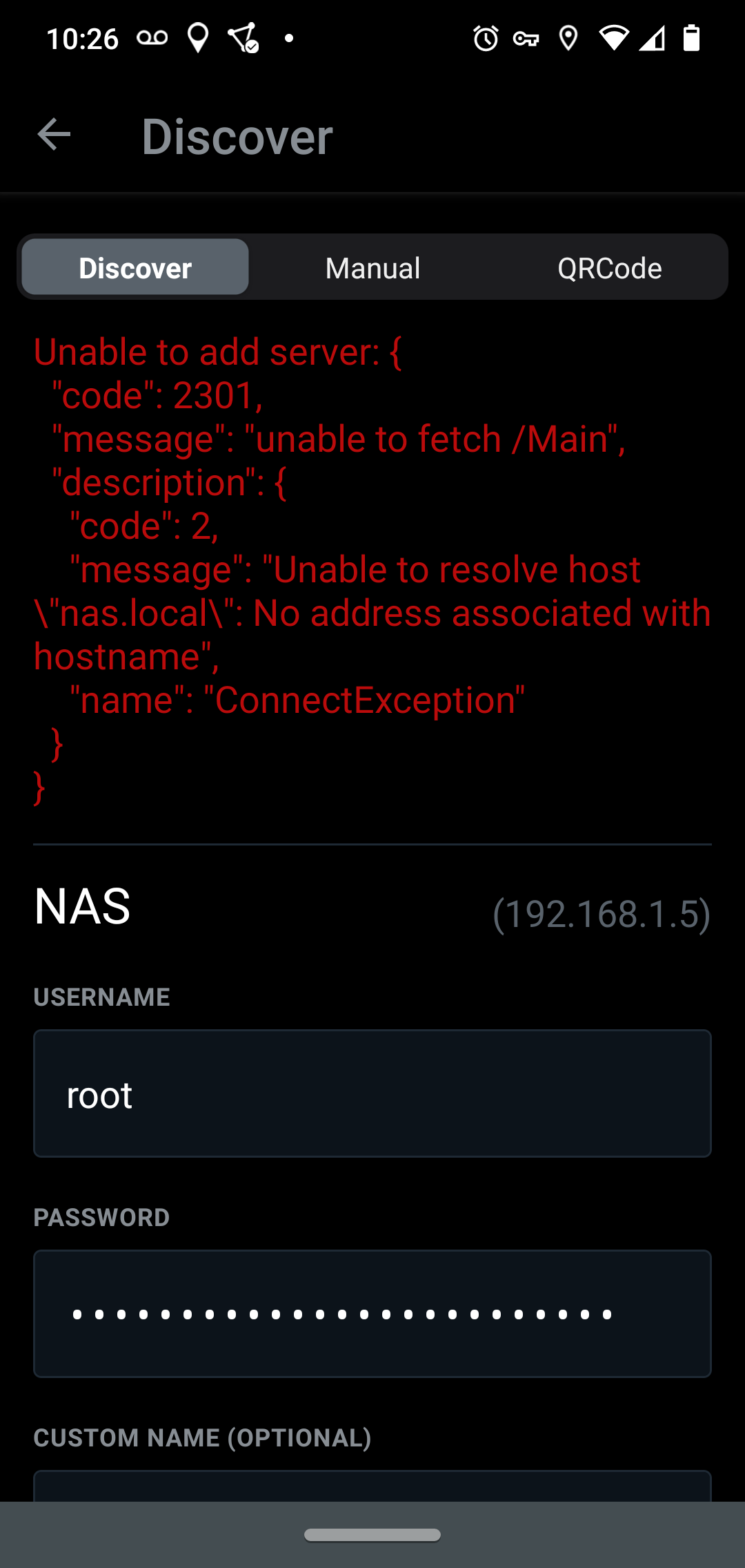

I deleted the server. Upon adding it back in (using auto) I got this message:
However, nas.local resolves just fine in my browser:
Gets me to the ControlR config page w/o issue

hmmm... bizarre. The address bar pic is from my desktop machine.
My phone cannot resolve nas.local in a browser window, saying "site cannot be reached".
When I try adding the server manually by IP address, I get:
It's attempting to convert the IP to a host address, it seems, then is failing to resolve the host address back to an IP.

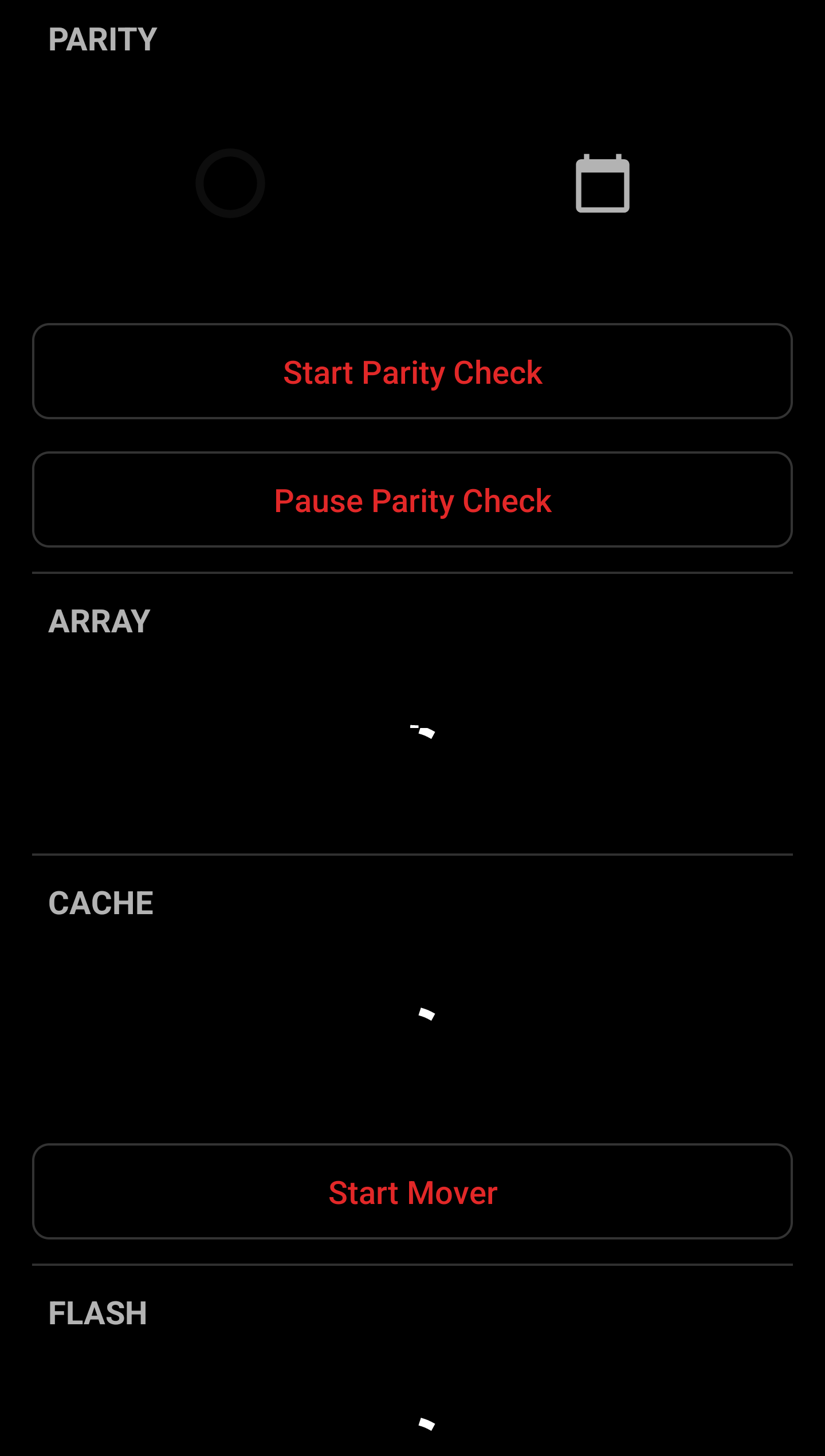

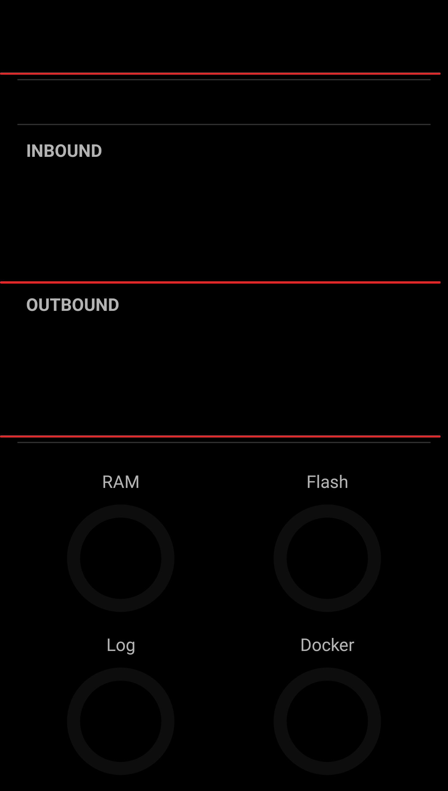

since the last update the first 2 icons on the bottom stopped working.  i have uninstalled and reinstalled, but get the same, the shares, dockers, vms and system info all pull up my server data, any suggestions, SS attached from app.  the parity just has spinning circles, the 2nd one - no data at all, used to be there, also do not see any info in the log file on the server.  Is there a limit on # of drives so it might be failing there?  I have a total of 41 drives in the system, but it was working with that many before.
Thanks
Edited by MyKroFt
Thanks
hi, that doesn't seem to be a screenshot from my app

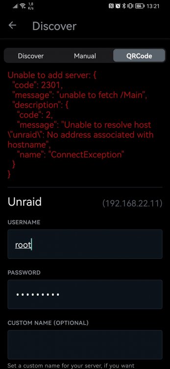

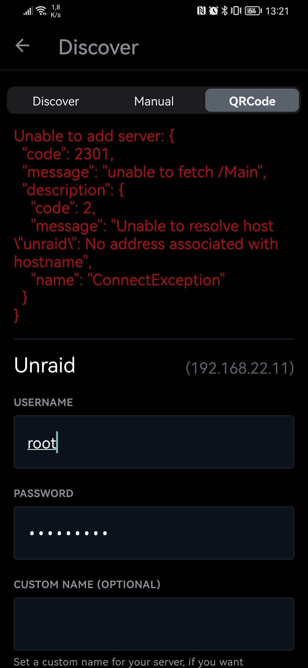

I couldn't add server with qr code. Get this
Screenshot_20220704_132132_io.jbrodriguez.controlr.thumb.jpg.fcbcab82fbe6c80d3c2f3fc434e09766.jpg
With discovery it works, but in webui of plugin nothing changes, still see qr code

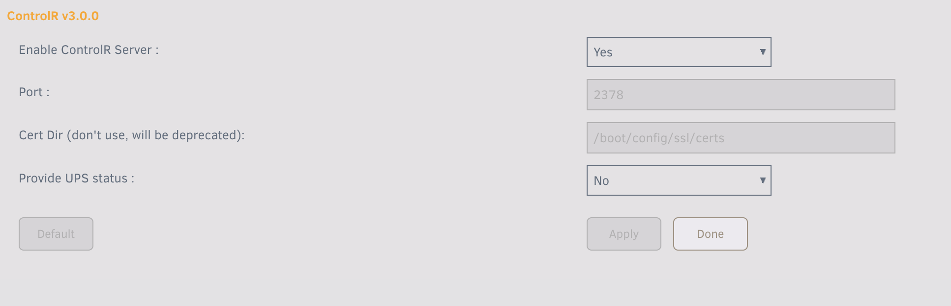

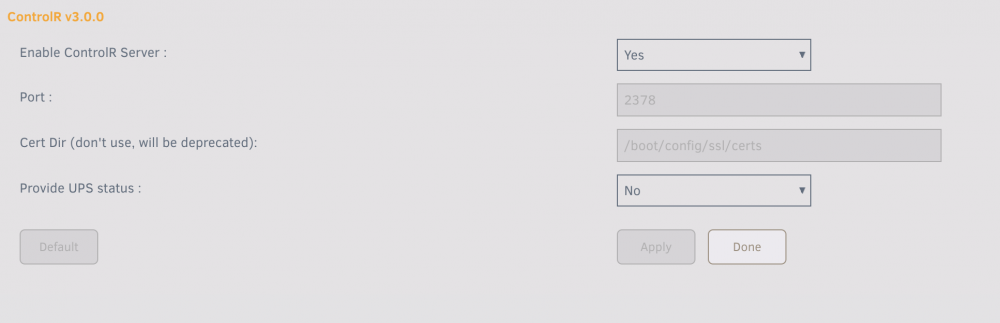

Hi
I'm also experiencing problems. Two of my servers don't work but one server does. I can't add them even though both are found by using automatic search. It just works on it forever (spinning circle). Same result if I use manual mode on both http and https.
Also if I click on the Open Web UI ( v3.0.0 ) link I get ERR_CONNECTION_REFUSED in all browsers on all of my machines.
This is also weird.
Server that is not working:
controlr   8549   root   11u  IPv6    1355      0t0  TCP *:2378 (LISTEN)
controlr   8549   root   12u  IPv6   30575      0t0  TCP *:2382 (LISTEN)
Server that is working:
controlr  13117    root   11u  IPv6    34868      0t0  TCP *:2378 (LISTEN)
controlr  13117    root   12u  IPv6    30249      0t0  TCP *:2382 (LISTEN)
controlr  13117    root   13u  IPv6    22407      0t0  TCP *:2379 (LISTEN)
It seems that port 2379 (web interface) is never created.
Any insights?
